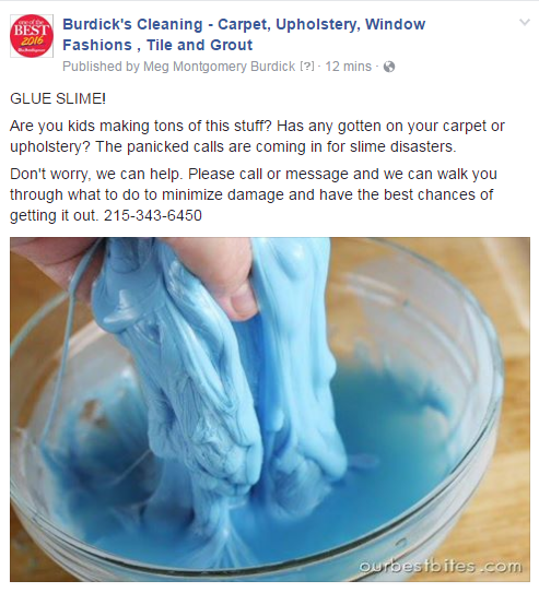

    My kids mix up a batch of this stuff every day. We have tupperware containers full of it. They know to do in Kitchen only on the counters so if it gets on floors we can clean it up.
    There are a ton of "recipes" to make it. Everyday my daughter is trying a new way that she learned from YouTube videos. They are adding food coloring. The base is always the glue, but she also uses Borax, laundry detergent, lotions, contact solution and shaving cream. She mixes in things like glitter, beads cut up plastic straws to get different textures. It's crazy...but at least she's being creative and not watching TV or on the other devices.
    I think this is a great opportunity for some Facebook marketing...since it's all the rage and I'm seeing this come up here and on many Cleaning FB pages. I'll make up a tips and tricks for what homeowners can do till we get there to make it easier and post on our page and the community groups!
