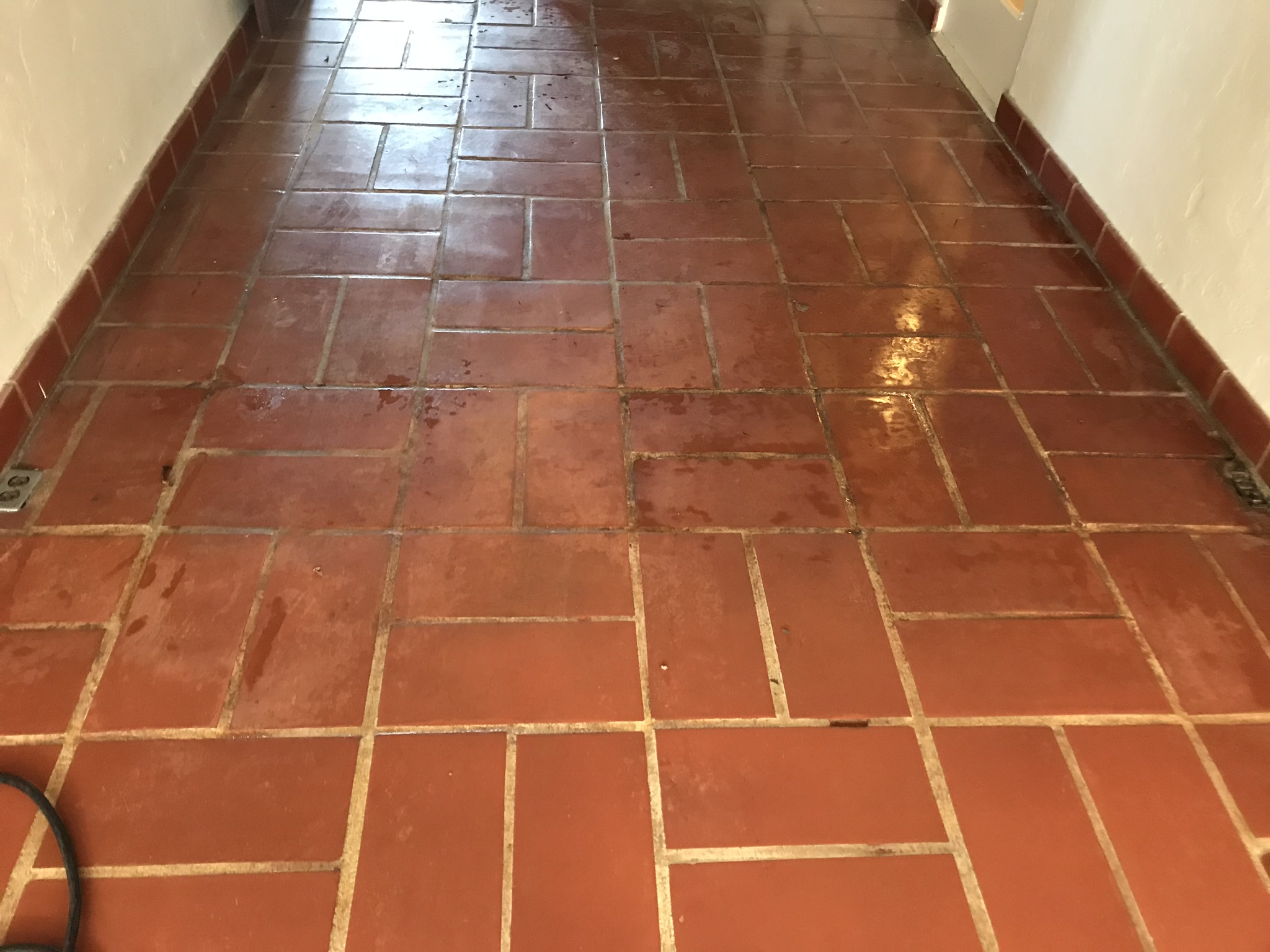

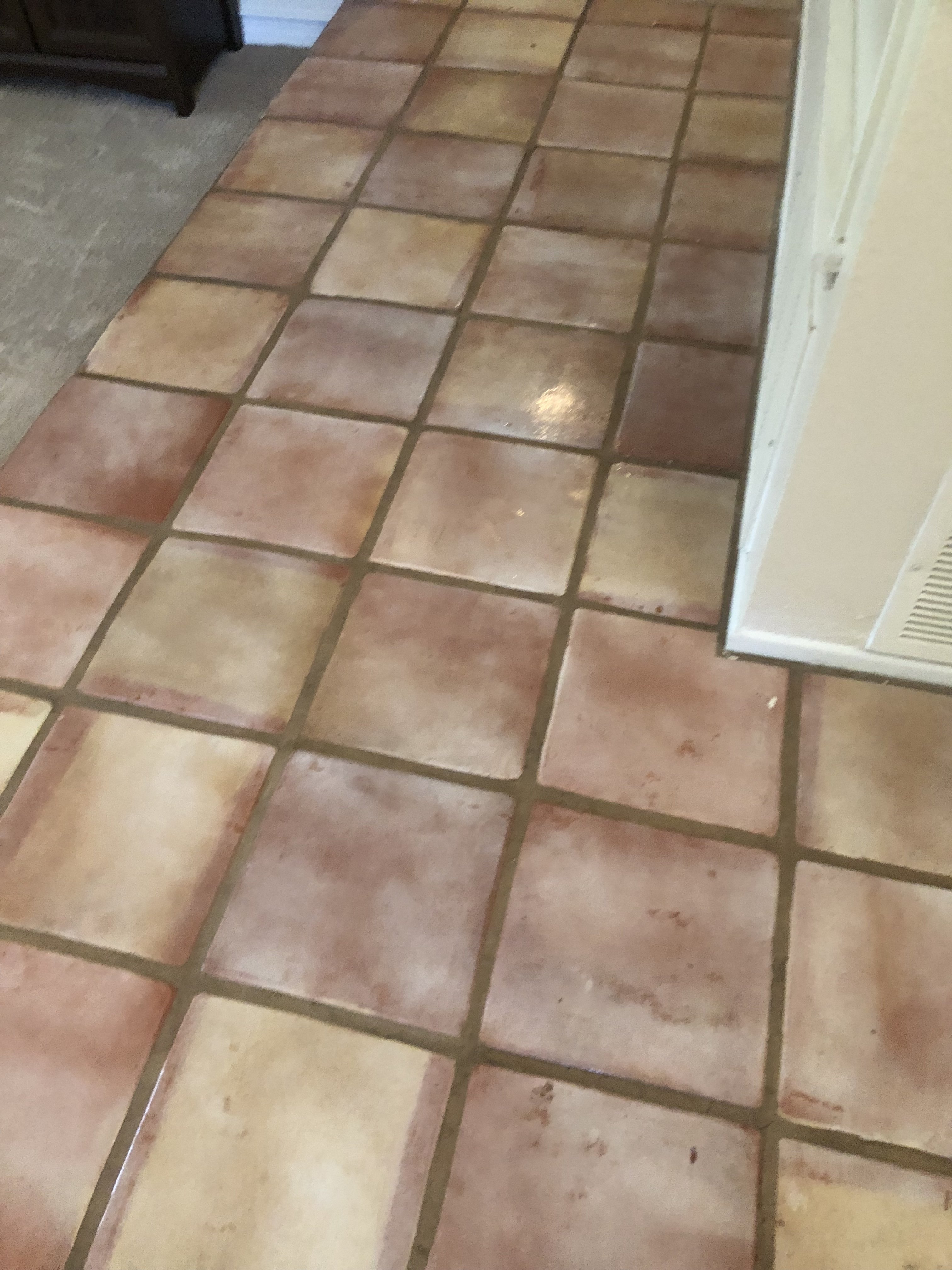

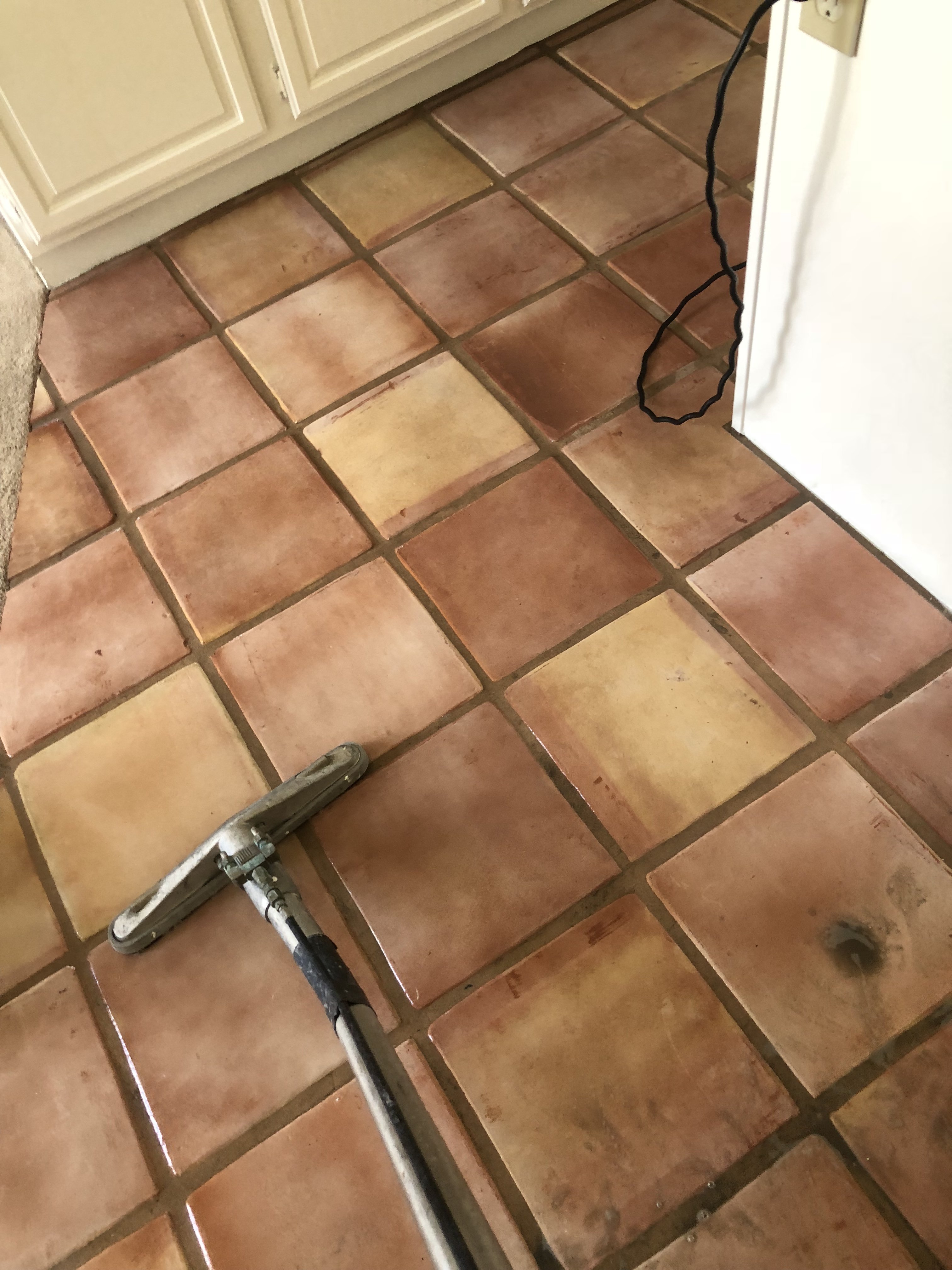

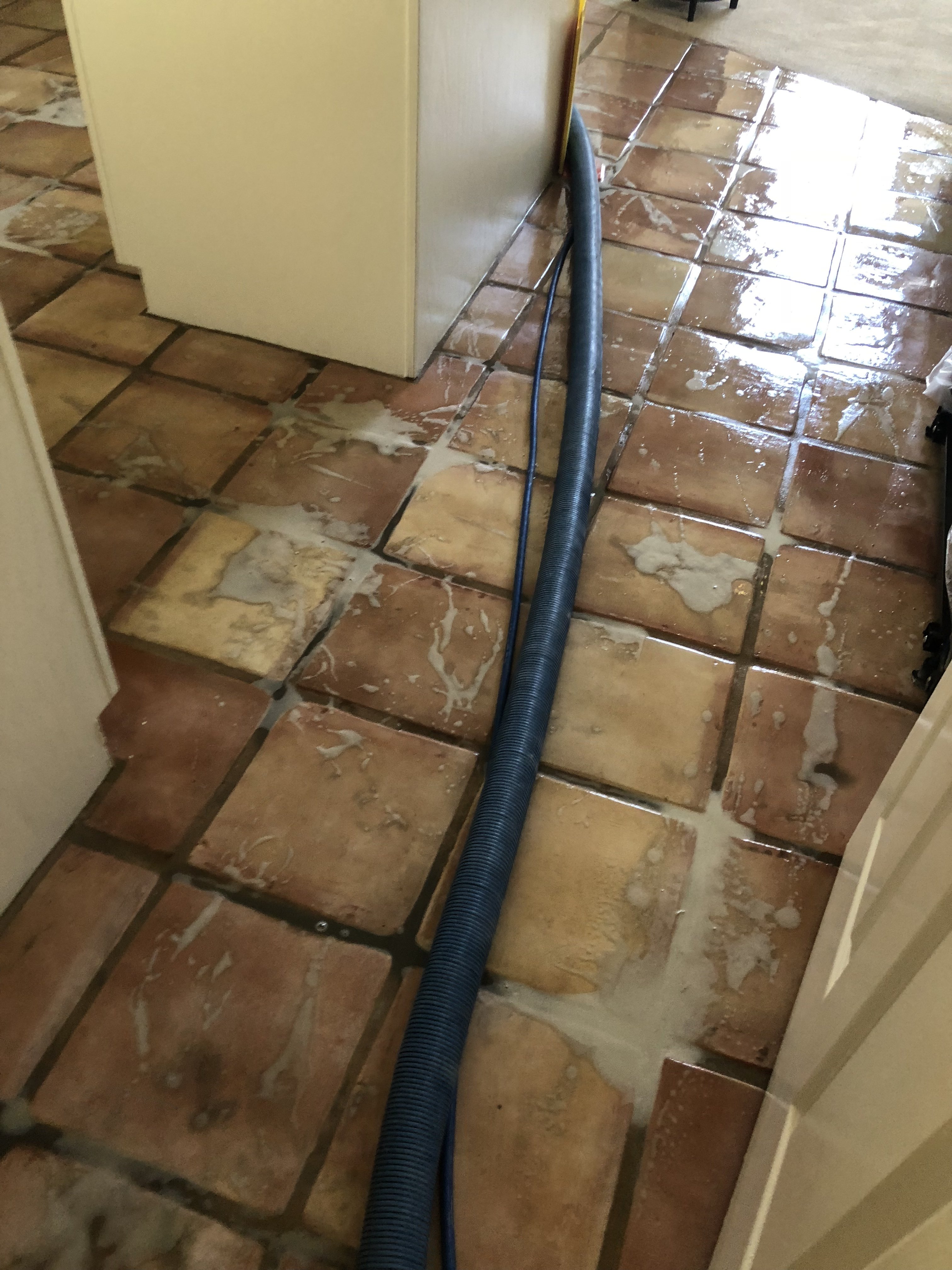

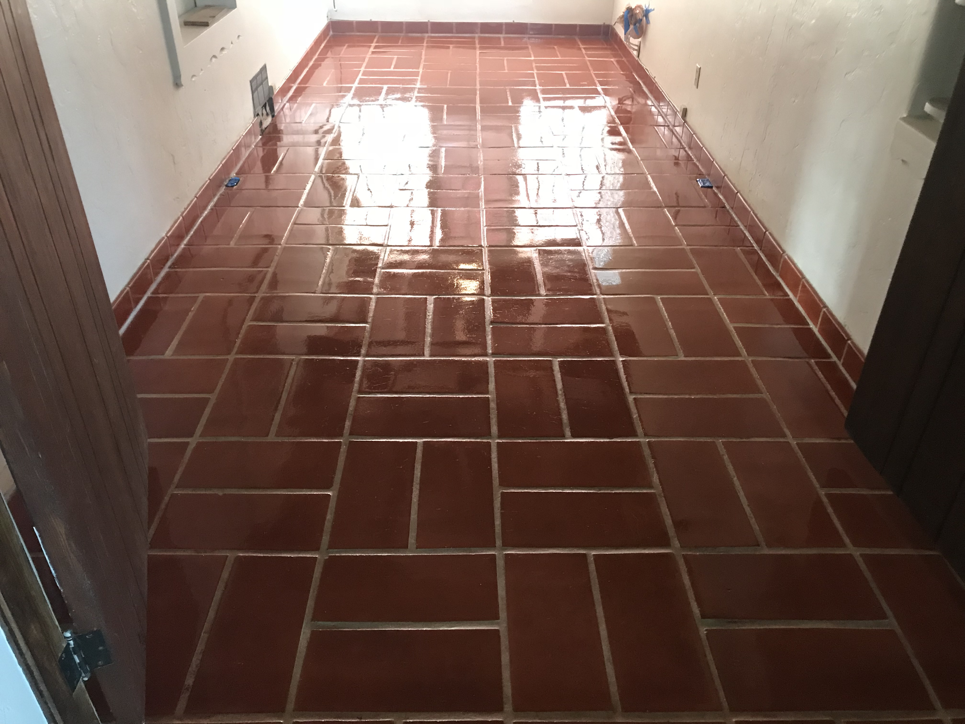

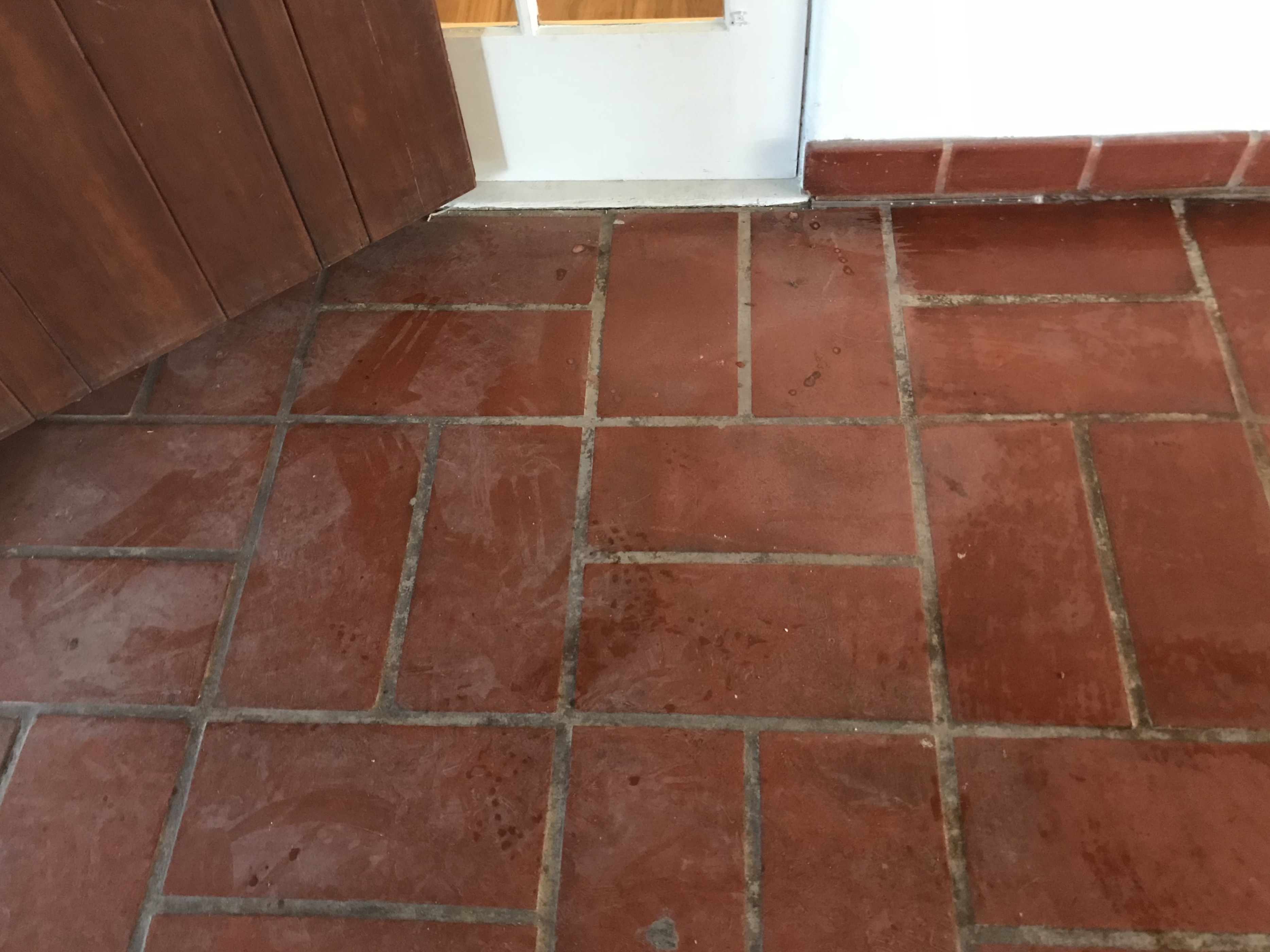

    Terra Cotta clay pavers,
    That had a coating real dirty.
    @Mikey P said hit it with a nuetral cleaner and light scrub, low psi rinse.
    Well I declined it at first, but she called and said please.
    So I hit it with slop and gobble but added last step to lower the ph!
    White brushes crb and 300 psi with a gecko tile wand!
    839D7A29-AB46-4B85-B903-4A90656EFCBD.jpeg 071BE69F-BCBD-412C-B1D1-B315C9557111.jpeg 1ED09294-C330-4C54-9B2E-2523E887888F.jpeg 4385F509-8F78-4F8C-AC61-7989D440B74A.jpeg
    It cleaned up real nice the lady was happy!

    dry for 24 hours and recoat?
  5. SamIam
    Joined:
    Messages:
    7,350
    Location:
    Name:
    No just clean and run dropped fans and it really popped

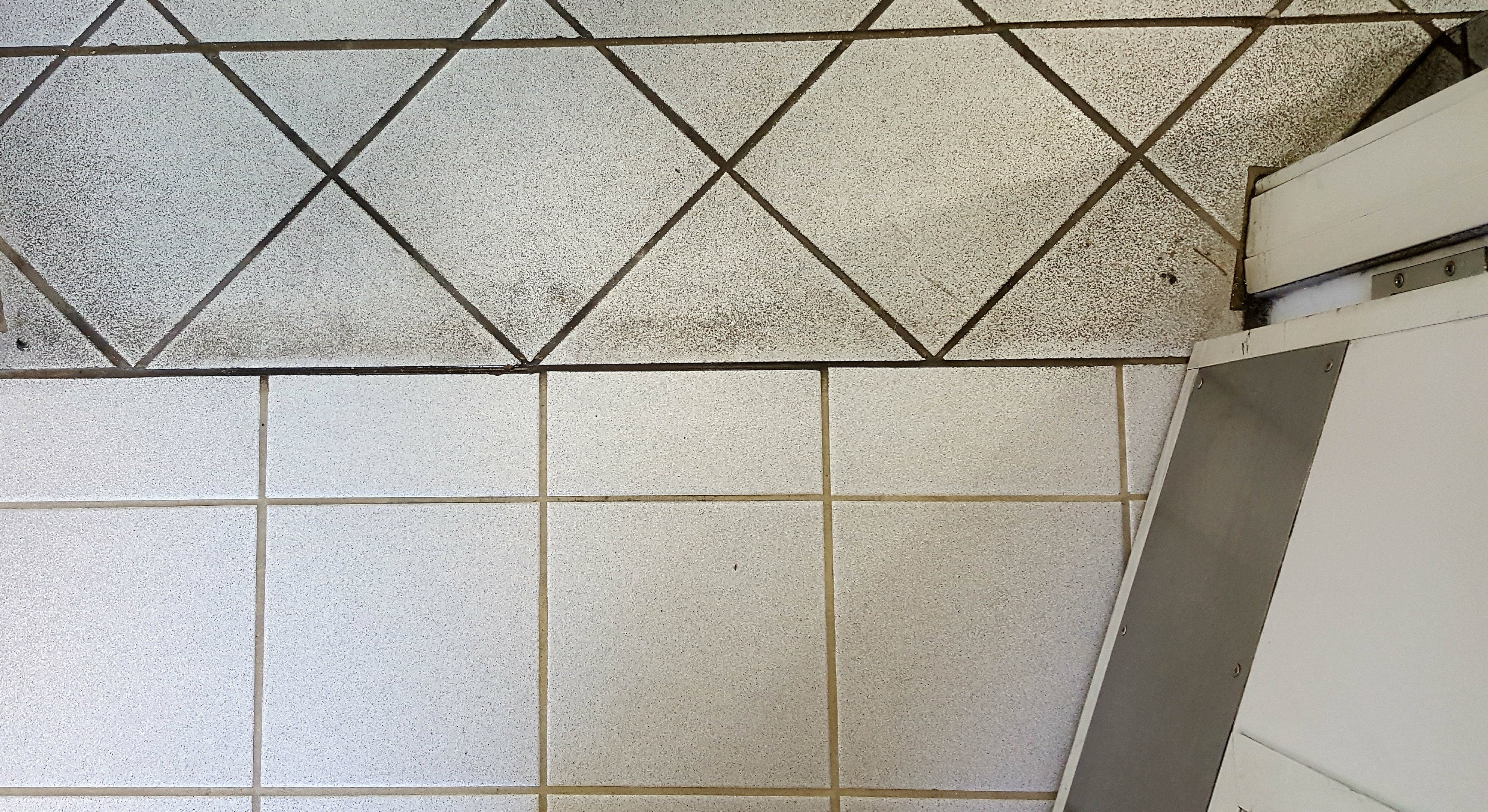

    looks good, I'm no tile expert but I use mainly neutrals on tiles pic from halfway through job last week

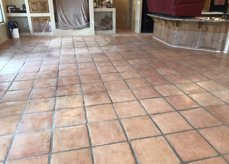

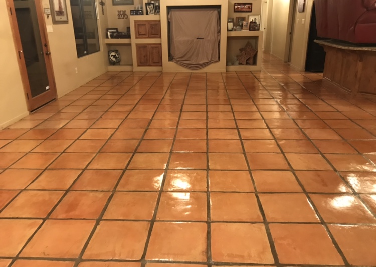

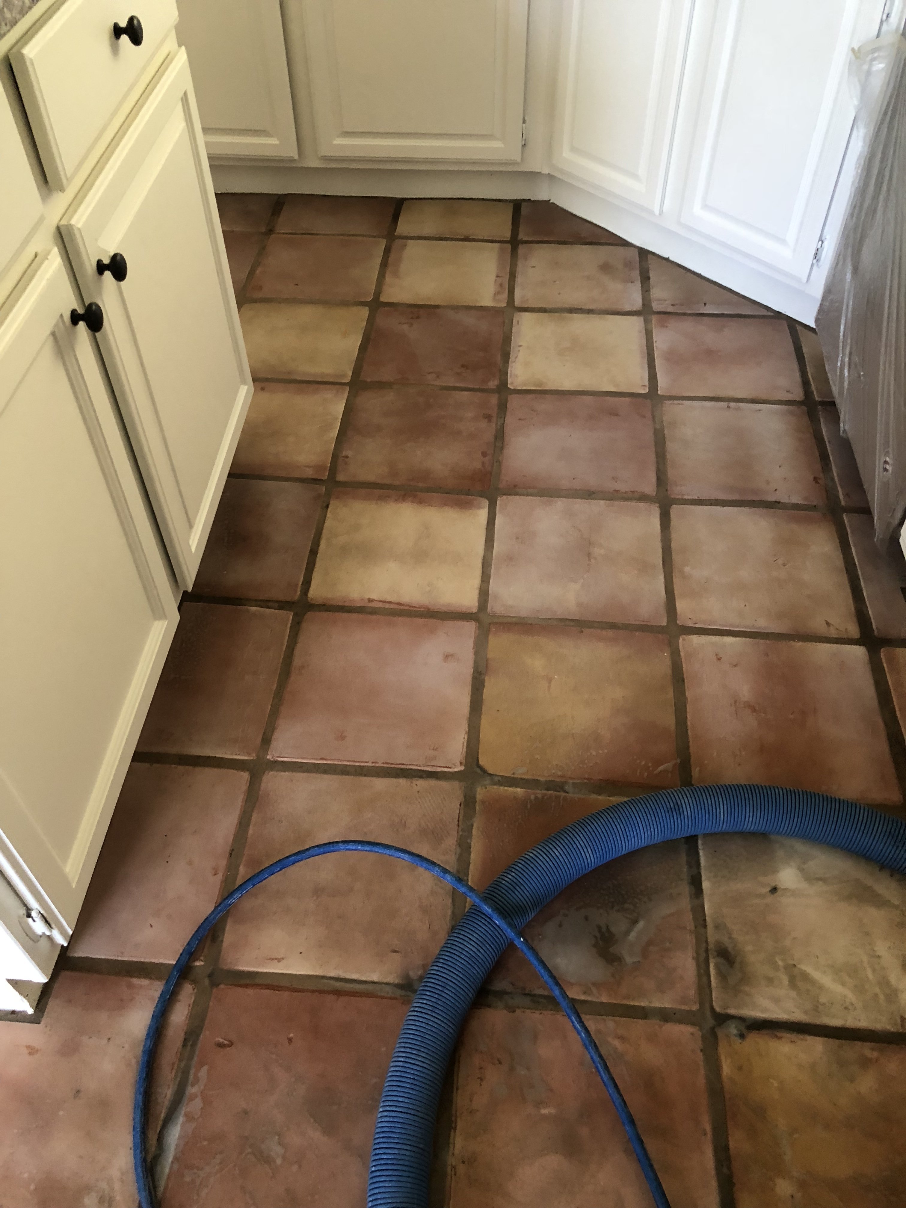

    my favorite floors lots of work 86A4A1FD-4F4F-4385-A79F-1711E89C90A4.jpeg A42FE329-2CC1-4456-B7EA-80D144CA2270.jpeg BC6B4EEB-2BEB-4703-A9CF-E9F01BC0C283.jpeg
