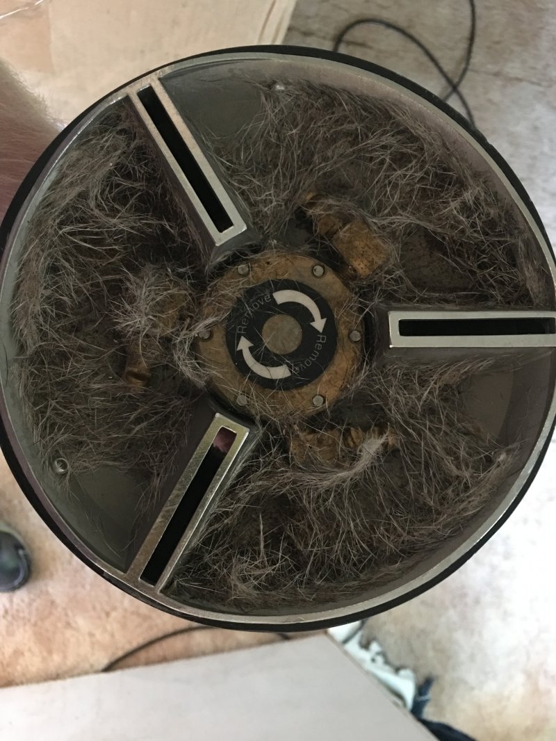

Little head is furious...
Mad as an ex wife and twice as determined to get everything.
It takes longer but you can get the longest term, most impacted crap out of the worst of the worst carpets.
I do urine extractions too at times with it.

This thing is a weapon....

Heydere Grant, you need the SS hub on the bottom of that cleaning head. Maybe these guys would get it if you spelled Rotovac on a really soiled carpet and posted a pic of that!

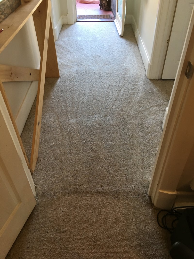

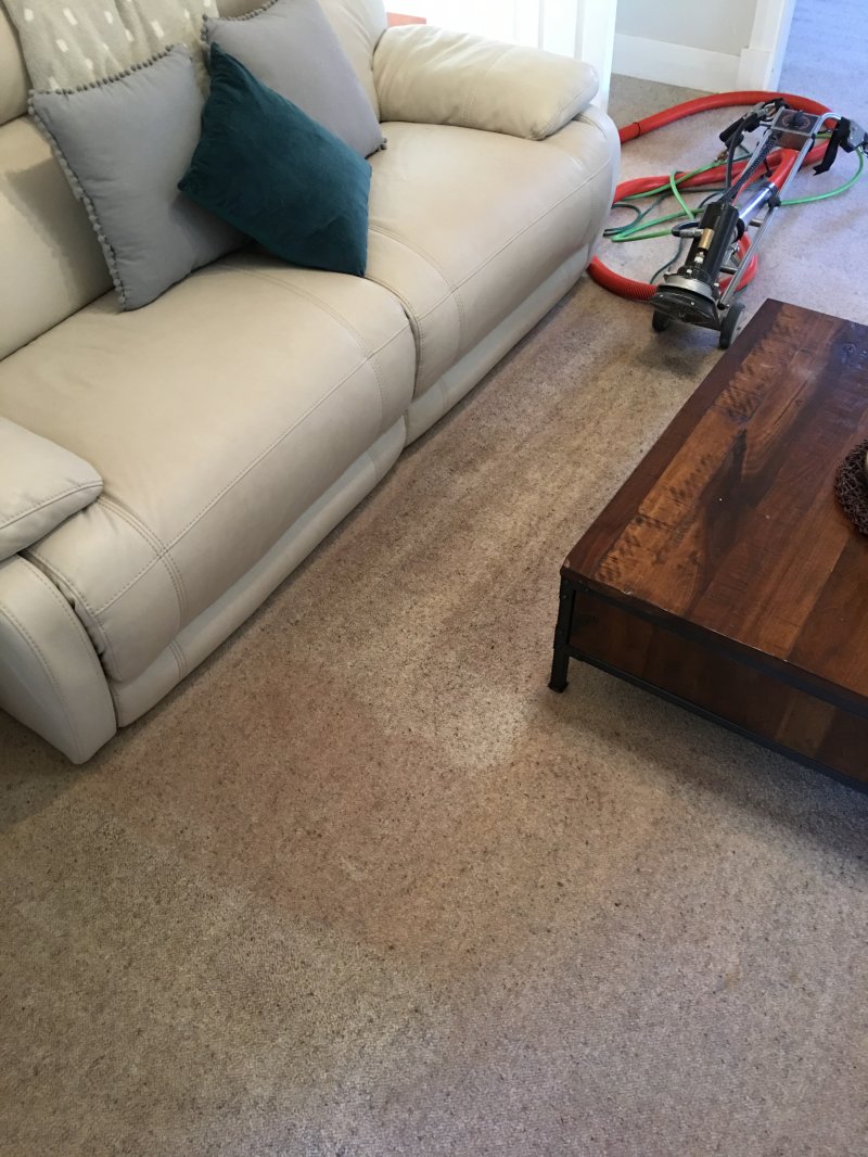

I'very done a ton of work with the RVStairPro/Swinger & CFX combo. That's where I fine tuned to run off the water faucet direct to the cleaning head, choked down to 1 jet at approx. 35 psi. In some empties you can easily crank the water heater to high.
After the slight slope learning curve of the RvCFX, I had some pretty remarkable results as Grant shows in his pics.

Its a long job yes.
No denying it. But the dog hair and shit was unbelievable .
I would like to get a DHX. I think that is the way forward perhaps.
But the Housing Commission work just needs this sometimes. There are only 10,000 dwellings here.
I was the first guy to introduce standard RJE cleaning for all carpets (provided they are not demonstably unsuitable) .
I wasn't able to do some of these projects before. Now it appears I can. That service is surely worth it's incumbent overheads on my side so I can keep the lights on.
In the context of the Australian market I'm a contractor.
This first job has gone well. See how I go going forward.
