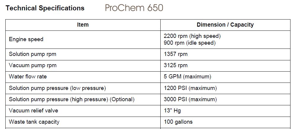

26,991
You are dual wanding with this:
Both the SS570 and PC650 are now delivering 13" hg. Why ???
Maybe they want to be able to pull the wand off the carpet. Once you are past 10 inches hg, it's the air flow that counts. An Everest cleaning at 10 inches is way more powerful than a blazer cleaning at 10 inches.

I thought the ideal lift is 12-14hg, and after that you want good CFM

Maybe because in the interest of longevity and decreasing warranty issues they don't run everything balls to the wall?
The majority of medium pressure blowers are run at more power than 13".
The fact that air-cooling is ducted to the belts on some TMs may have some relevance.
