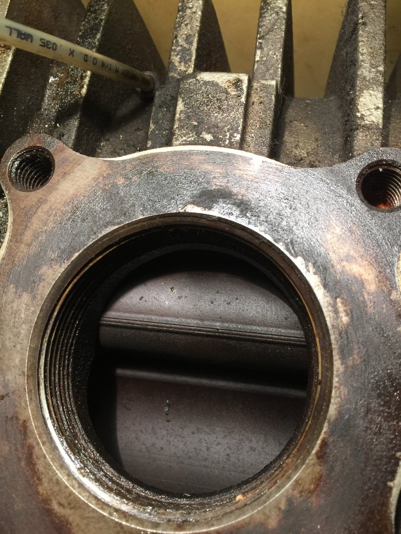

Take your sight glasses off and clean them up while your at it..
Post a picture of the lobes of your blower..

To take the blows out would it be diffuclt? Undue bolts from the the black casing and then disconnect from a coupler???

That thing is HEAVY!! There are 4 bolts under it also 9/16 I believe.. I rigged up a winch to pick mine up..
