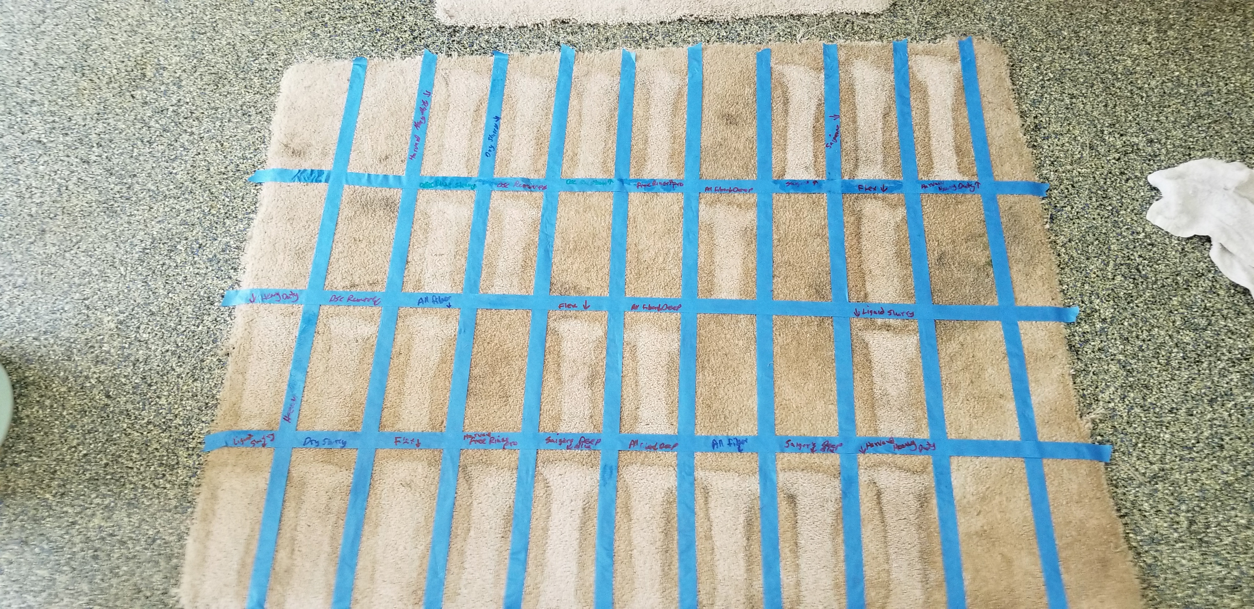

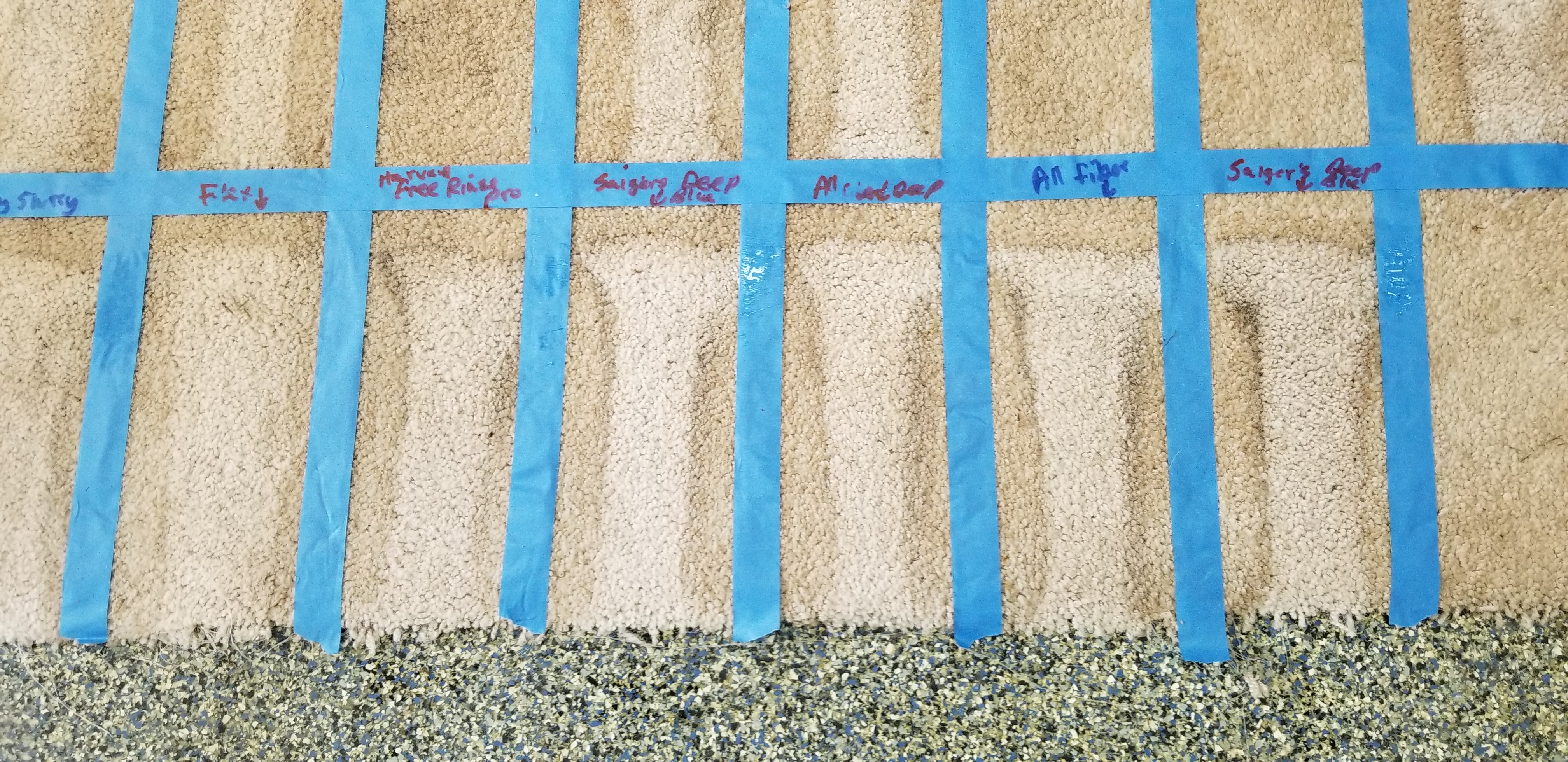

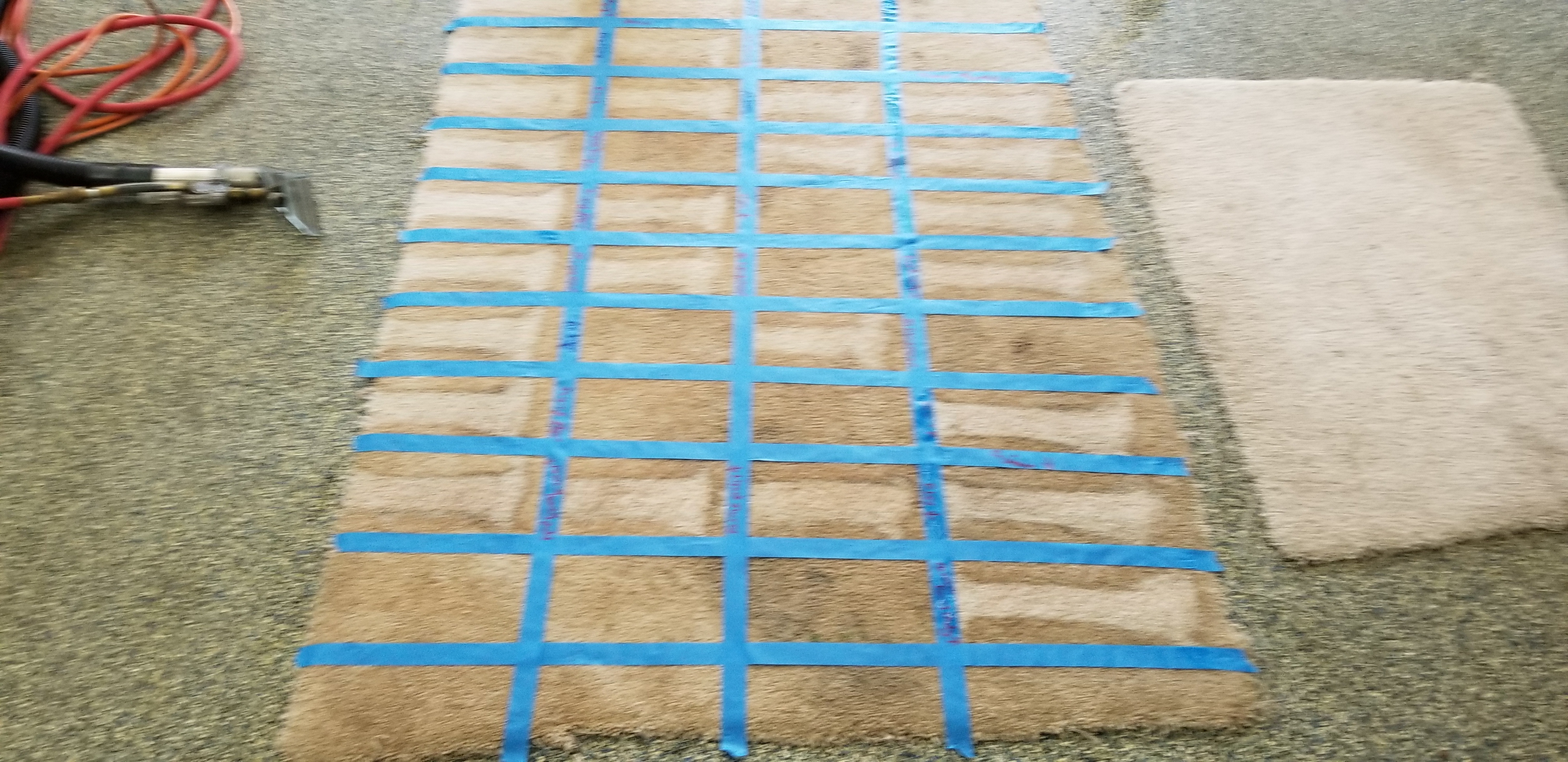

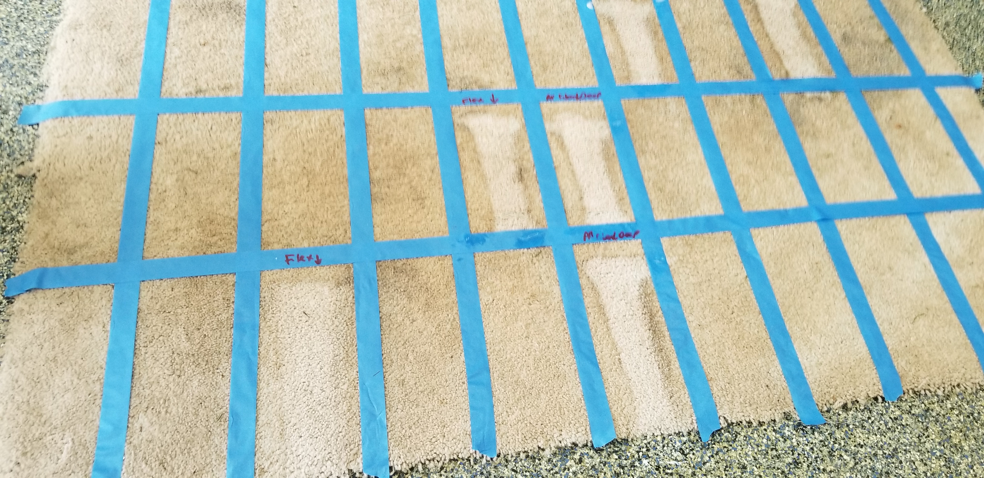

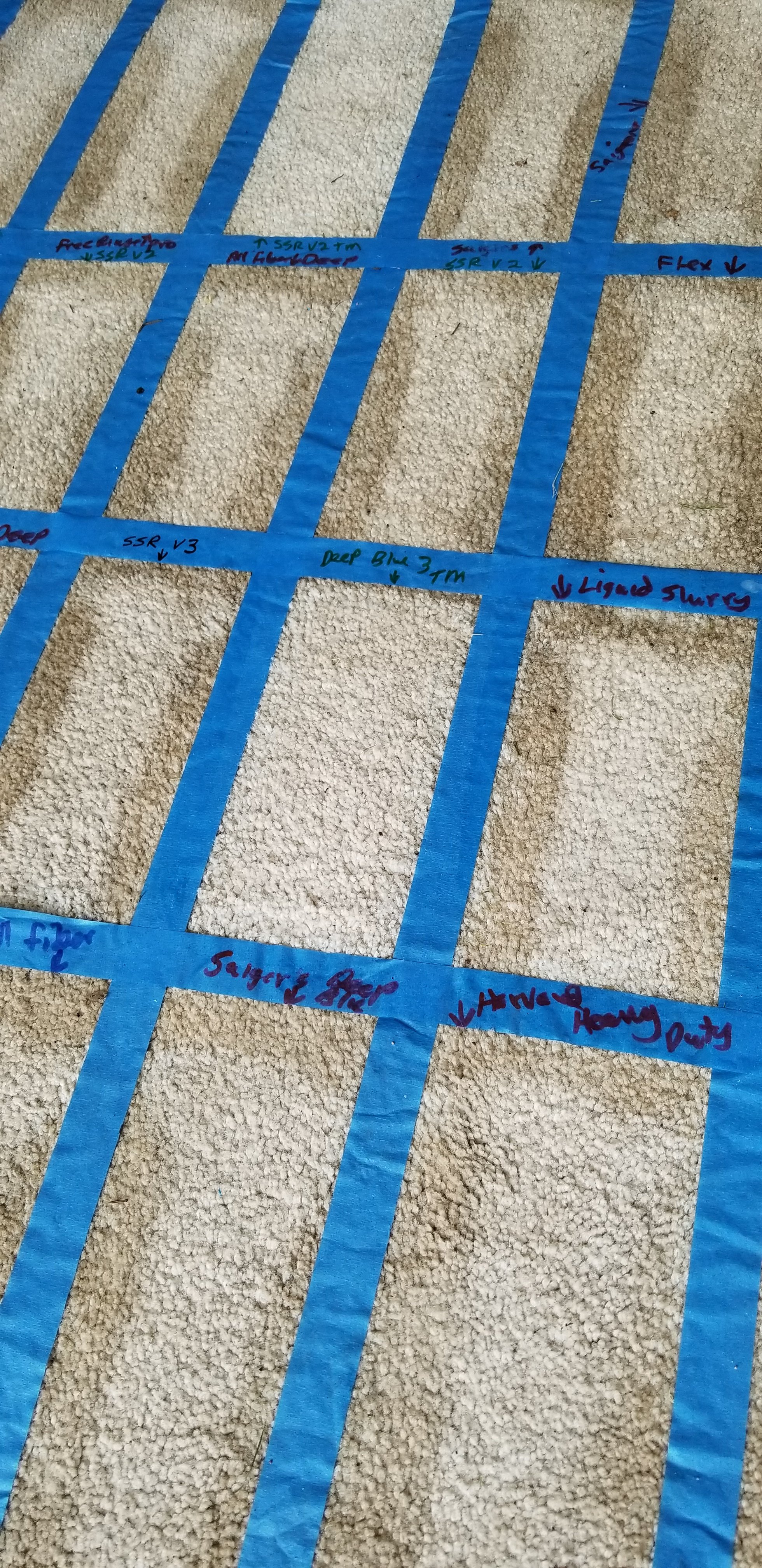

My messy shop....real messy....
And yes...Flex and other products...
Only way I know how our products are doing is to have other products to test with too....
These are just my tests to compare how much a rinse had in cleanability alone...so not every rinse was created with that in mind really....
We have just been working on a new Rinse and these pics were taken really more for my information...and I also shot videos using each product...again just for my information to refer to.
I was doing 2 clean passes and one dry pass just to see....again, just to help me....
So yep...I have bought a lot of chems….this batch was $500 to purchase and compare....

26,988
What's your best alkaline rinse so far? Have you tested Procyon plus powder? Any opinions?
11,197
Grand Rapids, MN
Best out of the 3 alkaline rinses were Harvard Heavy Duty....but again....I am a Harvard guy...so....I would ask others to test on their own....
My new rinse I want to take the place of having to use an alkaline rinse anymore...
I have not tested a Procyon Powdered product in these tests...and again, I know things are differently designed with companies than what we might be trying to do here....
