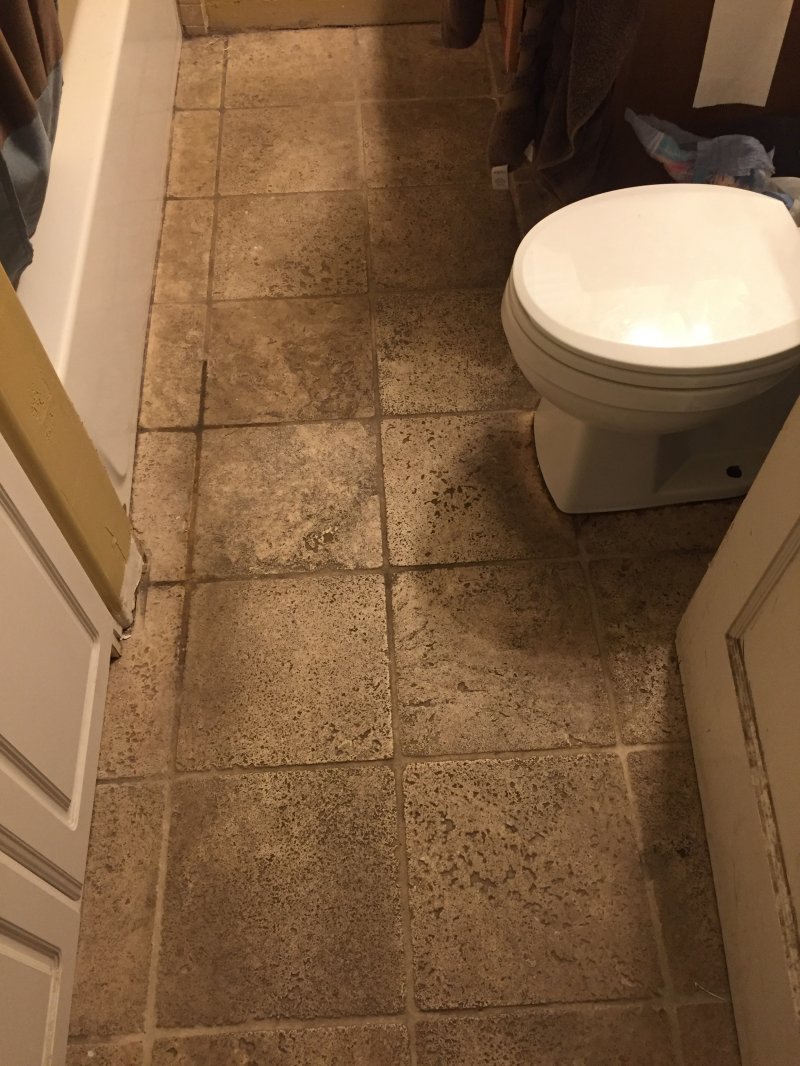

    why people put travertine in a restroom then turn it into a rental. homeowners are back in they'll be replacing soon. what would be your plan of attack?

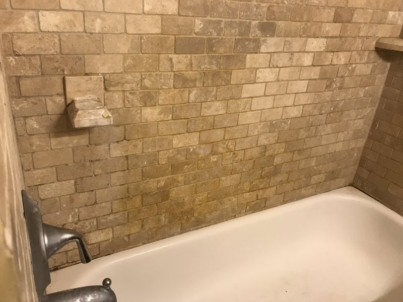

    IMG_5818.JPG can you tell what kind of soap they use

  15. clean image
    clean image
    Joined:
    Oct 5, 2012
    Messages:
    620
    Location:
    Orlando
    Name:
    Carl Maddock
    It really depends on the type of stone, and finish.
    Some stones benefit greatly from just cleaning, like the one above- I filled,postfilled with tumbled edge.
    If they are asking you to clean a factory honed and polished, then there are other problems , as it's difficult to get dirty
    Polished, honed, brushed finish?
    Castle installation or standard
    Sand unsanded grout lines = width
    Butt install or 1/4"
    Un filled, postfilled or factory filled trav
    Chisel.ed, tumbled, micro bevel, square edge?
