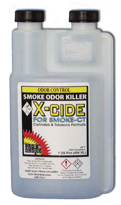

I get my share of Prop 215 houses. Thats California code for legal Medical Marijuana. I've had killer results with Pro's Choice X-Cide CT+ for Marijuana. I know odorcide has got something new out also.
x-cide-for-smoke-ct-png.11984
23,468
Redding
How do you apply it Damon?
Ok, get ready.....
I mix 16:1 and spray walls and ceiling with my penguin sprayer using the upholstery misting tip. I then mix 8:1 to 4:1 and spray carpet and rake it in. Then I take a humidifier and mix 16:1 and let it run over night. I place the humidifier under the HVAC Return and leave the fan running over night. You may need to place the humidifier on a ladder to get it directly under the return vent. It's a two day process but my results have been awesome. My property management customers love me because of this.
