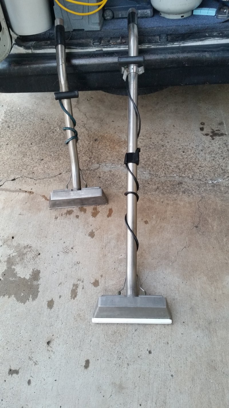

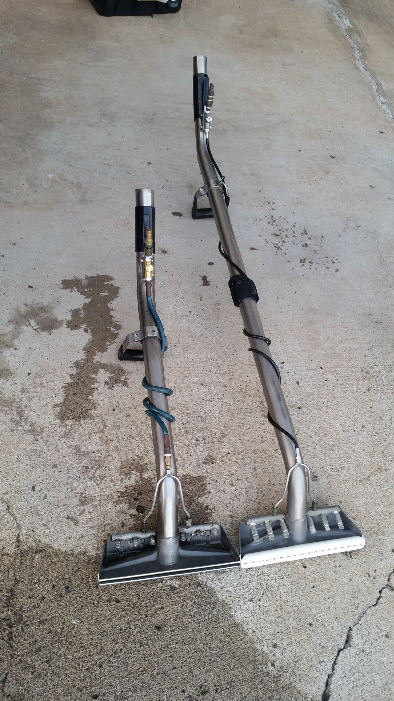

A special thanks is in order for 2 awesome board members @Desk Jockey and @Able 1 ..... I found a Prochem TI wand on Craigslist and Chavez went out of his way that day to get it for me....
Ever since I seen Keith @Able 1 shortened Prochem TI stair wand years ago, I always wanted to have one.... I've searched high and low for one to chop for years... I hardly ever use my Regular TI wand, but didn't have the guts to chop it with how much I paid for it.... I've never met Keith but he's always given me good advice and tips.... So I sent him the wand to get it shortened...
I do need a glide, jet extenders and new jets but other than that I can't wait to use it... I tried using it today on a job, but the jets were clogged and I didn't have the time to clean them...

Awesome set up..
Why the extra long hose on the full size wand?
I had a hole in my old one and my pops had a rather large supply of parts always on hand... I bought another hose which turned out to be a little longer than the one you see on it.... I'm cheap and won't pay for something if I have it on hand.... If I actually used the wand more, I would get the hose shortened.... My local hose shop doesn't have the SS crimps... I think the hose was for a hand tool from a spotting machine...
As for the stair wand, I just got the wand a day ago and wanted to try and play with it... Jets clogged, no glide, no extenders, it went over like a lead balloon.... I have at least 5 or more stair tools.... I don't like the straight PMF ones, the small prochem stair wand is what I'd carry but still hack stairs with my full sized wand (if it fit)... I swear I have a graveyard of tools....
I do want to add a wand handle to the bottom side of the tube... Right below the current handle... Just 180 it and it should be fine to catch the risers.... And I have a POS PMF swivel..... I'll probably Saiger it later on....

Have you tried the SS uph tool on steps yet?
Just killer on the bullnose
Yea, but I don't like the tackless strip <<<<<<------ @dealtimeman ruining and putting grooves in my $450+ upholstery tool and also it's only 4" wide......... I'm already a slow cleaner as it is.... I'm lucky/tired if I can squeeze 3 jobs in 1 day.....

Sweet wand, I don't like the straight tube though... I was also looking at the Bentley Stair wand Cobb's sells, but I got the best of both worlds....

Just curious Nate what don't you like about the PMF swivel stair tool? How old is it?
In it's stock form, it's a POS.... The jet sprays almost an inch away from the wand head.... Then it's reduced to a 1" tube at the swivel... If I had it setup like @Mark Saiger , then it'd take me some time to get used to it.... I don't mind flipping a wand, it's more natural for me.... I also wanted a wide head stair tool with awesome flow.... I'll even hack a few mattresses with it..............:shifty:

The "S" curve is key.. I made a straight 4 jet prochem and it was horrible! With a cut down ti wand your back is straight all but for the last two steps.. I have also used the SS upholstery tool in a pinch,but far too time consuming! Bending over to clean stairs is a back killer, and there is no reason to do it.
