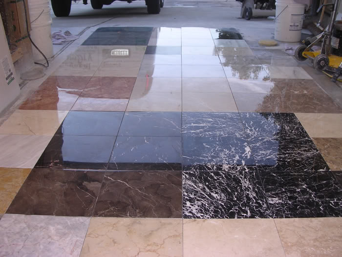

Wayne, I did some testing a few days ago (honing powders vs diamonds). Note, not trying to prove you wrong bro. In the contrary, I'd love to find an alternative solution to not having to use diamonds on some jobs hence the mp invention.
Here's some pics
www.bedrockstonecare.com/cts450.html
Albert

You would need to take the honing powders up to 1000 to 1200 to match the 800 diamonds. Grits between diamonds and powders are not the same. You also skipped the 220 and 400 step after 100.
We didn't use the monkey pads on our travertine job on Wednesday because they didn't have time to fool around. They used the 600 honing powder followed with This Old Grout & Stone's "Jazz". Deep shine and clarity was the result. I'll ask if they took pictures.
BTW, I wouldn't use honing powders on marble, only travertine or limestone.

Something about the make up of marble that you loose clarity I guess. I don't have 1200 grit hp but did do the 400 and 800 powder after the 100 diamond.
Albert

With marble you need to take it up to 3500 before powder polishng. Here's my resin steps after metals: 50, 120, 220, 400, 800, 1600, 3500. I would then use This Old Grout & Stone's "Outshine." This would probable produce better then factor shine and clarity.
Short cuts usually don't work with marble.

Wow, you're extremely thoughrough. I use MB's pads and don't even have anything over 800 grit. Maybe it's the pads but clarity is very good on most marbles in my garage floor.
Albert

I didn't know MB made a diamond encrusted pad. What was done to the floor in your picture? How low did you start and what steps did you use?
