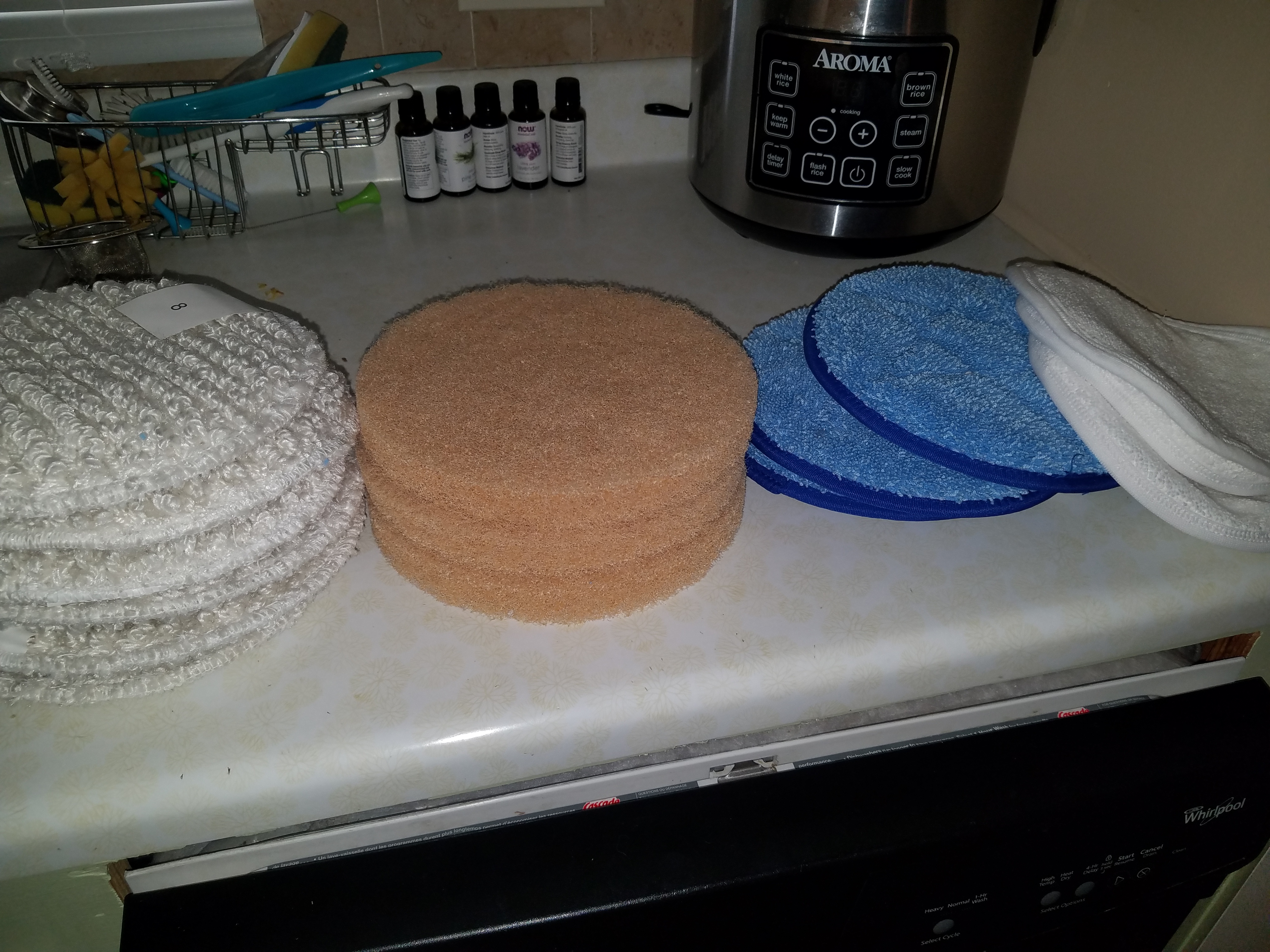

Gonna be using these with my OP... looking forward to it..
This is my current tool..
