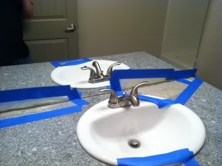

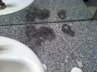

Nasty oil spot on a bathroom counter
Used some Wet Poultice from Stone Pro

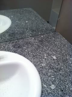

I'm going to put some more poultice on it and hopefully pull the rest out.
I'm pretty happy with the results considering this is the first time I've tried this.

These are the best pictures I got Ron. I didn't take pics of the little spots because I figured they were no big deal. I was concerned about this big area.
I left the poultice covered for 24 hours. Then uncovered it and left it for another 24 hours. Then I scraped it off and let the stone dry for 2 days because that was the soonest I could get back.
