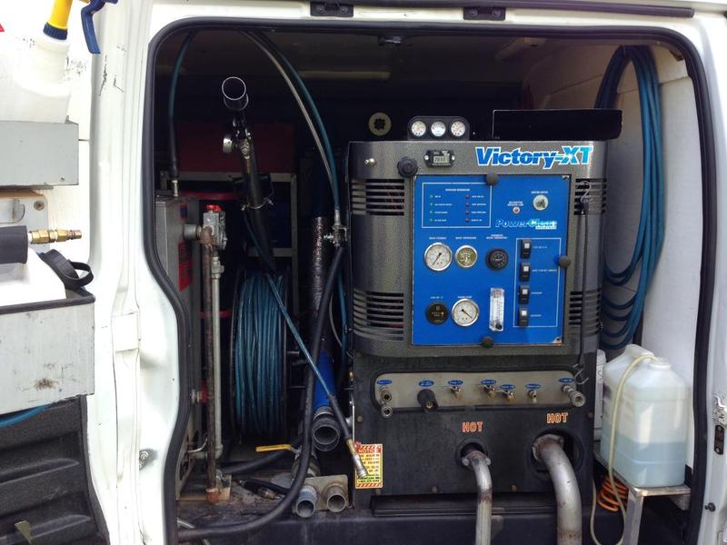

Dan's right, it's a 10 gal tank with a propane capacity of 8. I mounted mine on the driver's side, between the frame and body.

A couple inches is enough. Don't put it by the seats, you'll be sorry(to hot to sit next to). I like mine within arms length of a door so I don't have to climb in to light it. You can see mine to the left of the door.

You know it's explosive, right?
Shane, that's a nice looking monster(tm)! How many hp? Did the gauges on top come w/it or did you add those?
Shane T
Nov 7, 2006
1,663
Waukesha, WI
Shane Tiegs
It's a 31 water-cooled Kholer with a Roots 47. I added the gauges on top. Oil pressure, coolant temp & volt meter. I don't like to wait for an idiot light to tell me something is wrong.
