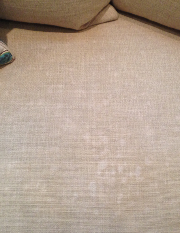

Is this exclusive to furniture stuffed with down, I ask because I came across a high end set of dining room chairs (possibly down filled) last week that I was supposed to clean that had un-explainable pinkness on some areas of some chairs, it was not transfer (from pants or something) and showed in the strangest places. Like on the back, I cleaned one of the un-affected chairs and it came out fine, then a second one, when I noticed the pinkness, which really lit up when wet. I then declined to clean the rest. It was natural fiber, and I put a little red 1 in an inconspicuous place, to no avail.

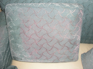

This is what showed in the above linked guided tour- Fabric damage from fireproofing:

That cushion is the most dramatic I've seen. Usually there is a scattering of spots that look like water drops, with the fabric discoloration maybe being slightly light in shade, or slightly yellow, pink, or orange. Most of the time just seeing if the cushion has a cotton-wrapped cushion inside is enough of a clue, and many times that cotton cushion wrap will have brown speckles that match the location of the discoloration on the face of the fabric.

yeah I've come across into that situation also Ofer-- Bryan's response will be interesting and helpful since I couldn't positively identify the problem and blamed it on baby formula- which may have been wrong.

Ofer, that photo is typical of the pattern from fire retardant, so it could be the cause of the discoloration in your photo. One clue is if there are no spots on the frame. I haven't yet run across any furniture that used down under the shell fabric.
