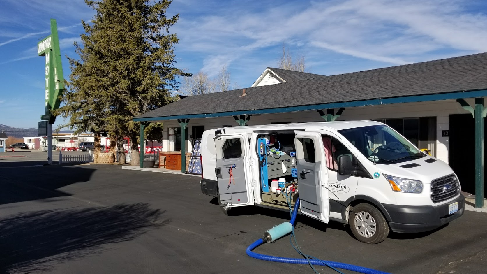

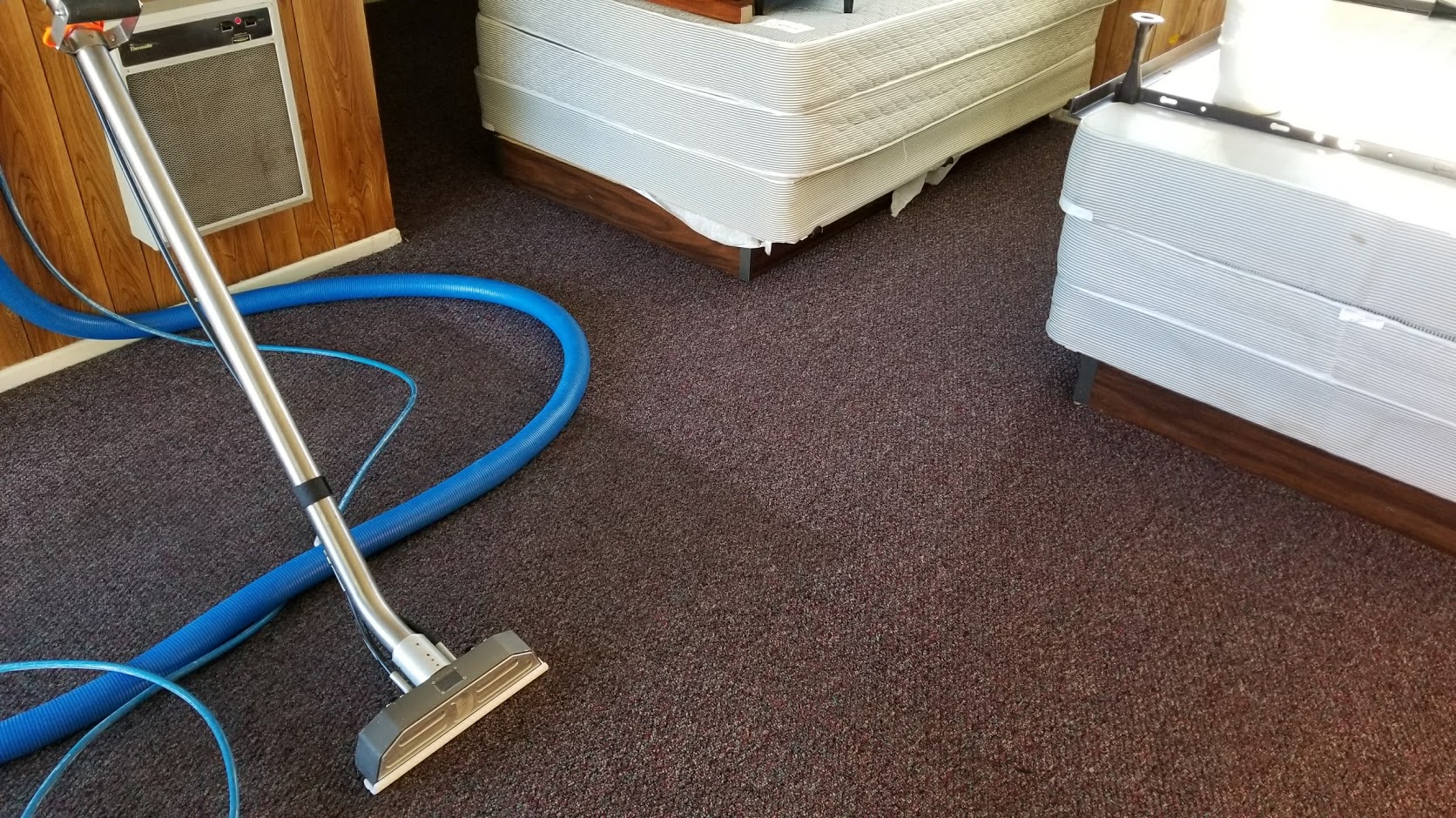

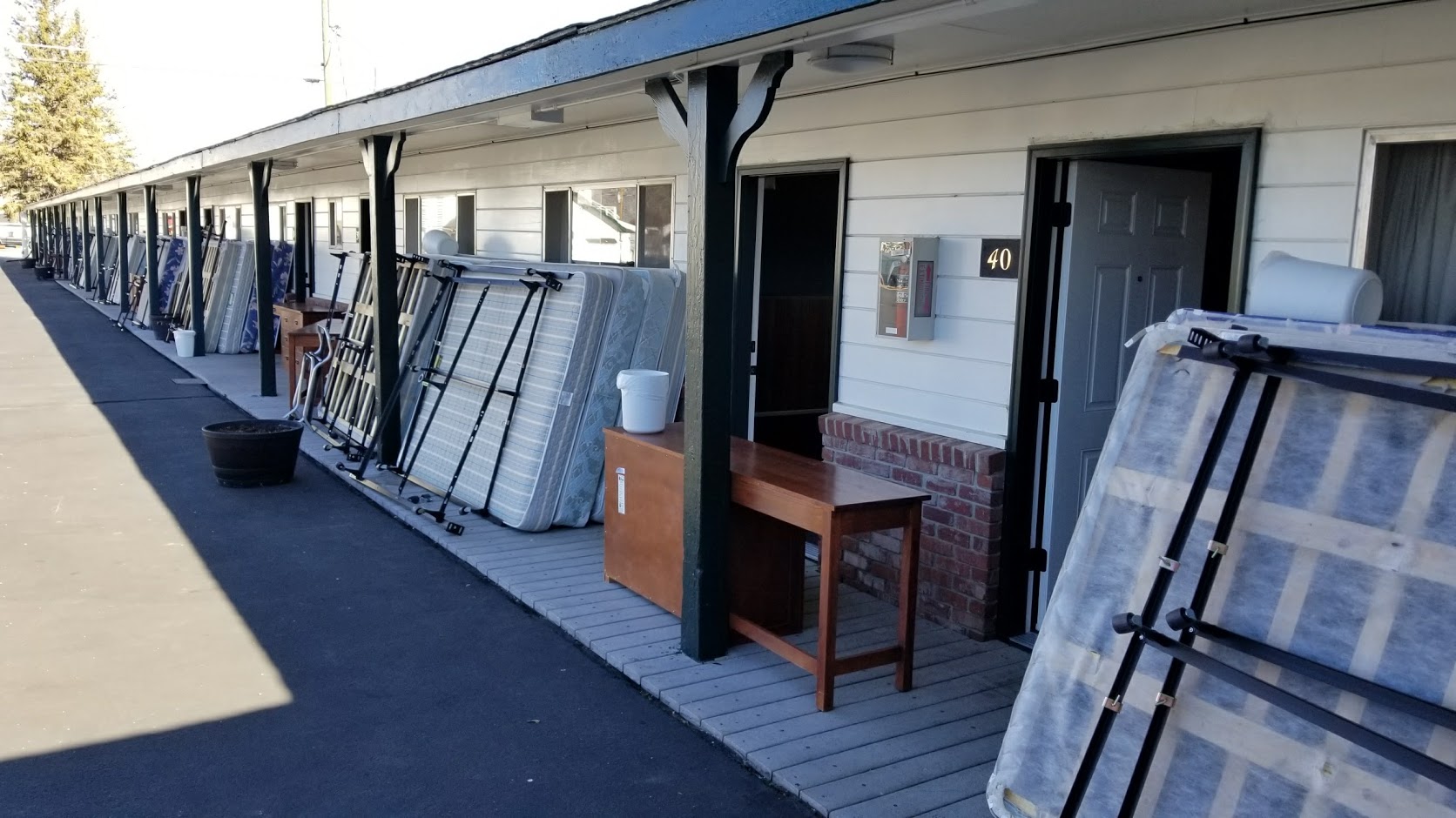

My big motel job..
112,312
15 rooms @ $1310...
Good thing I brought help as this anal retentive OO method would have had me there until 10 pm tonight..
Packed a Kirby bag, trimmed up a pound of loose Berber yarns, red pad slow rinse, fan dry..

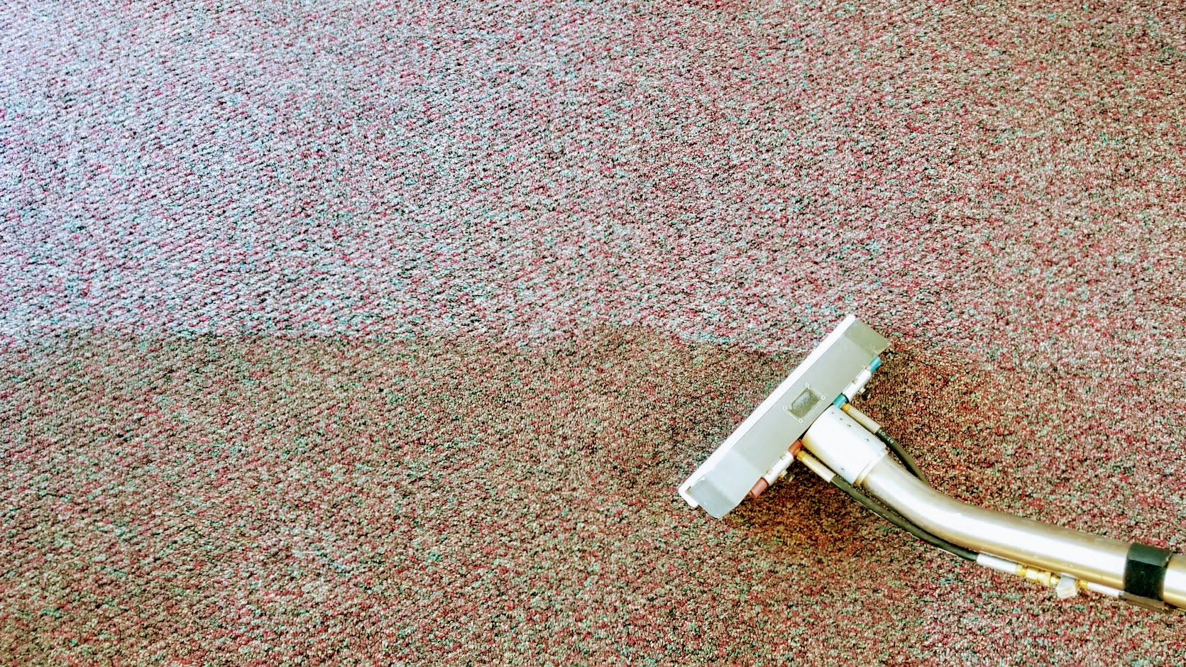

Matt's confused, a red pad/175 is very best way to remove oily soil from Berber.
and the Kirby is a much better edger than the Oreck.

because a 100 pound machine and a red fiber pad works much better on flat weave Berber covered in black top slurry, even an idiot like Marty knows that.

I've seen red pads do a better job than just wanding but I hate loading and unloading the 175. And it just seems to skim over the surface. I'm more impressed with the 15 in crb but need brown brushes I think to really knock it out.
San Francisco, CA
I used my 17" crb with blue brushes (for residential synthetic) on a job that was as dirty as Mike's hotel and it did great. But it wasn't a flat weave looped carpet. I'd be interested in seeing if there's a difference in time and cleaning results.

Yup...175 rocks the berber...you need the weight.. brown brush works well loosen up dry soil prior to vacuuming but 175 wins this round or OP like Tim has
