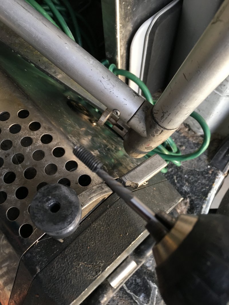

    Yup. My poor crb. It has a loose handle so if it leans backwards it turns on by itself. Well, it was in the leaning position and when I plugged it in, it proceeded to do its best evil Knievel impersonation launching itself down the stairs. The handle broke off, snapping the bolt flush with the mount. I was totally sick inside.
    Luckily I was able to get the remaining portion of the bolt out with a drill and an ez-out. Saved my ass. I felt very lost for awhile. I would consider my CRB Damon Approved. It's givin me 5 years of good use and now has been launched down a flight of stairs.

    Damon, that is precisely why I put a lighted switch on my machine, between the pigtail and the motor. You can always swap out extension cords any time. Importantly, you can kill the power until you are actually ready to operate the CRB.
    Those handle-position switches are a safety hazard.
