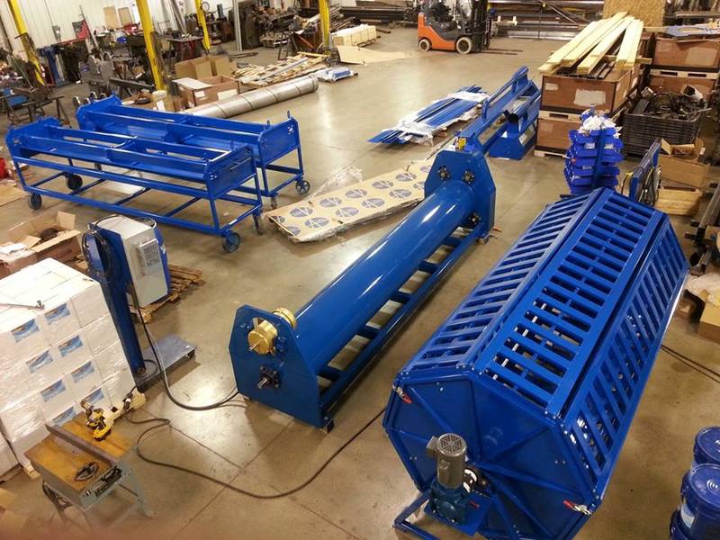

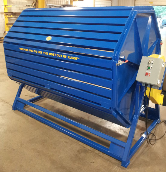

The 8’ model that we designed and built is as follows:
Floor Footprint: 108” X 48”
Height: Measuring from floor 67”
The Basket or Dusting Chamber is 96” long and 60” in diameter. It has two doors to access the interior. It has fins or paddles inside to assist in flipping and tumbling the rugs during rotation.
The entire device is made out of steel and powder coated blue.
It comes with a Baldor Motor with a Euro drive 192:1. Engage the machine by pressing the on button. It rotates about 9 times a minute one way, then reverses 9 times a minute going the other way. It repeats this sequence continuously until the operator stops it by pushing the stop button.

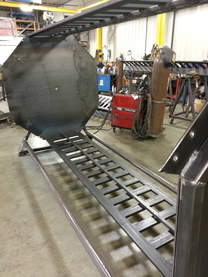

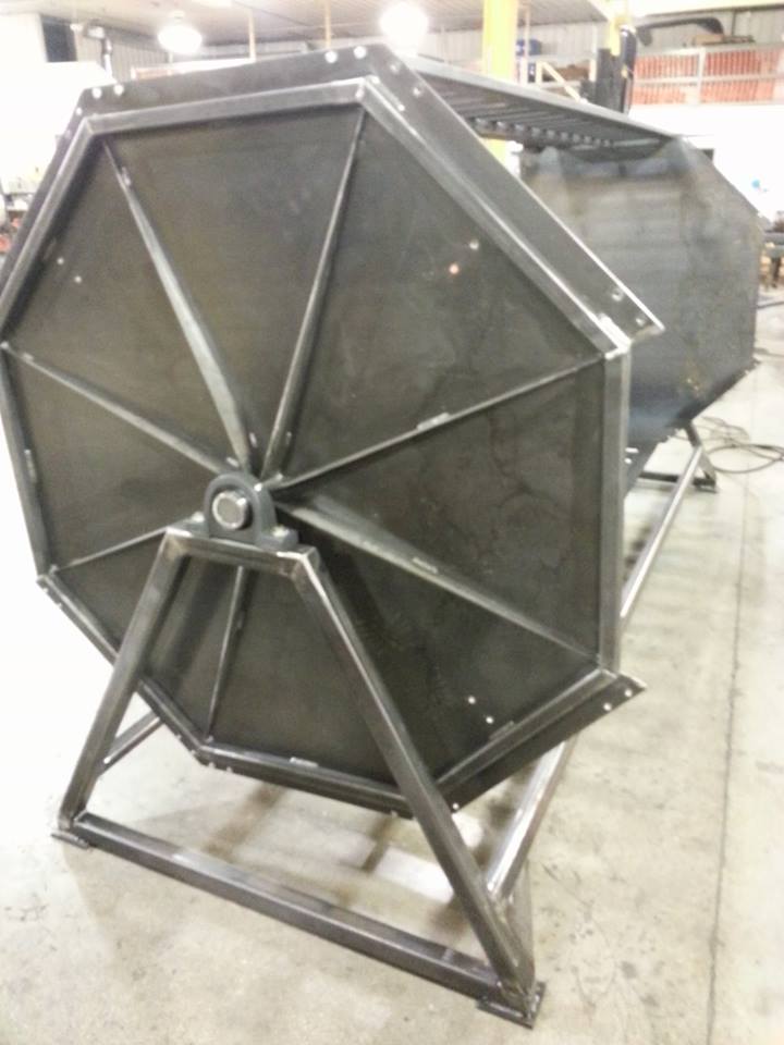

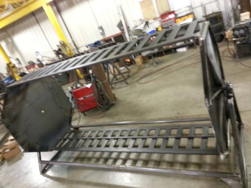

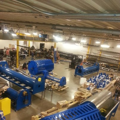

Here is a recent picture of two under construction at our Centrum Force Fabrication facility:
The beauty is that these devices operate off 110-115 v electrical outlets. It has only about an 8 amp draw.

Call Robert Mann about his 8 foot model as seen above. This is where you can contact him: http://mannrugs.com/

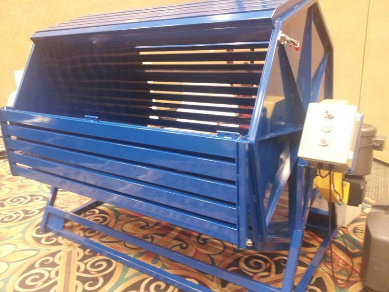

Or call Joe Gabel about his 6 foot model as seen below. Joe has a rug gallery too. His contact is: http://serafians.com/

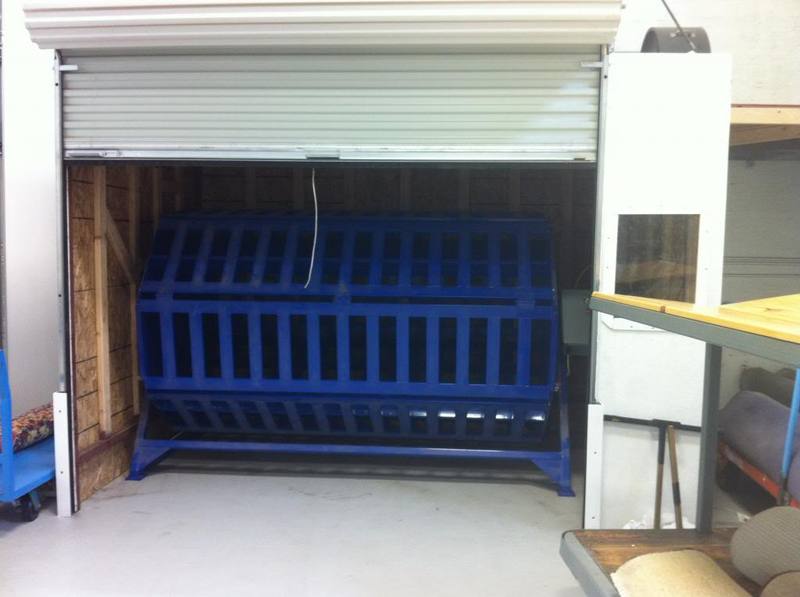

Usually, these devices are put in a separate containment room that has negative pressure. The air movement, caused by an exhaust fan, moves the airborne dust to a storage container, usually outside the room. The heavy particulates just fall to the floor to be sweep up from time to time.

Here is a picture of what one client did for containment:
They made a separate containment room that has negative pressure. The air movement, caused by an exhaust fan, moves the airborne dust to a storage container located ourside the room. Naturally, the roller door comes down during operation of the device.

Tom I noticed the Slat orientation follows a traditional design now.
