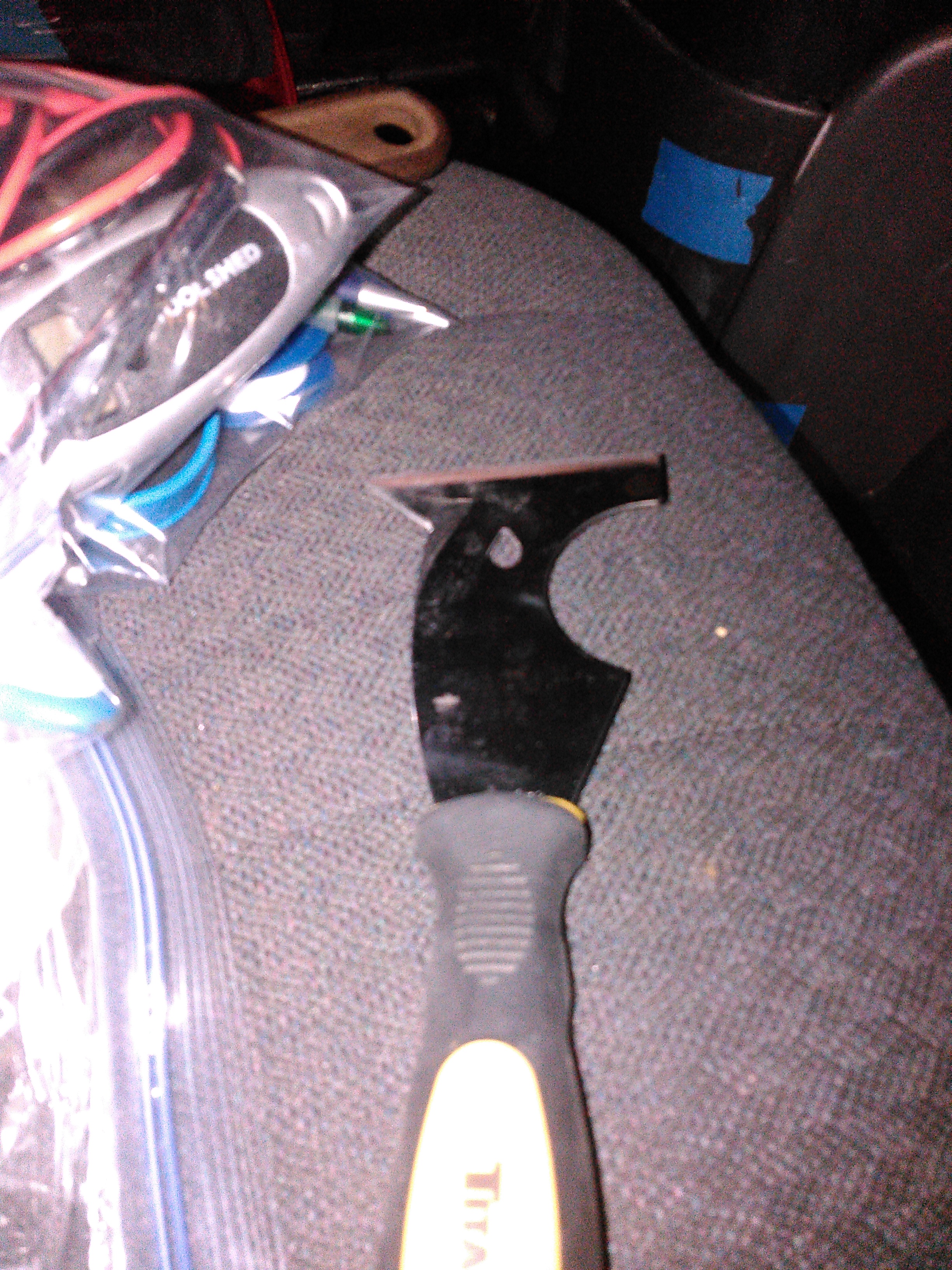

Also carry a scraper for paint specs and adhesives. On some we use a scraper on a pole first. The glue is from the insulation on the walls and the floor joists.

I use this scraper. Keep it in my back pocket. It cleans the cracks and the vac slot on the wand and spinner too.

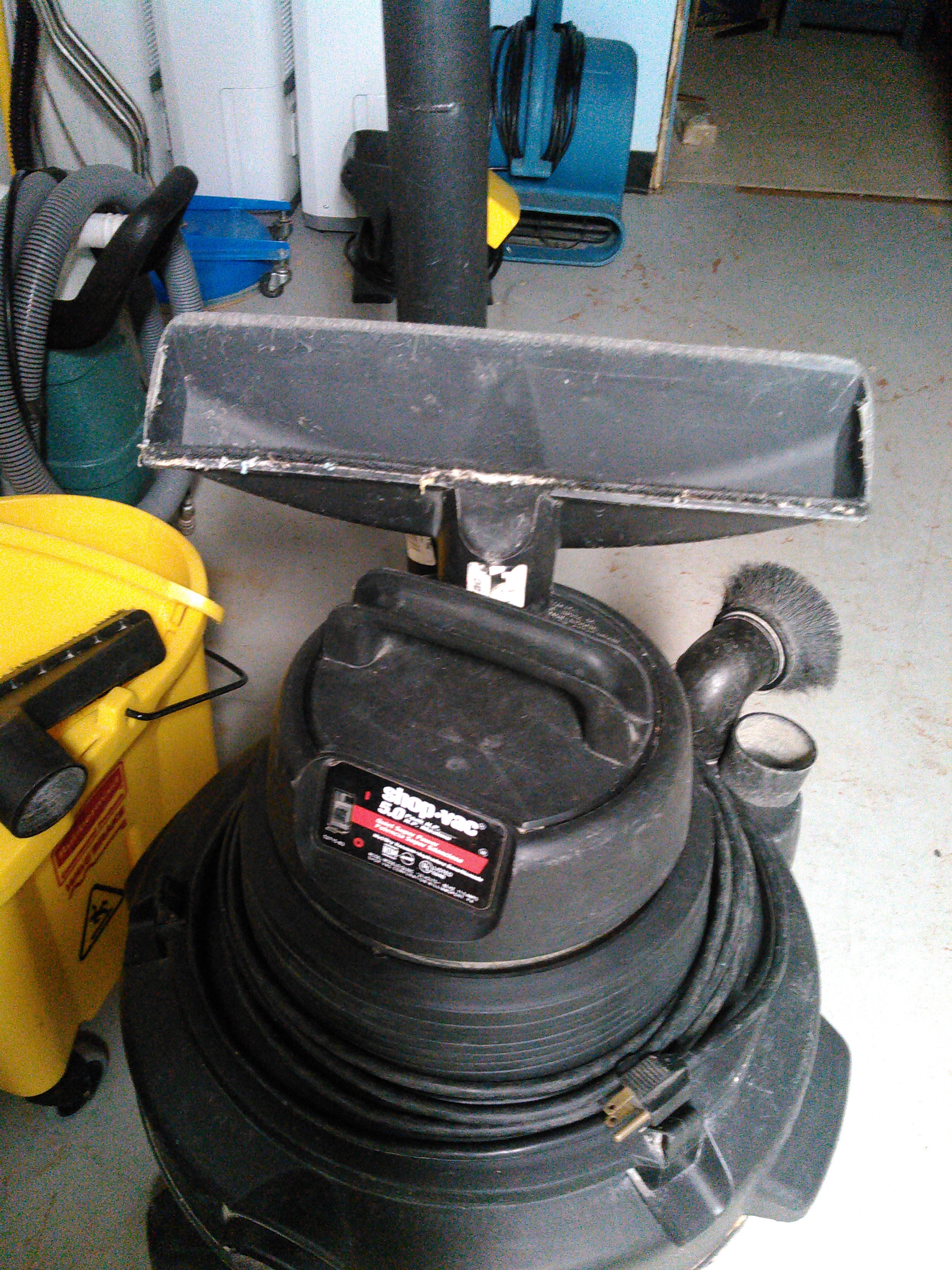

I just use a big shop vac first. Usually gotta clean the filter a couple times. I use the hard floor tool without the brush on the shop vac. Seems to work best. Keep it locked down and walk slowly backwards. Takes about an hour on our basements.
Don't skimp on this step if it's bad. Be meticulous it really pays off when you flush it. Debris will plug your spinner.

We've tried smaller shop vac s but they all failed because the filter plugs up to fast.
