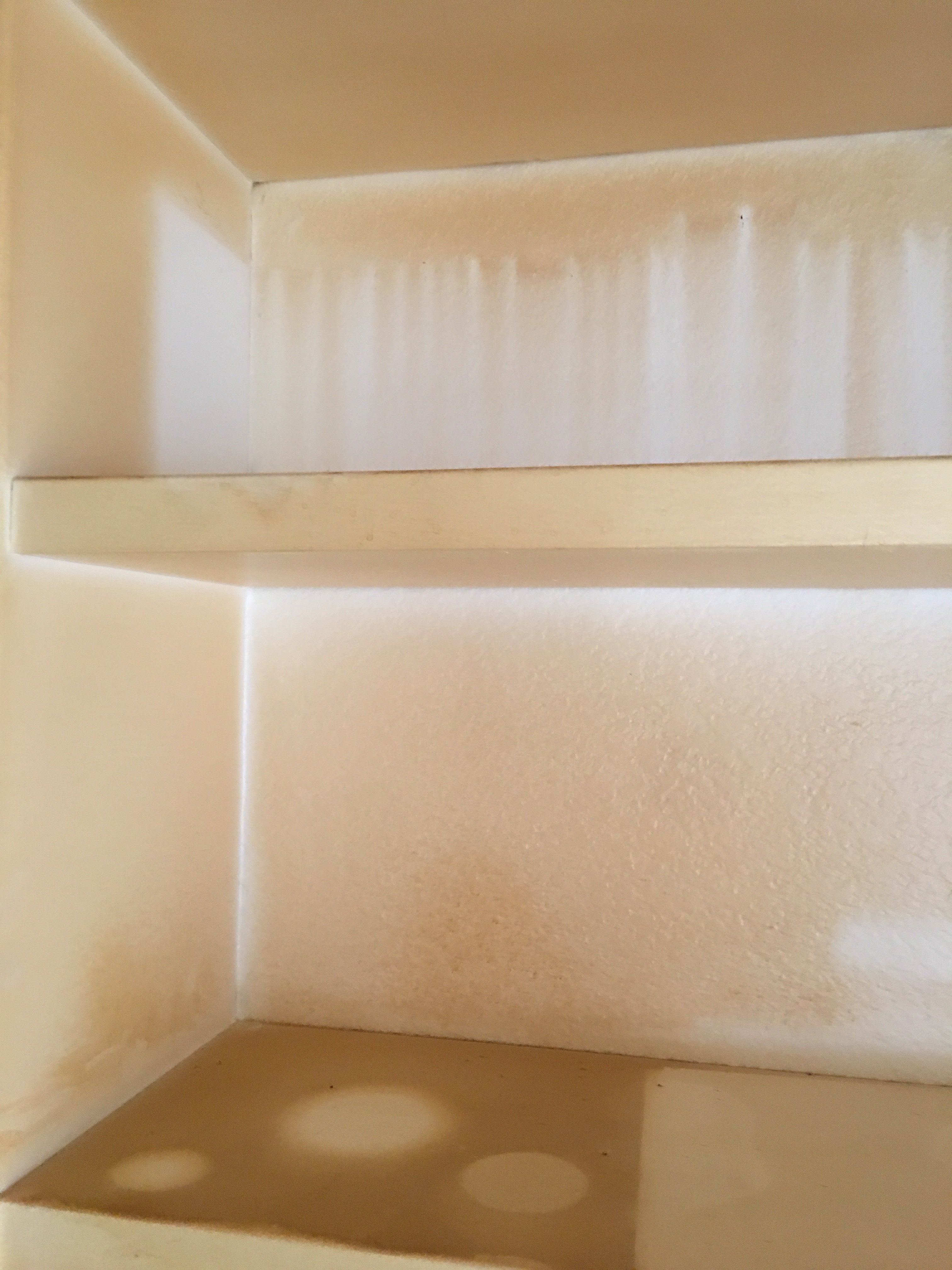

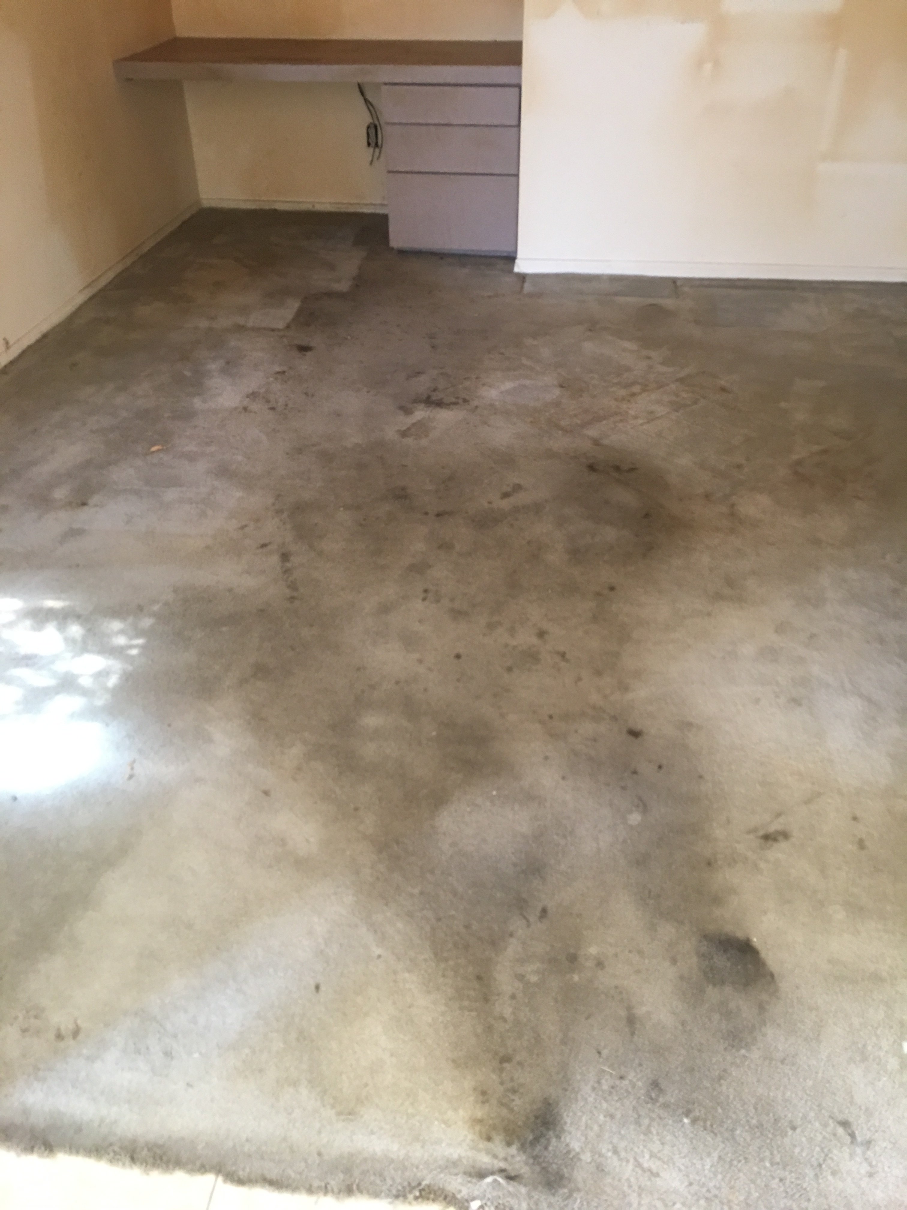

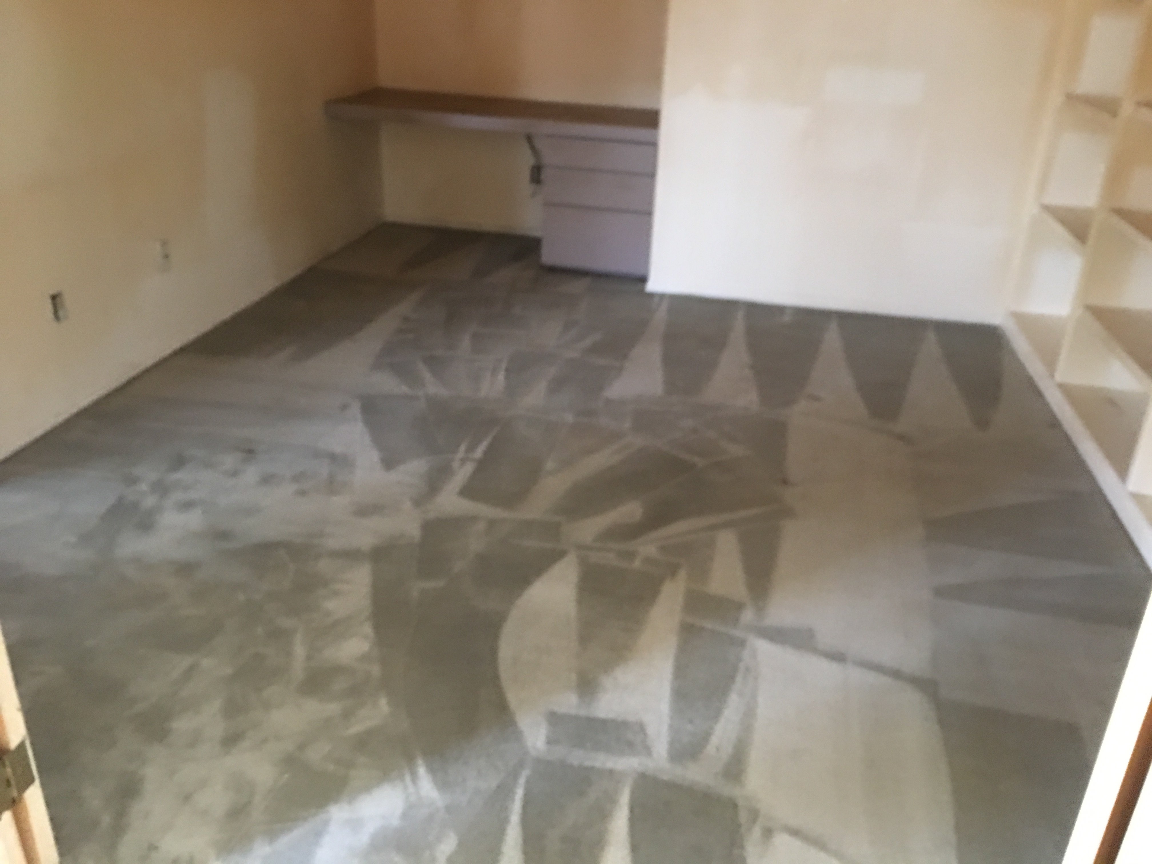

    Joined:
    Messages:
    7,416
    Location:
    Name:
    3734C370-D552-4393-A225-F3A6DE0F86E1.jpeg BAD5F90D-A23E-45A8-BCA8-74E39429A2CC.jpeg 73E03CDC-3191-490D-9D61-F0248B881CE3.jpeg I used grease eater magicwand with a splash of d cide.

  16. Cleanworks
    Joined:
    Messages:
    8,312
    Location:
    Name:
    Nice job. Wouldn't want to have to wash those walls. Pretty gross.
  17. Derrick T.
    Derrick T.
    Joined:
    Apr 3, 2017
    Messages:
    2,075
    Location:
    Reno, Nevada
    Name:
    Derrick Andrew Trulson
    I wouldnt wash them...i rather convince the owner to have it screened, deodorize and then pained....if insisted on just washing walls, I'll pass
