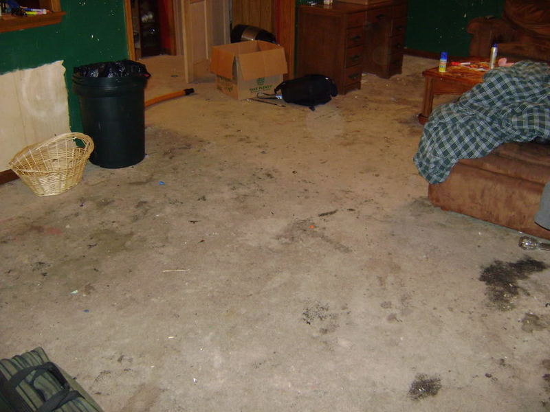

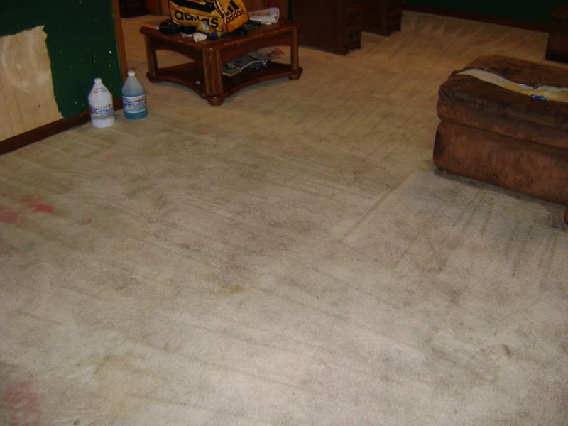

That is one thing I do like about the drimaster.. I can see what I'm getting out very clearly and I know when there is still residue in the carpet or if its just water rinsing clear. Here is a few images :

That was a definate prescrub with a 175.. it was about year and a half ago when the Judson's O2 contest was going on to get a free greenhorn wand. I ended up doing a second rinse with the wand and snapped my final pictures before I groomed it. That disqualified me from the contest. :evil:
This was some friends of ours who basically destroyed their carpet and simply had no money to doing anything to improve the situation. So hoping that O2 system with the old hot sauce modifier could work miracles and asking only fuel money. I offered to clean it up for them.
I kinda of wish I had the new hot sauce Modifier to mix with the O2. Here was the before and after I gave:
This was simply a mercy cleaning and it was definatly a huge improvement over the living condition they had. ( Notice the orange hose in first picture... I had to shop vac the place before I could even vac with my upgright.
I would have done some addittional redremoval but it would have probably takena bout a case of red relief and they were getting the cleanign darn near free anyways.

Looks great David. Can you prescrub with the drimaster
In certain situations yes you can use it to prescrub, but with a weight of 48 lbs it is not as effective as a 175
however if u pull the vac hose and lay down a bit of hot water then make a few passes with it you will see good results, great for flushing that problem area
