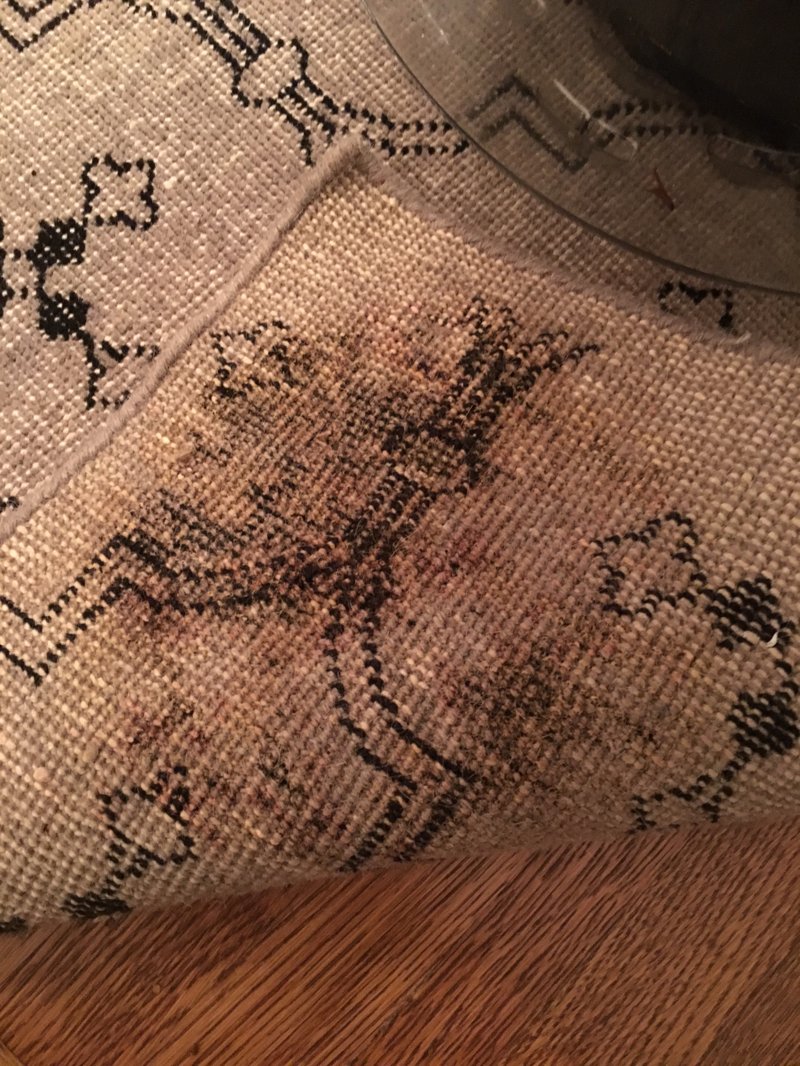

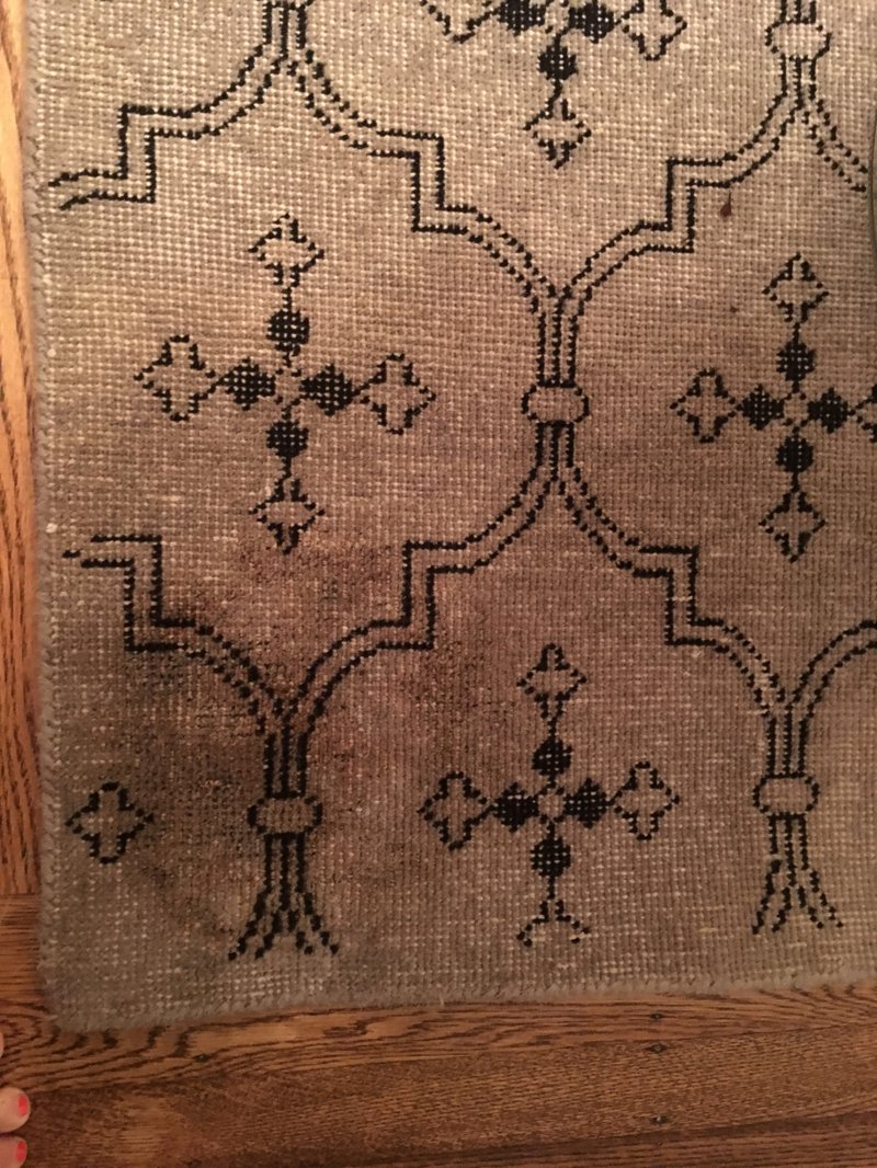

How stable is it still? It looks pretty good from the picture.

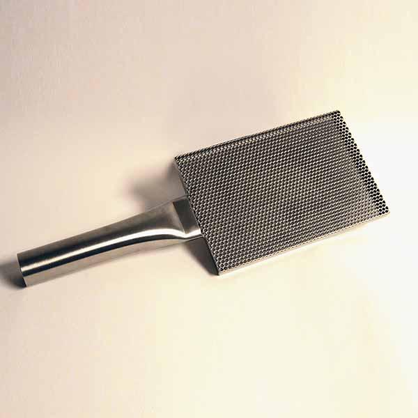

If it would hold for a cleaning I'd clean both sides. You can always use the Sapphire tool and break the vacuum some. Spray with whatever disinfectants Cali allows.
If its not stable the you don't have much choice but to spray and run.

  1. Since structural damage is done, what will a flush accomplish?
  2. Would you spray a mildewcide and then flush?
  3. Does it need to be flushed?
  4. Wouldn't a flush increase buckling (warping)? Not that it's not already there.
We can use Benefect and Microban QGC , in CA, Will these do?
Benefect smell takes forever to go away and I never used QGC, it is lemon scented (I don't know how strong.)
I haven't seen the rug in person.
I like that tool Tom, could you send me a link to the thread in which it shows. I know there's a similar tool by PMF I wonder what are the dimensions and will yours work well for upholstery cleaning situation where the handle needs to be fairly short?
Flush will remove any loose contaminants (digested remains). Milgo might make it a little foamy but yes I'd give it a light spray before and after. Vacuum after you spray, force dry.
You can always use a fiberglass screen until you get Tom's tool.

for the staining, try a little hydrogen peroxide. Small area at a time, let dwell, then rinse. Last step, try an properly prespared peroxide/ammonia mix such Esteam Eliminate or Vanish or whatever 2 part system you have down there. Spray lightly and walk away, then maybe repeat. Not really recommended for wool but as a last resort, I have had some success with that.
San Francisco, CA
I would not try that on an already compromised wool. I've seen wool turn brown/black from Amonia.
And the Amonia will boost the peroxide even more.
IMHO the condition does not justify the risk.
26,930
It's a risk, that's why I say treat a small area first. If you haven't worked with this product before, then don't. Try some on something not so expensive.

I'd recommend flushing/washing it thoroughly. Sometimes a light pressure washing can blast off the discoloration. Post wash I would treat with some anti microbial. Rapid dry. If the stain remains I'd explain how mold and mildew can create permanent stains on fabrics.

1st warn the customer that the mold may have digested some of the fibers and might not be able to be fixed with cleaning. test colorfastness of black dye; if needs to be set use CTI Last Step to set the dyes, CTI also has CCS to accomplish this but I prefer Last Step because it also has Isopropyl alcohol. let dwell 5- 10 minutes, rinse if used. Go to a beauty supply store and get 30 or 40 vol Hydrogen peroxide and spray on carpet. it will foam up which means it is working. Then rinse out with water claw.

I would absolutely not recommend putting 30 or 40 volume on this rug.
If you need to use any, start at 3%
This looks like an overdyed type rug and could easily be bleached out with peroxide too strong.
https://www.centrumforce.com/products/stainless-steel-rug-spotting-extraction-tool
Paddle is 6" X 9" and designed for rugs in mind as well as for upholstery: cushions and arm covers.
