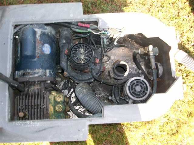

Wanna BEAST up your Ninja? I can show you how to seat in a General pump and get 4 vacs roaring on that chassis. Larry Cobb can hook you up with auto fill/dump, pump, vac motors etc. Cost you a few bucks, but it'll be well worth it and it'll be as new as a Bawb Vawter Steam Genie. They ain't wimpy after that.

yeah if you guys can tell me how to modify it that would be great. I'm sure it'll cost some $$$ no big deal. The closer it can come to a TM is all I want. I don't want him getting redos and I want him to use this thing for water extractions.

Base- General pump, dual 2 stage, on HP, one normal ( Singed, but you get the idea)

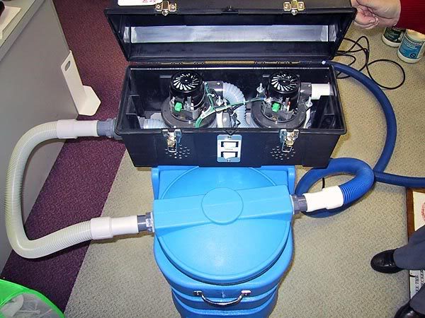

Vac booster. This came from KleenKuip. Same vac configuration, both in series. You'll have to put another vac barb on the head nut you suck dust off the moon. :wink: . Talk to Larry Cobb to get the parts to do this or Ted at Kleenkuip.

Mytee also developed a nice inline booster to help if needed on any long runs. This is the setup I will be buying soon. You can run it from a van with a generator, or bring it upstairs if needed. Since I am in NYC, I need a versatile setup to start my business with. This video may give you an idea of it's power, although it is a 1003dx, it uses the same high performance vac motors as the M-5.
