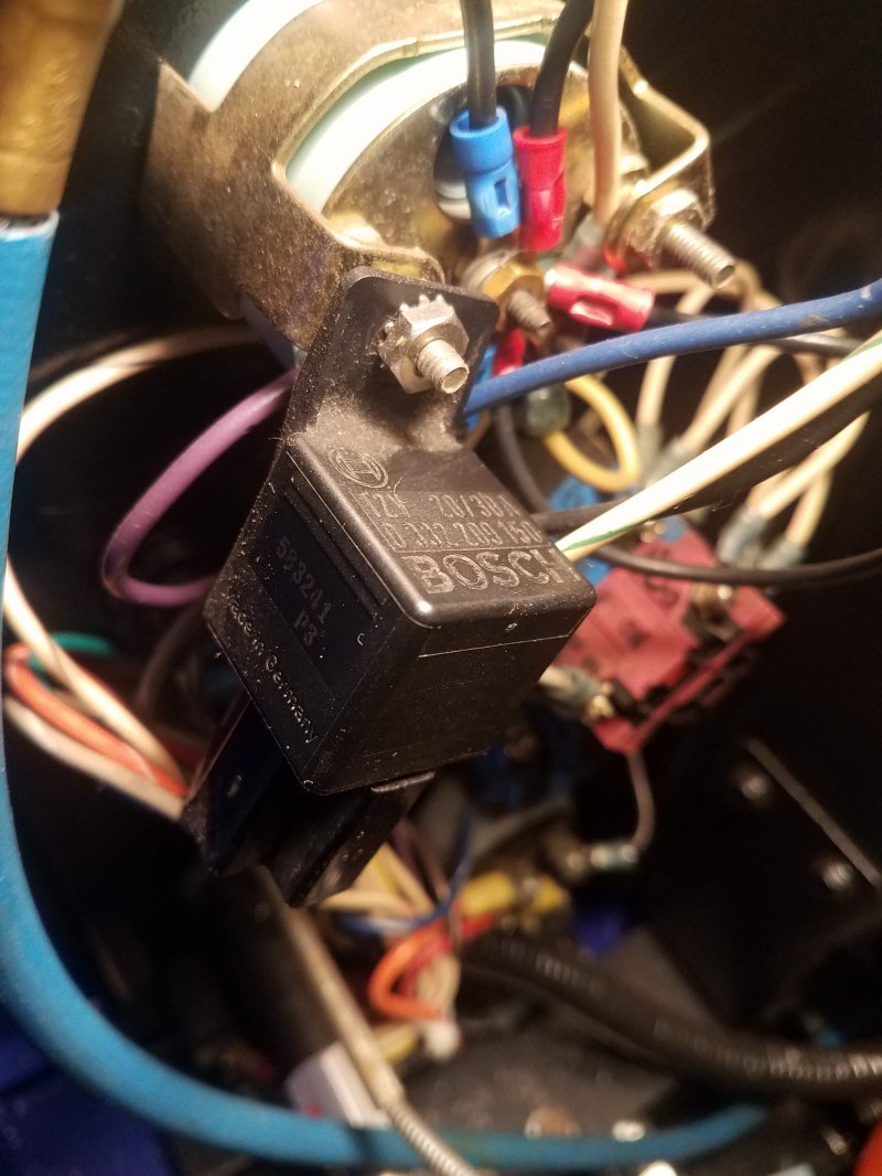

Could be this
relay..

Could be oil pressure switch, or high temperature switch(less likely).. If you ground out your high temperature switch you can eliminate it.. I would start with the relay.

You should be able to feel the relay click when you put the key the the "run" position(not start).. There is a thread here about it.

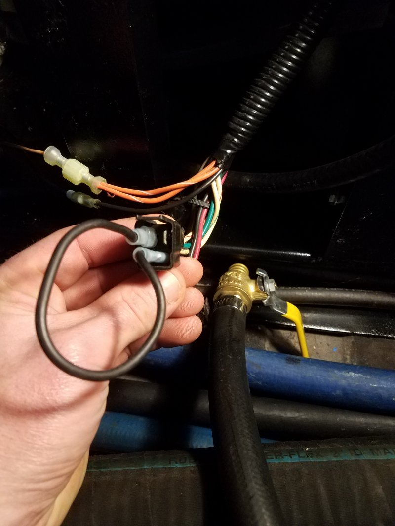

I found that the wire leading to the float valve had been pulled just far enough so that the connectors were pulled loose from the terminals inside the float switch housing. The wire wasn't pulled out of the housing, it was pulled just enough to disconnect it inside. Reconnected it and we're all good.
