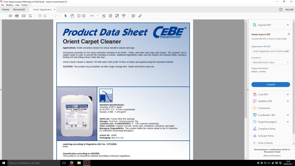

- Mix cold water with acetic acid with Oriental Carpet Cleaning

The chemical you're using looks to be a very low PH product (2.5-3pH) which is OK, but with extraction cleaning most wool rugs can handle a prespray with a pH more in the 7-8.5 range and you may find that it will help remove more soil from heavily trafficked areas. Rugs that you believe may bleed or have color migration will be safer to use the lower pH product.
