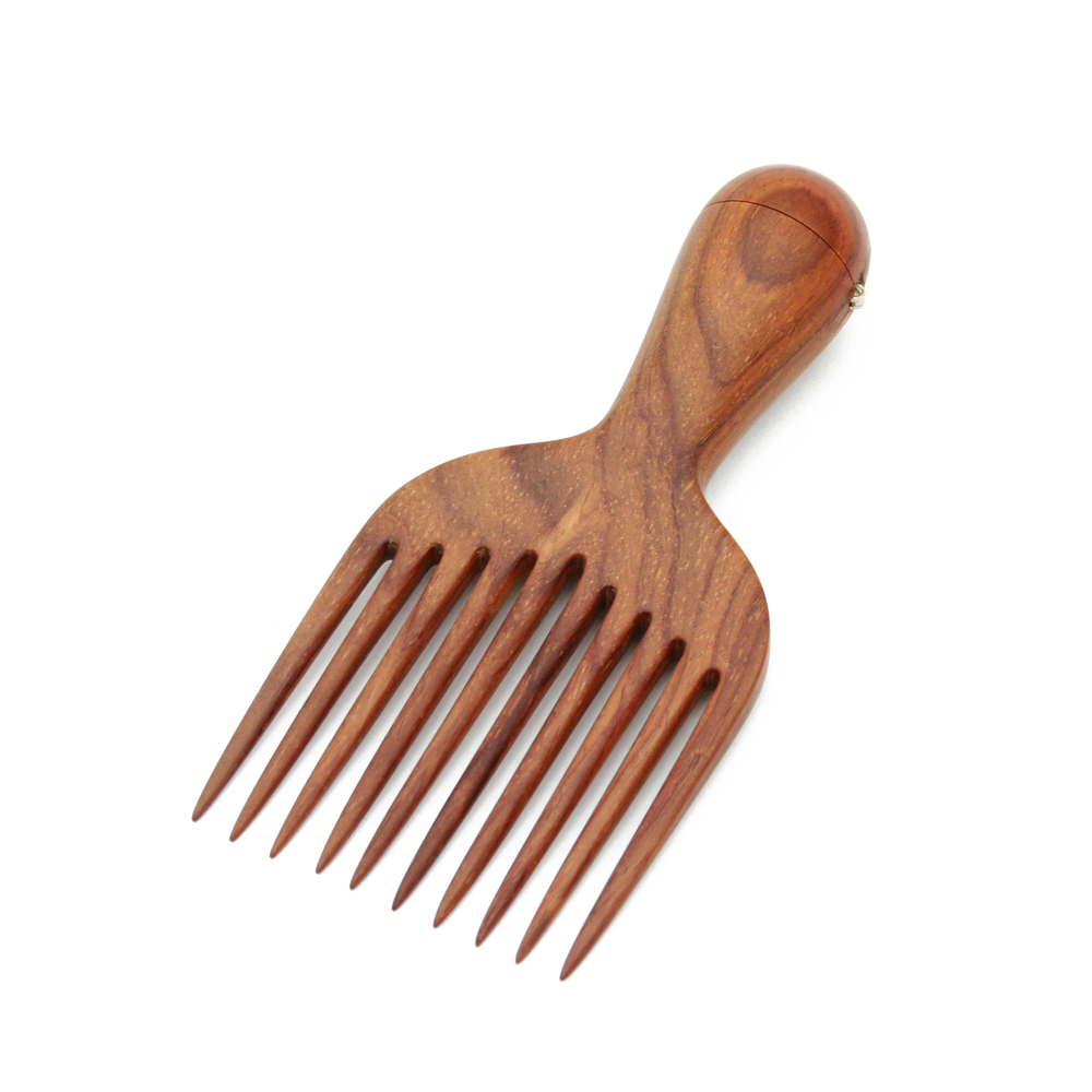

Matt, use a comb to lift and to act as a platform to scrub against.
Lift the fibers and try things in an ascending order of solvency. I recently got adhesive off a carpet for someone using Citrazov (sp?) and it came right out. The comb will help prevent delaminating the backing.
damn good suggestion Swabby!!
Afro combs would be perfect for cut piles
