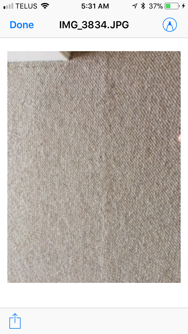

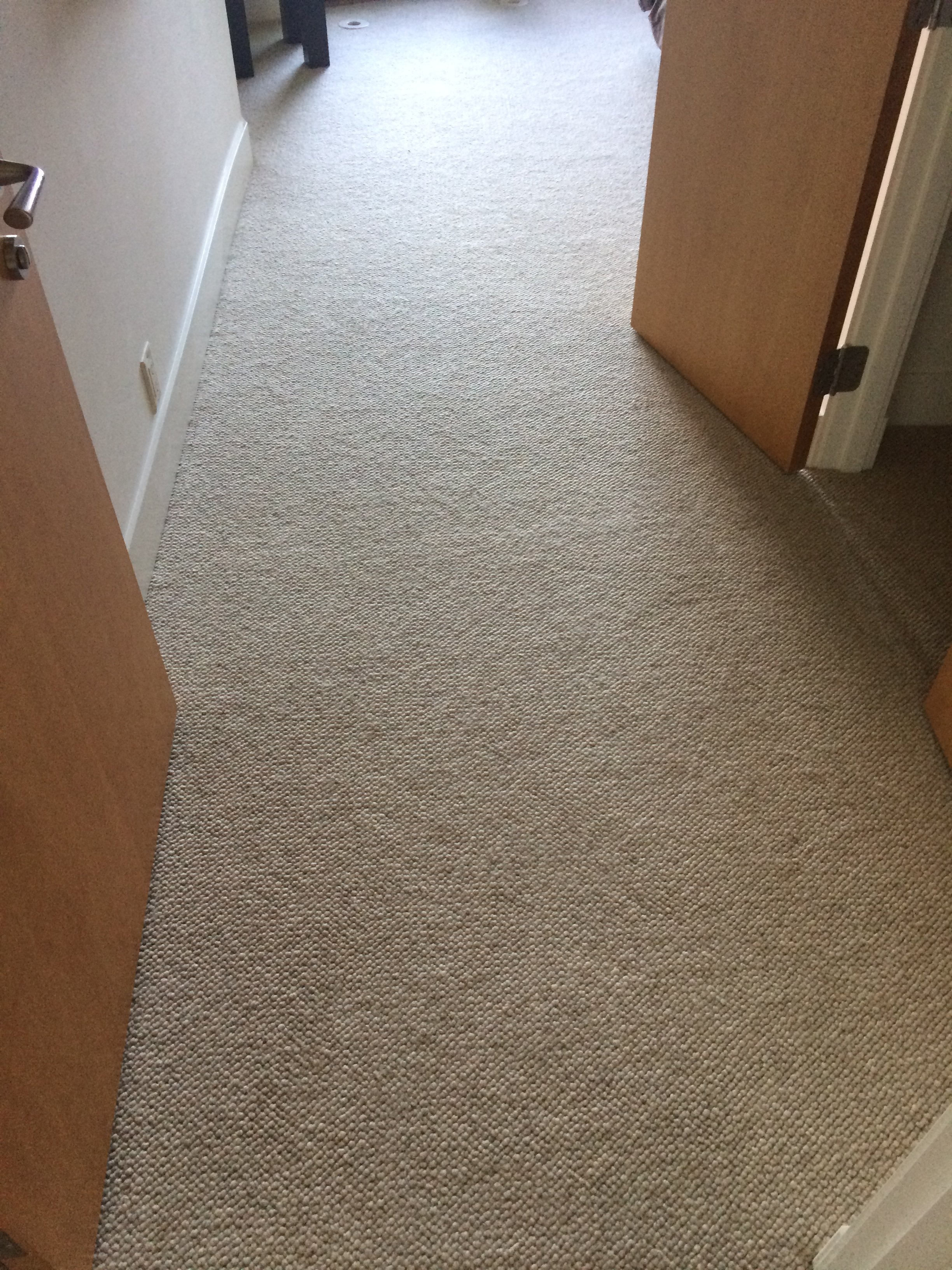

I was hired to remove this wrinkle line by a flooring store. My plan was to use my Wagner wall paper steamer. Does anyone see a problem with this method?

wall to wall wool isn't an overly difficult or delicate carpet
your steamer may or may not provide enough heat to get the backing to relax though, I'd try and put it under tension with power stretcher while I did it
