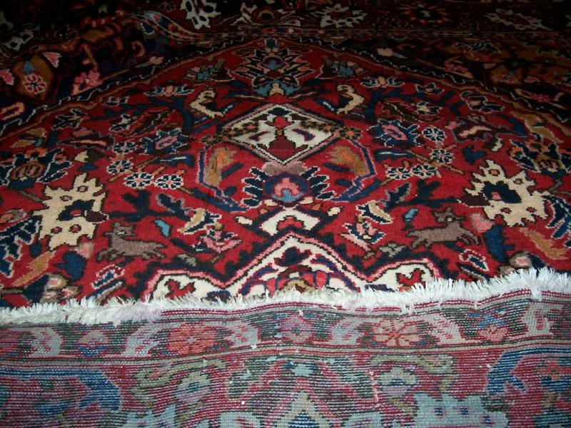

Customer calls wants me to pick up and have it back early next week. It’s on the porch and she isn’t home when I go by to take a look and it’s totally piss soaked. Rugs are not my strong suite. I have really only done surface cleaning. Despite working for several companies, I did not know there were more though ways to clean rugs until I started getting on some of the boards. I know enough to see allot of red flags with this one, so here are my questions:
ID and value? Not looking for an appraisal, but need to know what kind of ballpark liability I have here.
Any special precautions with this one? I have not tested for color fastness yet.
Dusting? Thinking of buying an air compressor. What are the minimum specs I need?
Pit Washing? I am going to try to make a temporary wash pit for this one. Should I per treat the rug with an acid cleaner first? Do I add acetic acid to the wash, or just soak in plain water?

For real air dusting you need a mamoth air compressor and speicilized head which is awful expensive. outsoure this one and get to a class. My guess would be a Lillihan but its hard to tell with out seeing the border or the side. I'm sure Randy will be along shortly.

Ace, I would take that rug back immediatly. Here are your problems. Number one regardless of make of rug, it is a hand knot oriental and even it if doesn't have the greatest value, the value of cleaning is not linked to how much its cost but how long it takes. You have look at a number of factors. Number one is dry soil removal. You need to get all the grit and crap out before thinking about pit washing. Secondly, are the colors going to run. That is going to depend on the age of the rug and type of dyes. And you can't rely on dye testing. Its not full proof. You may have the cleanest dye test in the world and yet the instant that rug its the pit its like a dying cow. And to add insult to injury, the rapid shift the pee pee took from the acid to the alakine can loosen completely stable dyes. So if you can't set the dyes completely, can you correct this.. (again more time involved in dye stripping). Now you have the pit qualms, to get all that urine out of the rug, you are looking at a minumum 3 hours and maybe more depending on severity. The water might need changing as well so your looking at about 100 gallons of water minimally. Then there is fringe detailing and stripping if the cotton fringe soaks up loose dyes. Final grooming, and final vac. Add pick up and delivery time as well. So your looking at 6 man hours minimum with this rug. At 120, you just made $20.00/ hour.. Sometimes its better to pass, either make the lady understand that your time is worth something or tell her to have another cleaner ruin it.

P.S. its not a lilihan, I just sent it to one of my mentors. If you could take a photo of the entire rug and then the back side of the one of the corners so we can see the edge and fringe at the same time, we can positively ID it for you.

With much effort I was finally able to make out the script on the tag. It's a Bakhtiar. It has a Momeni mark. She says she got it recently at a large retailer which did not make any since until I learned that companies collect old rugs clean them in Iran and ship to the US. Any guess on age or value?

If you post or email me size, and a few pictures as well as note any wear, or stained areas I can have one of my appraisors give a ballpark. It is not a fine piece at all and is not very marketable today as their is a glut of used Persian rugs in the market.
