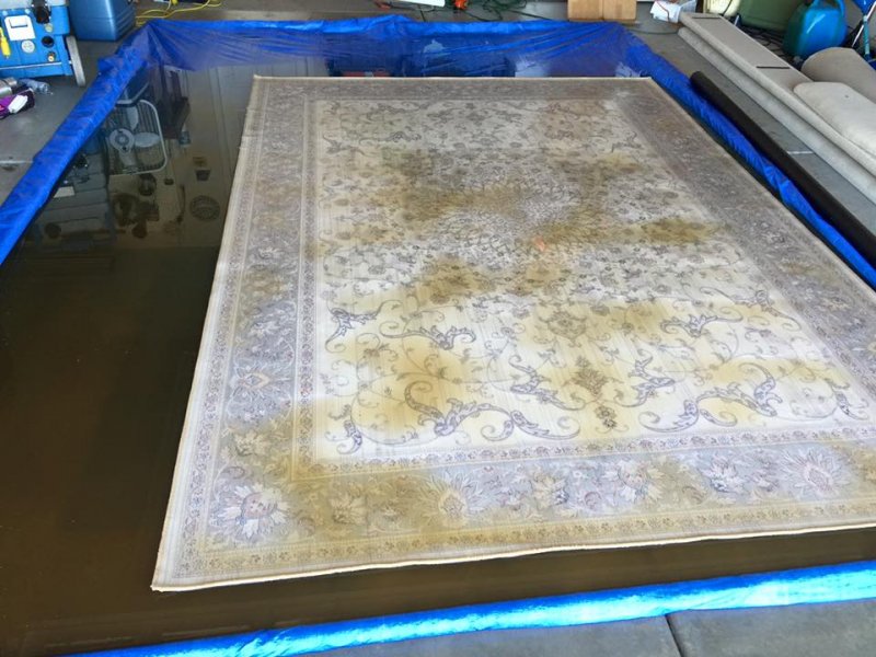

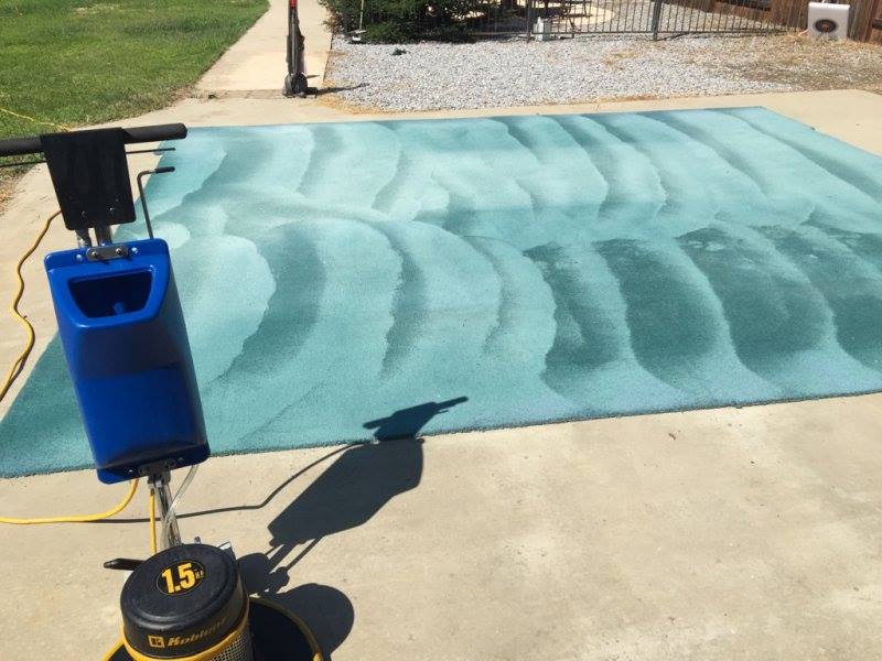

I'm very lucky. I have a large cement slab in my backyard that I clean area rugs on. When It calls for it, I make my own rug pit out of PVC and a tarp. Don't over think it guys. Below are pics of both. Look at all that urine that came out of that rug!
