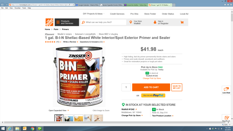

You are going to want to seal paint everything (Walls, Ceilings....) with Zinnser "BIN" Primer Sealer....Kilz will not work....
That is as soon as you remove all the odor source you can...
Reason Zinsser "BIN" Primer Sealer works better is be cause of the micron size of the Shellac used in it.
Kilz is a .015 micron size....Zinsser "BIN" is a .005 micron size....it is going to have a better chance of keeping those odors sealed in especially during humid and hot....
Now...Zinsser makes a lot of products...SO IT MUST SAY "BIN" ON THE CAN or you are wasting your money....
And it is smelly to work with....the white coloring in it is just a coloring so you can see where you have been...Stir...Stir...Stir....
http://www.homedepot.com/p/Zinsser-...ot-Exterior-Primer-and-Sealer-00901/100398381

What Mark said is spot on. We used this product on a house that was badly stained (46 years of heavy smokers). It worked really well on all the surfaces which were wallpaper, soft fibre ceilings(Pinex), hardboard and timber.
