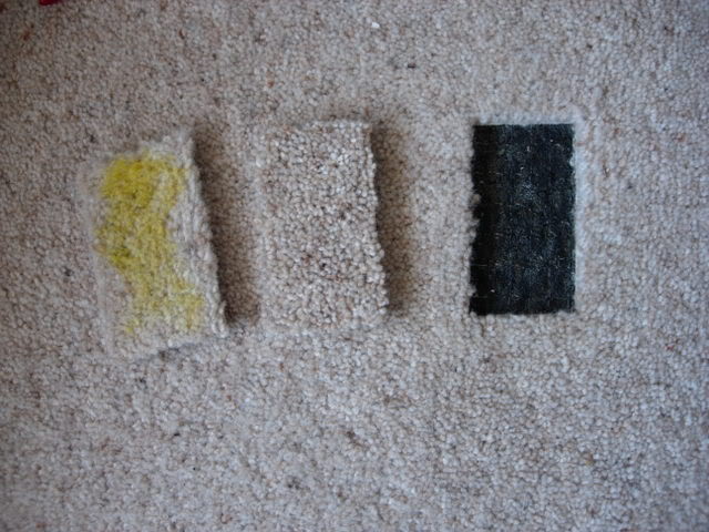

I knew I had a job a few months ago where I had done this but couldn't find the photos. Got them now.

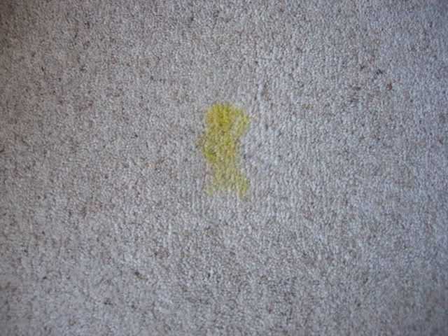

Stain was not treatable at all and he didn't have any off cuts.
I cut the stain out of the room, cut the exact same size out of the inside corner of the wardrobe and swapped the pieces.
The area was aggressively scrubbed and had a lot of fuzz, I trimmed this when I had finished.
The two pieces.

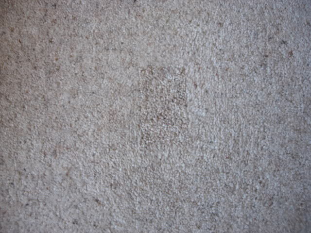

Finished... yeah I know, should have had some crayon or chalk.
Client was wrapt with the results, his wife was away for an extended period due to family sickness and was coming home and he ended up getting me to do $4-500 of other stains and repairs to get the place spick and span again so he didn't get in trouble... paid cash and wanted the invoice put straight in the bin too :wink:
