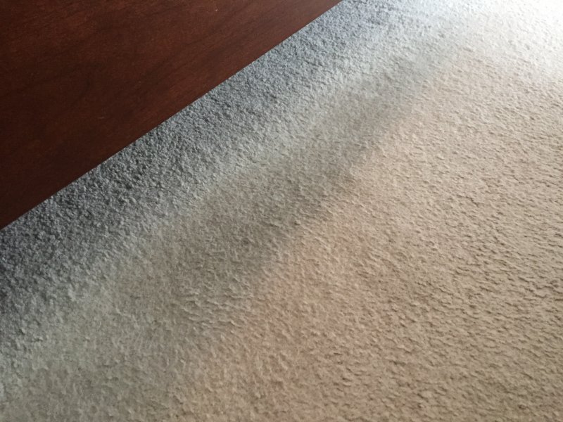

Many of you have discussed the stuff. I cleaned a house yesterday that was so felted down and unfluffable ( word tm pending) that it was a frustration. Look at the three zones; under the bed, beside the bed and the adjacent trample area.
Is this Smartstrand?

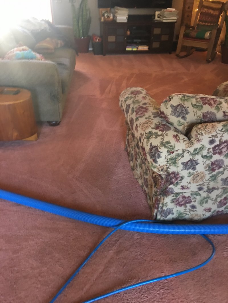

This is smart strand. Customer paid a fortune for it it a little over 2 years and that how the seams looked the day it was installed.
The first two time she said clean it with water only, it's got a 25 year warranty. Don't use any chemicals.
I still used Procyon plus.

I ran my CRB over it dry, to try lifting the nap. Presprayed generously with DS2, then scrubbed that in as well. Let it dwell while I extracted the previous room (which by nowhad time to dwell) and sort of leapfrogged through from room to room. But this stuff looked like squashed felt. The yarns were totally undone in the worst traffic zones. It cleaned up pretty well but took some doing and though it appeared clean, was a mess physically and looked like crap.

How old is it? Maybe send those pics to the dealer who sold it to them?

That's the worst... I will say that the hard brush on the 10" crb will do more to pull up/open up that crushed area but it will possibly also pull more fiber out. (I started doing it even with the fiber loss...you're not creating damage at this point- you're improving visuals)
I keep fighting this crap and explain over and over that it is what it is..worn pos. I also made a point last week to a customer that (their salesman that told them it will clean with water only) there is no way on earth to put the individual pile twists back into that carpet. And no matter who, with what kind of equipment- it will never look the same as what it is where it isn't crushed. Couple year old carpets looking like that and of course customers looking for us to "clean it back to normal".
Impossible.
Carpet salesman should be required to be in our field for a year to experience how these carpets perform. They'll never sell another ounce of these.... After seeing them in real life and not just a swatch.
