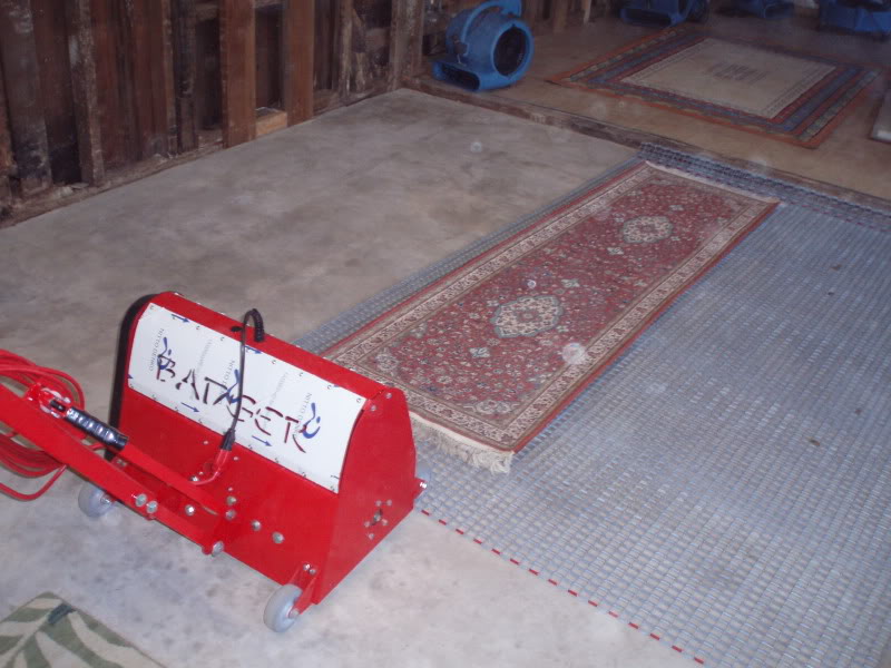

I used mine for the first time yesterday.
2 by 7 wool runner. Didn't really look that soiled at all.

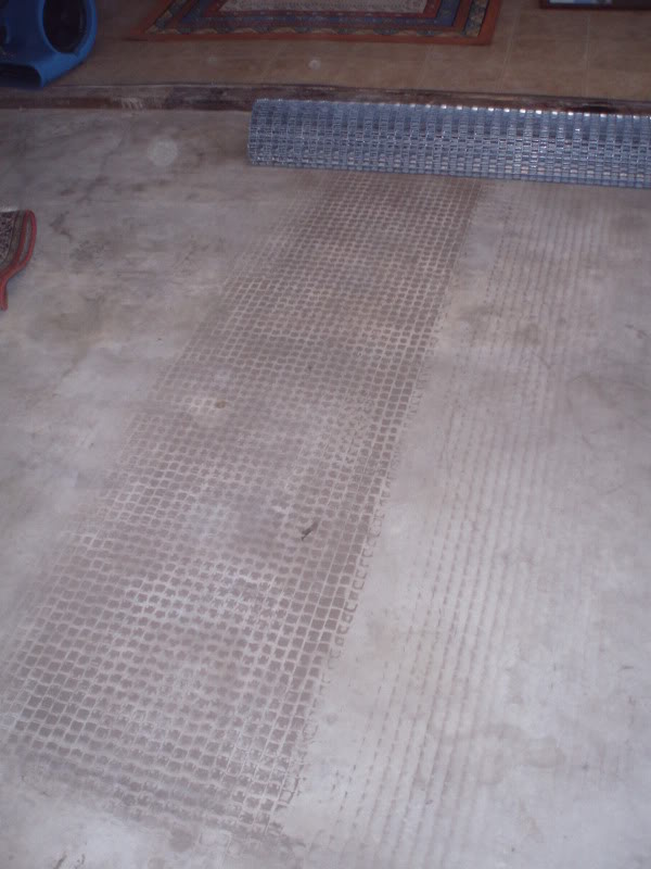

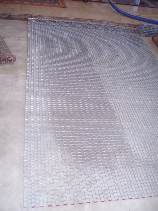

We Sanitaired it front and back then ran the Rug Badger over it for about 3 minutes.

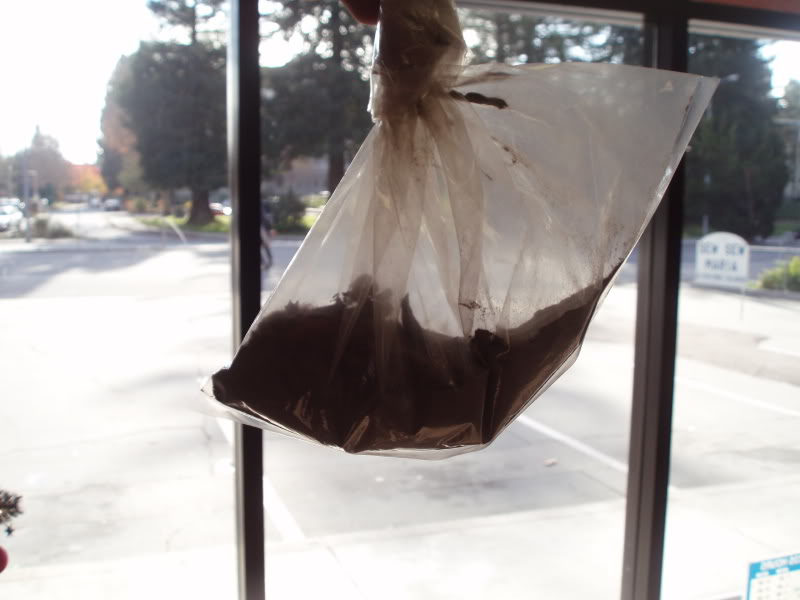

So much dry soil came out the first time that I swept it up and did it again...
In the end this came out of a "clean rug"..

Yea it's pretty amazing.
When we first got our we pulled a few rugs off the clean rack and hit them with the badger and showed the guys how despite being cleaned by us there was still soil trapped in the rug.
