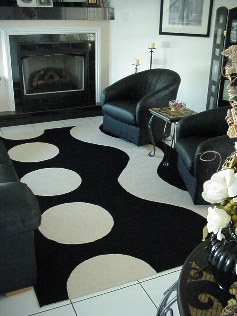

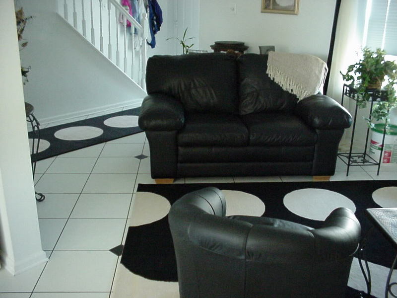

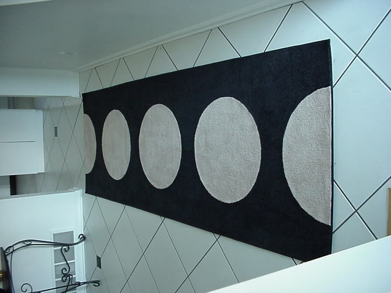

These pictures are posted only to show others that they can do this type of work, too. This was my first and only attempt at a custom rug, but Steve sparked the fire last night. I charged $350.00 for 2 hours worth of work.
Parent Rug already in Living Room
Custom Runner in Foyer
Parent Rug w/Custom in Background

I made a cardboard template for the circles and traced them onto the backing of the beige carpet w/marker. Used a carpet knife to cut them out (new blade each circle). Did the same with the black field carpet. Latexed both edges. Inserted the beige into the black and seamed together w/a borrowed KoolGlide. I then flipped it over and latexed a muslin cloth to the backing to hide all of the seam tape. Sent it out for binding around the edges.
List of Tools:
Cardboard
Marker
Carpet Knife w/Blades
KoolGlide w/Tape
Latex
Seam Roller
Seam Weight

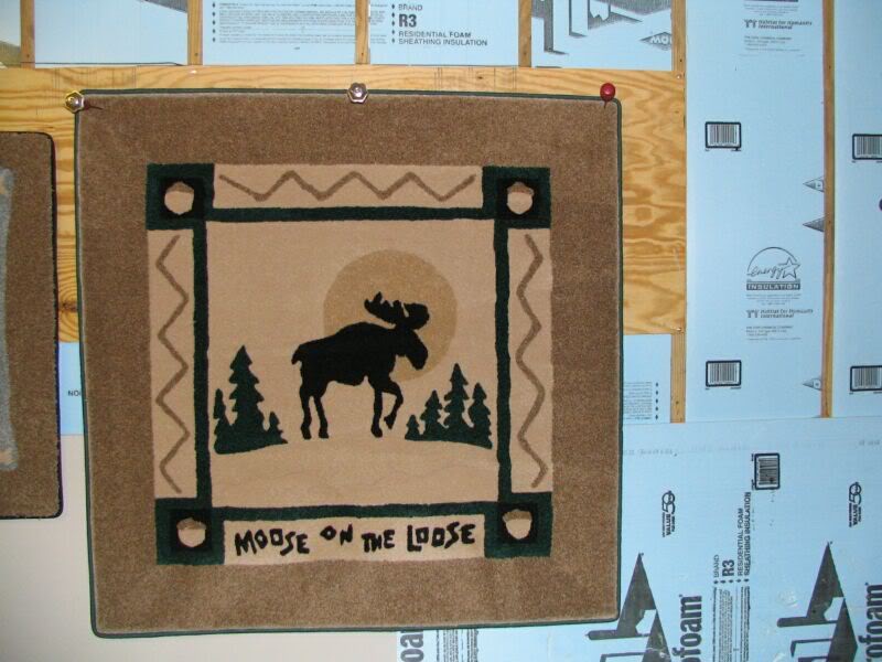

Here is a shot of a rug with the binding on it with serge style, I am not sure if you can see it clearly or not but it is on this, it was put on by hand with a glue gun.
