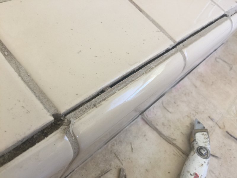

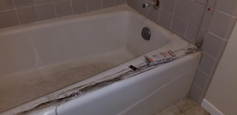

I am curious; once you scraped the caulk with a razor, what did you use next? A solvent, or a 3m eraser wheel?

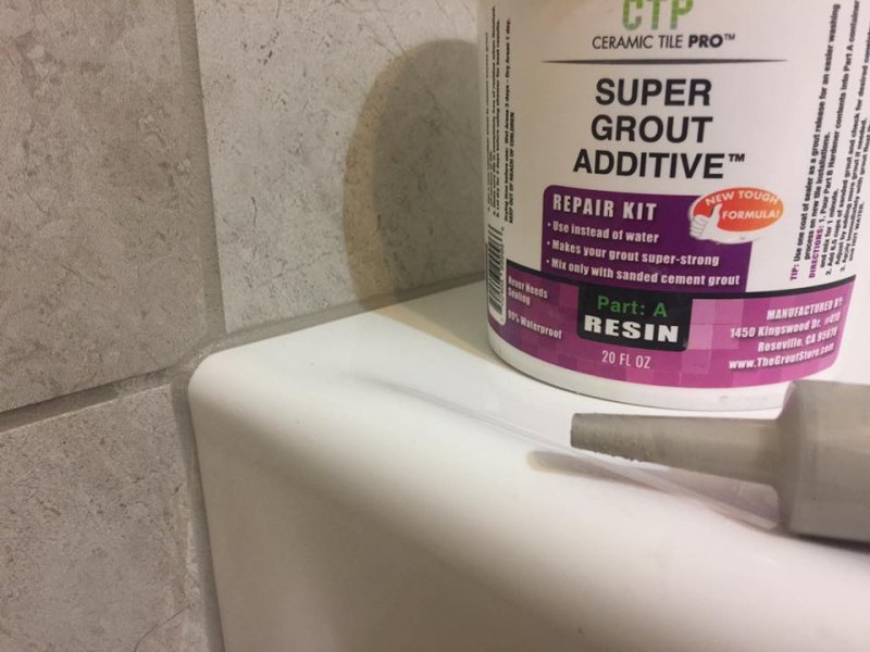

It is not flexible, it’s just the opposite, extremely strong but if you have excessive movement it may not be your answer. If you can easily move the tub or similar suggesting that it wasn’t installed securely, I would let the customer know about that and let them decide if they want to use caulk that may develop mildew issues or the epoxy which may develop a hairline crack that you may be able to fill-in.
It does do a great job on any and all corners with minor expansion contraction without cracking. It is a good idea to vacuum any wet areas to allow the epoxy to bond properly. I don’t know if it allows vapor transmission but can ask my chemist and let you know.

I have only needed to do that a few times but in the thousands of showers I have re-caulked/now re-grouted with SGA and every time there's been a consultation with the client that "this gap is huge and I'll do my best"
As far as this product not having any flex it has not been an issue whatsoever...yet.

Nice job on the shower @Mikey P .
I would have used Spartan Foamy Q&A to get all that crap off from the door frame.
I don't do a lot of re-caulking but would have just used some clear silicone. Easy 'nuff just to fill the bigger voids as you go along and the appearance is very forgiving.

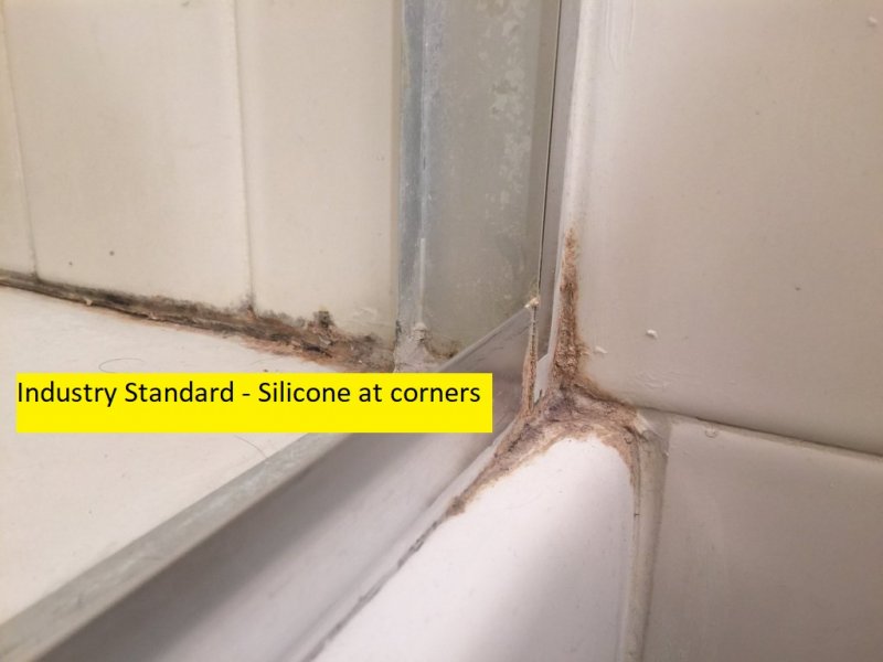

@GreenTechAgain , Benefits of using Super Grout Additive®
  1. No more call backs on issues using caulk/silicone such as mildew/mold, not bonding or peeling away, cracking or becoming brittle.
  2. charge a premium for a more professional repair
  3. Very little product is needed. As little as 1/2 kit or approx $15 per repair for a $175+ job.
  4. No chemicals needed, cleans with warm/hot water and microfiber towel.
  5. Mix any color grout so very little waste vs buying individual tubes of caulk for each color that may expire before using the complete contents.
  6. Easier to apply than 100% silicone
  7. Outperforms "Industry Standard" per TCNA hands down

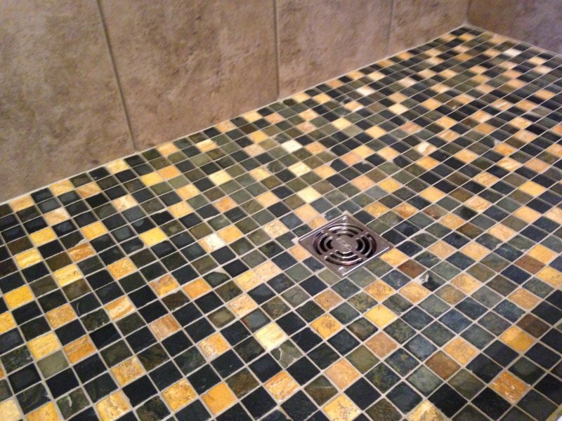

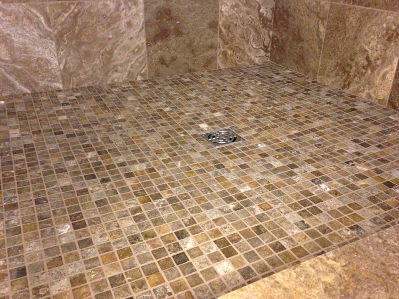

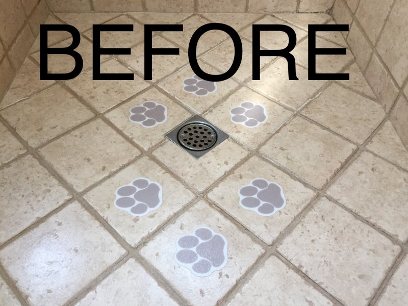

Since Super Grout Additive® is a true Epoxy, you can grout complete shower floors too.

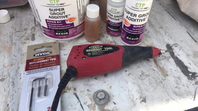

@Jason Pettinato Ive been watching a bunch of your youtube videos for a while now. One question I had was for removing old grout. In one video you removed it very easily with just a razor knife on some unsanded grout, if it doesnt come out that easily what is your tool of choice?
I saw one guy on youtube with a multi tool that he attached a shop vac to which seemed pretty fast and no mess. What do you think about the other electric tools? do you prefer to just remove by hand?
Its always a pain kind of for me, looking for a better system that is faster and clean as possible
Oct 12, 2017
26
Roseville California
Jason Pettinato
@Acp , for unsanded or tight joints you can use the Hyde Regrout Tool with the pointed bit. Sanded or joints 1/8”+ a makita 4” angle grinder with diamond blade but that is very dusty and you have to be careful not to damage tile.

The muti tool rocks. I have a Fein tool and you can adjust power but I'm sure any other MT would work. You can buy diamond grout cutters in an assortment of widths to match the job. I do the clean out or grinding with a shop vac running at the same time to catch the dust.

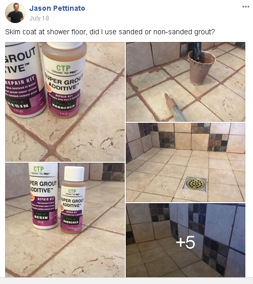

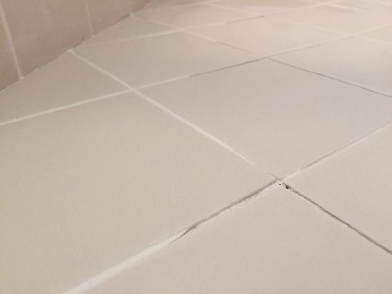

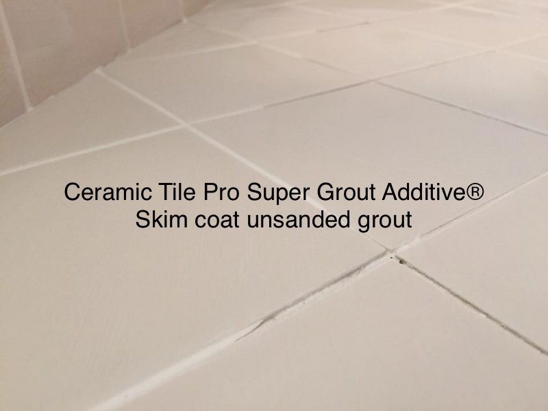

How long has your product been out?
How many shower floors has it been tested on and for how long?
The skim coating idea has me thinking...

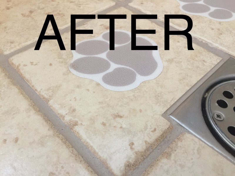

@Mikey P , Ceramic Tile Pro Super Grout Additive® has been out for over 6 years. I have personally tested it in my own bathroom at shower floor perimeters and vanity counters where tile meets backsplash. I was always having an issue where the side wall of the backsplash would continually crack. There was a pocket door on that wall so there was very little support and you could move the wall back and forth with little effort. I noticed that the epoxy grout was strong enough to withstand that movement and years later, it never cracked again.
You can skim coat over CLEAN grout. I will offer this option to my customers if the grout is badly damaged or just won't come clean. I specialize in shower restoration work so most of the repairs are shower floors which happens to be one of the hardest areas to restore. We all know that.
