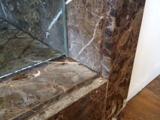

That's after using the cal clean? If so it would have gone away once you sealed it and applied cal block. The higher the calcium content the more that will happen. Mike with DwellPro can share his pictures of a marble shower. Yeah marble..that turned completely white when he was testing cal clean. He was supposed to test a small area, which he did, the sink. When the sink came out great he just sprayed the whole shower. the damn thing turned nearly completely white. Scared the shit out of both of us. Made a bunch of calls and then had him apply the sealer and then cal block and BOOM amazing. You should have called me when you used it

white foaming is usually reaction of acid and calcium...
looks like the whole shower was etched and then enhanced.
So I would put a drop on a piece of marble/limestone or trav before you claim non acid
Calling Advanced to get there info as the MSDS doesn't answer what I thought as it is proprietary

Plan on re-polishing that shower, the enhancer is going to wear off soon & the acid damage needs to be properly FIXED.
A retiling might me cheaper & easier sadly.
Hit the weight room to bulk up your shoulder & arm muscles, they will take a beating after a week of polishing shower walls.

Jim is wrong it did not ETCH the marble. it pulled calcium to the surface (efflorescence) but it did not etch or damage the tile. As for the answer as to the concentrated ph 2 on the MSDS sheet and the claim of being an acid free calcium remover waiting to hear back from the manufacturer. I was out of the office yesterday. Mike with dwell pro will can tell you there has been no ill effect long term as that shower was done a year ago and it is his regular client and that is a hotel shower so heavy use. Mike I sent your picture in as well will see what they have to say about that but I'm sure of you sealed then cal blocked that sink it would have been amazing

I rather be wrong assessing a situation over the internet then using that product on clients stone, its a "stay away" product for me, the shower pictures & story don't add up & not worth the risk.
That statement makes no sense at all.

John, I'm wondering about the same thing... If it's calcium coming to the surface or as you say efflorescence, how is that not damage to the surface? The surface is or was supposed to be very smooth so the light reflects. If that is efflorescence then the surface has to be somewhat damaged. Am I wrong?

Here is the answer from my sales rep. I asked him for a better clarification from the chemical engineers that explains it better as under ph7 is acidic.
"John, Cal Clean is non acidic and the only reason it's a pH2 is because it attacks calcium only. As you know Mike in Aspen thought Cal Clean had etched the marble and it didn't.
We think that since "concrete" has so much calcium in it to begin with that the customer is seeing and feeling the remains of calcium on top. I do have to say that the directions say that a small test area should be done first.
Our recommendation is to clean off the counter top with Floor & More and when the calcium has been removed use either our Enhancer or Stone sealer.

Ok talked with Justin at advanced. Cal Clean is NOT and acid. It is Acidic but just as a lemon is not acid nor is coke and acid they are all acidic. What happened on the marble shower and to the concrete was in effect the calcium being brought to the surface. The calcium should cone off with a neutral cleaning solution Like their floor an more (amazing product neutral degreaser) Then sealed with either a stone sealer or enhance and seal. If the marble was etched no amount of sealer would hide etching. Isn't possible as etching is damage to the surface and it would enhance that damage NOT hide it.
