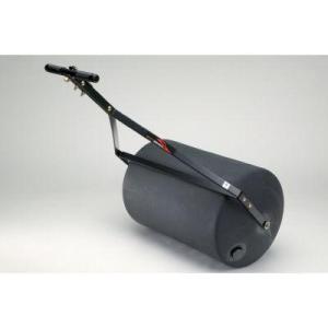

do this I guarantee it. or I'll give ya yer money back!
go to the store get a box of the cheapest powdered laundry soap they have usually about $1 a box
fill the pit to about a inch over the rug w/warm water
add 1 cup of the cheapo detergent to a 5 gal pail of warm water
dump it in the pit, agitate w/a Cimex or like tool
get a plastic lawn roller, the kind ya fill w/water for weight...
roll the #%^&! outta it!
drain the pit, rinse till the water runs clear, then rinse some more, then one more time for good measure!
as long as you rinse till the "yellow" stops running, it WILL work.
have done this to a cat pee soaked wool 1 inch thick, 9X12 Chi Ori, had to do it 2x, but worked like a charm, having said that...
even at $5 a sq ft, it's hard to make any money doing it!
Definitely not worth the time on a syn, but I understand you started the job, so finishih it, been there done that... good luck.
let us know how it turns out
