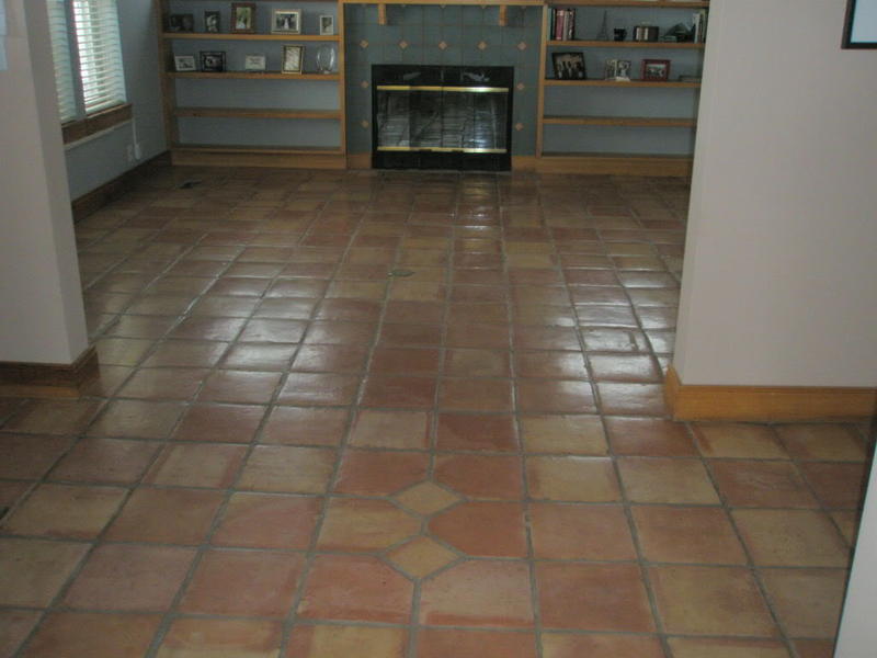

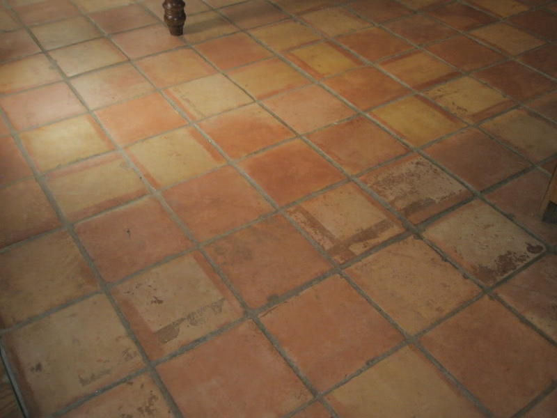

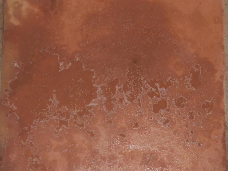

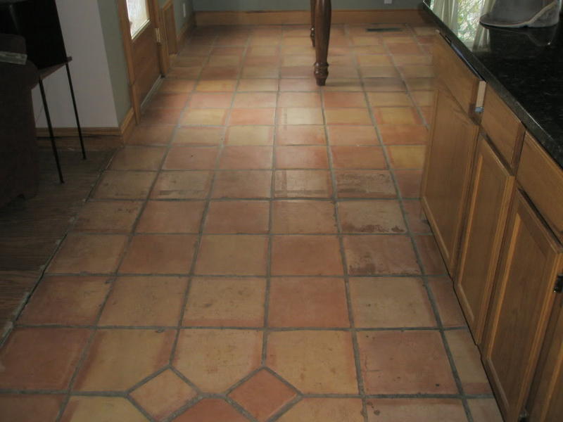

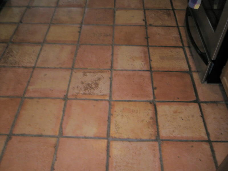

This was non factory finished saltillio tile. Be very careful, this is the first saltillio that has give me a problem. At first look every thing seem to be standard.
after stripping i noticed we had a problem it was ployurithanie omg what a fricking night mare.
