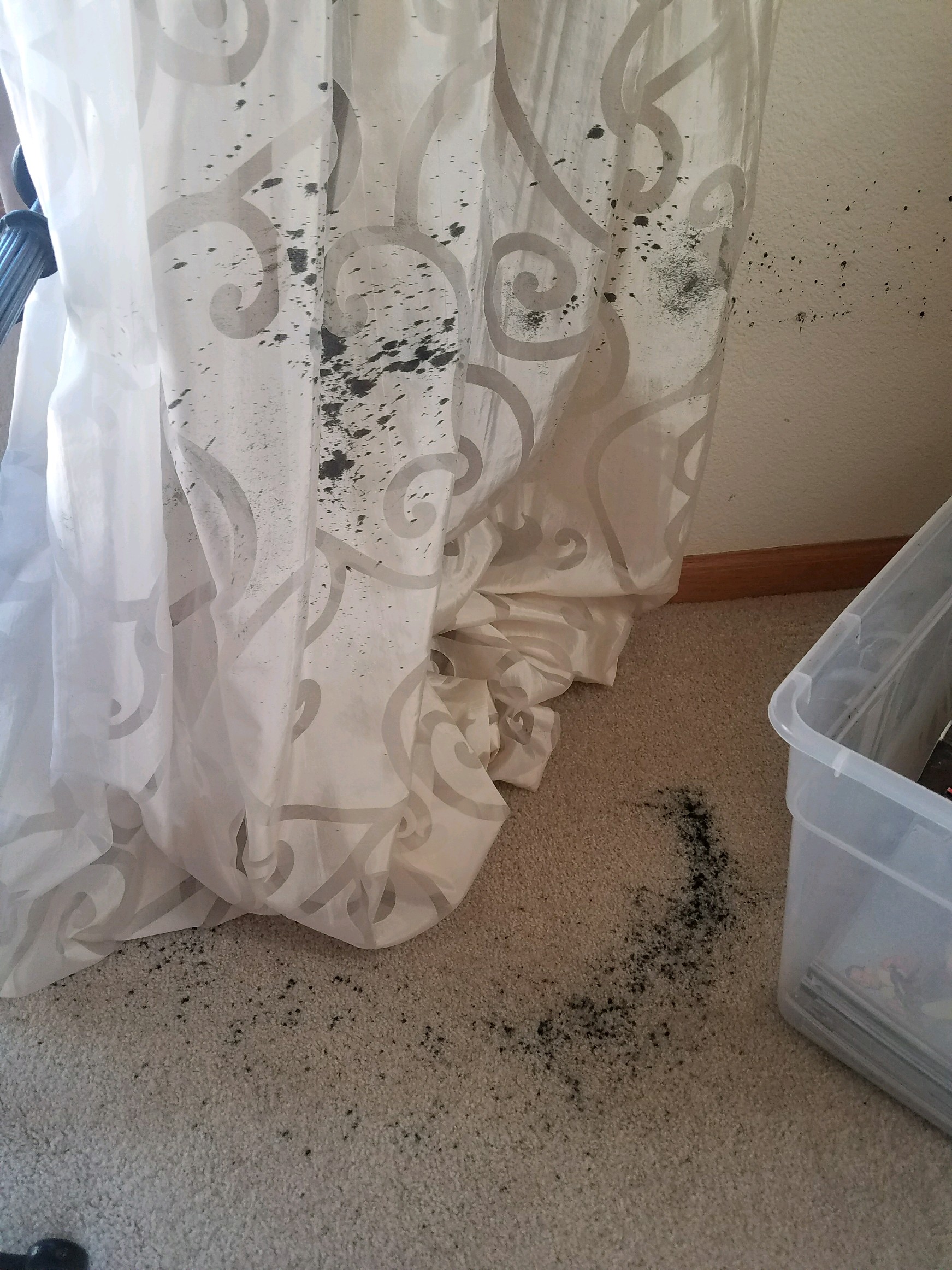

This was sent to me from a local customer and acquaintance just this past Friday. I brushed him away but told him I’d consult with my carpet cleaning buddies online.
I’m not going to make this guy happy while making it worth my time/effort/chemistry, am I?
I asked him if he knew what the fabric was but haven’t heard back.
I really don’t like jobs like this.
12,021
If you are asking about the draperies I agree. If they are synthetic, he can wash them. If they have natural fiber content, they might shrink when wet cleaned, which will be needed to remove that damage

Do you know what the staining material is?
Reactions: Russ T.
26,927
The draperies might be salvaged by a qualified dry cleaner. That's a lot of ink to try to remove from a carpet but you could always try chemspecs water based ink remover. Always at the owners risk.

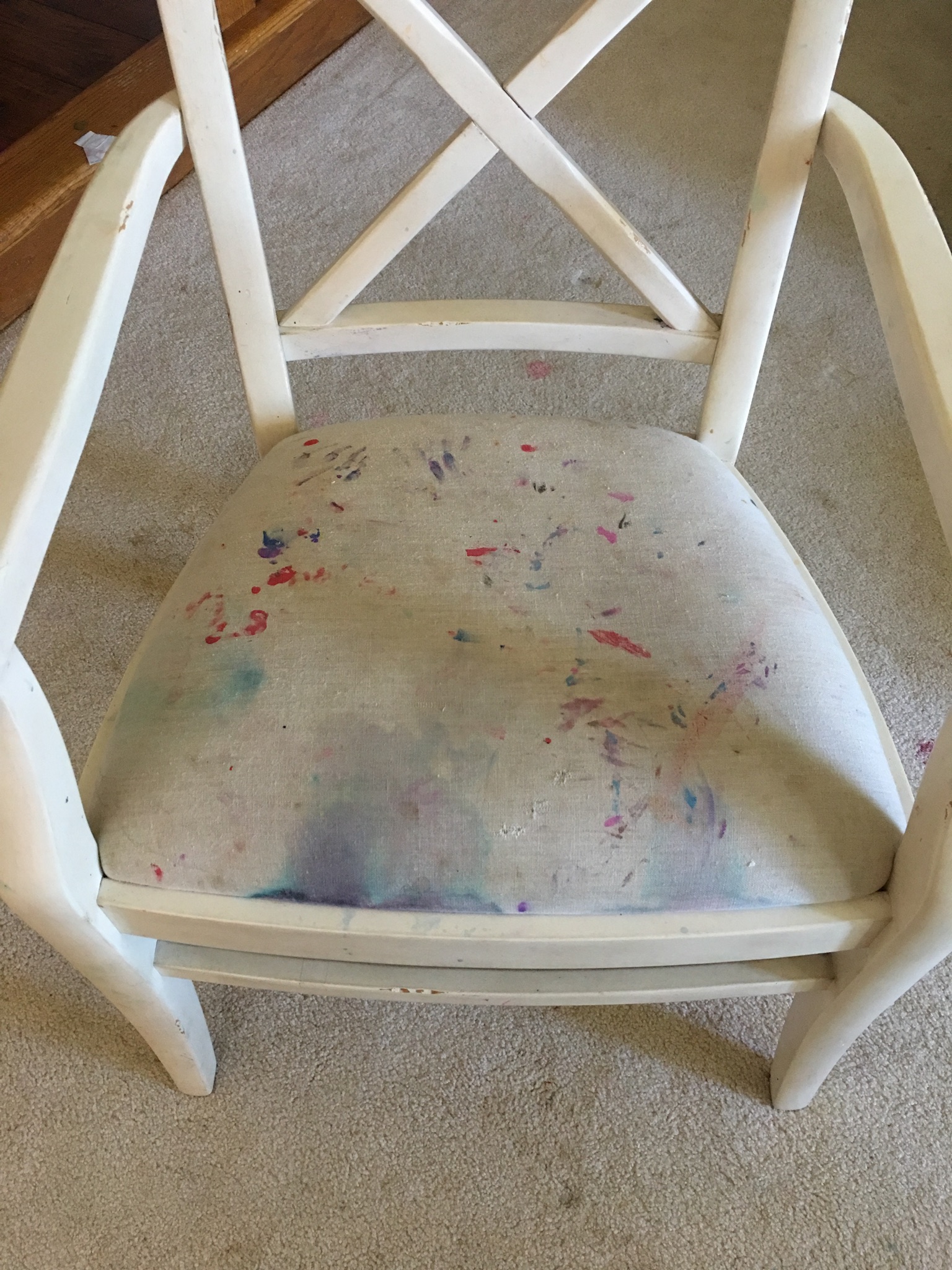

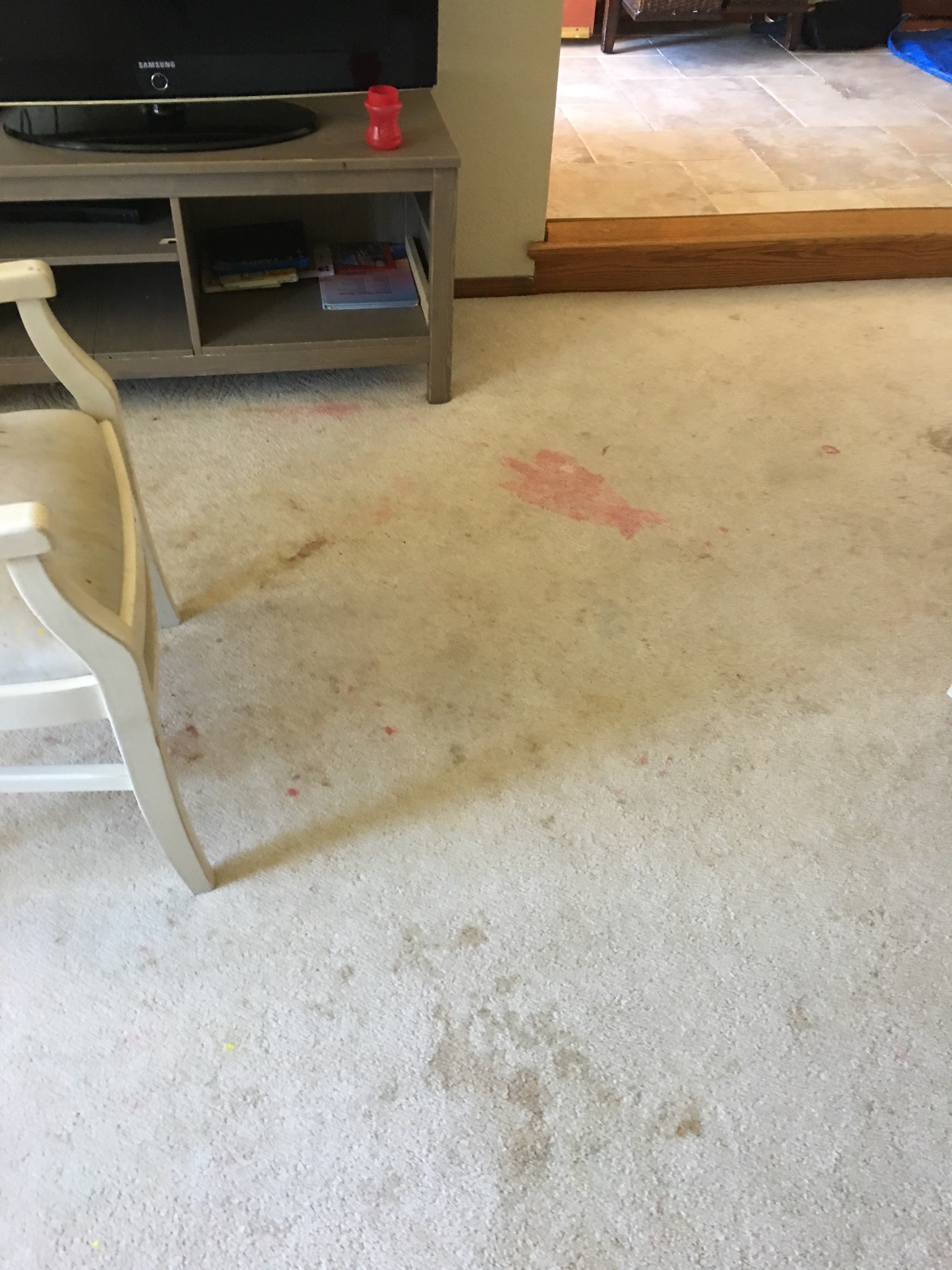

Sam, can I use that picture for training purposes? That's a great one!
Of course.
I do the the Mom’s house the three kids houses.
This was one of the daughters houses.
Her husband says it’s just washable finger paint!
Most of it came out.
