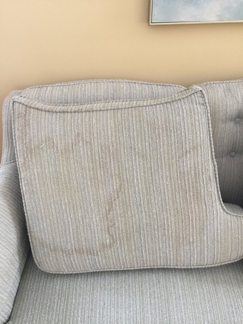

I was at a customers home today to clean 3 chairs. She asked if I could take a look at the sofa cushions. When I asked what had happened she told me they were cleaned by another cleaner in town. Not once by she had him return 3 times to correct this problem. He must of soaked these. Wow amazing that we have these guys floating around out there. Well this particular cleaner went belly up last year. Go figure. @Jim Pemberton I know your going to chime in here. Rant over.

Doesn't look like flame retardant, looks like it was left to wet. Looks like Herculean to me. Regular prespray with some peroxide should fix it. You could acid rinse for good measure.

Just flip the cushion... We actually get the calls to correct other cleaner's problems... Some cleaners just don't care.....

Could be that there was some really large spill that is still down in the foam. Any amount of moisture will let it wick up. ?

Im thinking he may have poured an odor treatment or something .. certainly looks like a wicking dry pattern !! Id try spray n brush then towel off at this point !!

Open the cushion and look at the foam. It may need to be soaked and dried a few times in some type of urine treatment.

Did the spot never come out, or did it reappear after each cleaning? I have seen wicking occur on synthetic fiber furniture fabrics just like we see it on carpet. The above comments about checking the cushion foam are spot on.
I wouldn't hazard a guess without asking that question first.

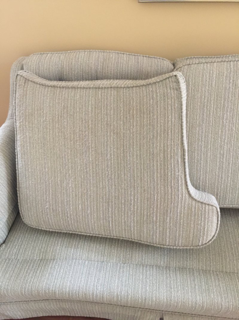

This is the before and the after is a week later. ( I returned the customers area rugs) The spot was a water stain from over wetting. I used an upholstery Prespray with a sodium percarbinate booster. Air movers setup for drying. Before I left I misted esteam 2 part vanish. I'm pretty happy with the results.

You might be pulling out the big guns before you have to. Rather than sodium percarbinate and hydrogen peroxide, (both of which are bleaching agents) you might try esteam browning treatment, spray it on coarsely and use a soft brush to agitate. Rinse with a neutral to slightly acidic detergent and light spray again with the browning treatment. This appears to be cellulosic browning which the browning treatment was designed for.

I understand the browning treatment. I have to admit, I've never really had great results. But I will give that a try in the future. Thanks for the tip

First it is important to determine if it is browning or just a ring from soiling. No need to bring the heavy guns if not needed.
And many times, depending on nature of saturation, it is not really necessary (check underside of fabric and cushion.). At times a good rinse, toweling and fast drying will do just fine.
While true- percarbonate is an oxidizing agent, most browning treatment contain sodium metabisulfite (including Esteam's). It is a reducing agent, which if applied strongly and or just to a specific area can still cause a color difference and or lighten the fabric's color.
Also curious- Why the light rinse with an acid rinse? The product is already acidic.
The last misting while giving the reducing agent more time to do the job (residual, will work till it dries), will also increase the risk mentioned.
Any use of a product containing bisulfite better be brought to the client's attention (and approval) as it can trigger asthma attack to asthmatics.
26,991
The liquid doesn't contain bisulfites to my knowledge, it's glacial acetic acid. Rinse with a neutral to slightly acidic solution to remove dissolved cellulose that may be present with out making the problem worse. If you use a alkiline solution, you will dissolve more cellulose. Final light misting because it takes time to work. I had a silk headboard from a yacht that was damaged by salt water. This exactly the same process I used for that. With silk, make sure you wet out the entire panel at the same time
