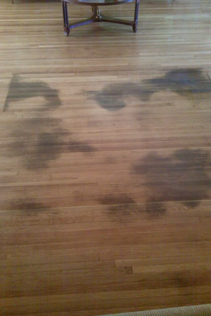

A lady calls me and says her dog has just about ruined her rug. On the phone she said it was a real expensive wool rug, but it isn't. I told her not to worry that I would make her rug clean and odor free for 140. She asked me about the wood floor and I told her it would likely need to be sanded. She asked me to clean it, and I said I could clean it with no guarantee. Then she points to her upholstery and said Stanley was out and in her words they got water all over the wood floor. She said water was everywhere. I thought they must have had a bad leaky quick connect. I don't get why people are so hung up on them anyways. They do market accordingly though. I saw a sweet F-150 with a cool tailgate that said "Heavy Traffic? Call Stanley Steemer" It had a soiled carpet with a nice clean stripe going through it. The picture sucks but I will post it.

Wow ... that is disgusting. I assume she was just used to the smell?
How did you come to the $140 for the rug - is that by square foot? We would charge $4 per sq ft for the cleaning, and then an additional $1 (at least) for the urine removal and odor treatment - though after my testing with the Odorox on a urine saturated Iranian woven wool rug, I am going to rethink my billing and create an odor removal room.

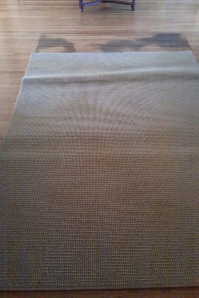

How did you come to the conclusion that its not wool. That looks an awful lot like: Karastan Woven piece.. Gingham stitch. Could you post a photo of the back?

You live in California too. It is wool, but looks like a cheap home depot rug. Some people get dupped and overpay for rugs. Wool or not is not going to change how I clean it and it should dry quick. I have another rug I have to clean with no urine damage that has a loose back so I am not going to shampoo it. Doing that just causes shampoo powder to accumulate between the backing and loose cover. I came to 140 by charging my minimum (125) plus 15 dollars to spray a disinfectant after cleaning it.

If the construction is strong, soak that puppy in acetic acid (mix white vinegar and water 50/50 for 3% acetic solution) and you can help remove that urine before you clean it.
I'm with you - whether it's wool or not - I'd clean it the same, and charge the same. We don't change the price if it is synthetic.

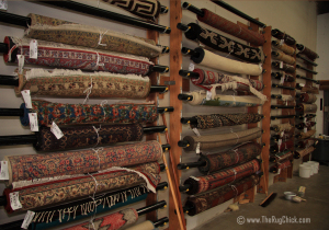

Mikey - those rugs are clean and waiting for delivery - so they are short term holding. This makes it easier for us to locate the smaller rugs without them getting crushed.
In the neighboring unit (we have 9500 square feet in our facility) rugs in storage are wrapped in Tyvek paper, photo attached to the outside, and we bill a monthly fee.

I'd really be interested in the back of the rug.. unless it has a tag on it that specifically says homedepot rug. the karastan Karalocs like Harry and I mentioned above when they are included in their custom rug program can cost upwards of 7-800 dollars and then some with size or dealer who specced the rug.
Like Lisa Mentioned, if its a hardy woven rug, you can soak it all day long with either acedic acid or we like Skunk Out and more times than not, you can remove alot of that soil/staining issues with out having to reach for the oxidizer.

That material there is between the 80- 100.00 dollar per yd. It is woven Just use caution not to be agressive . You will have excessive shedding.
