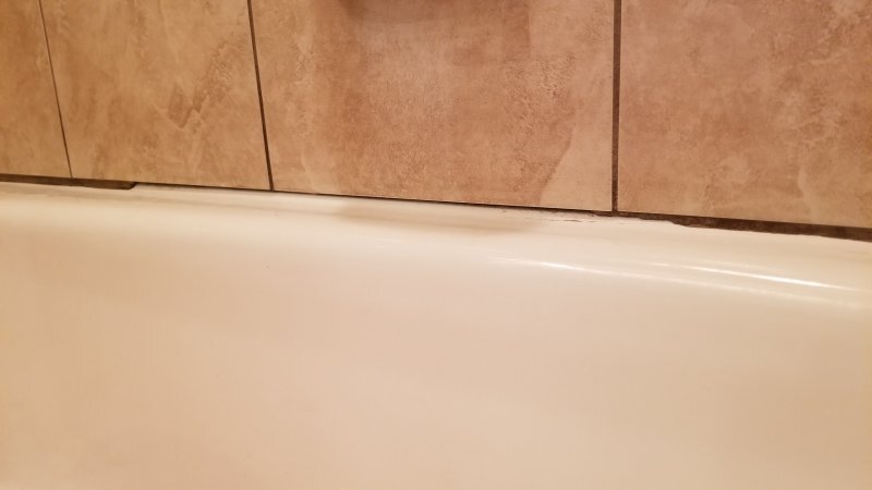

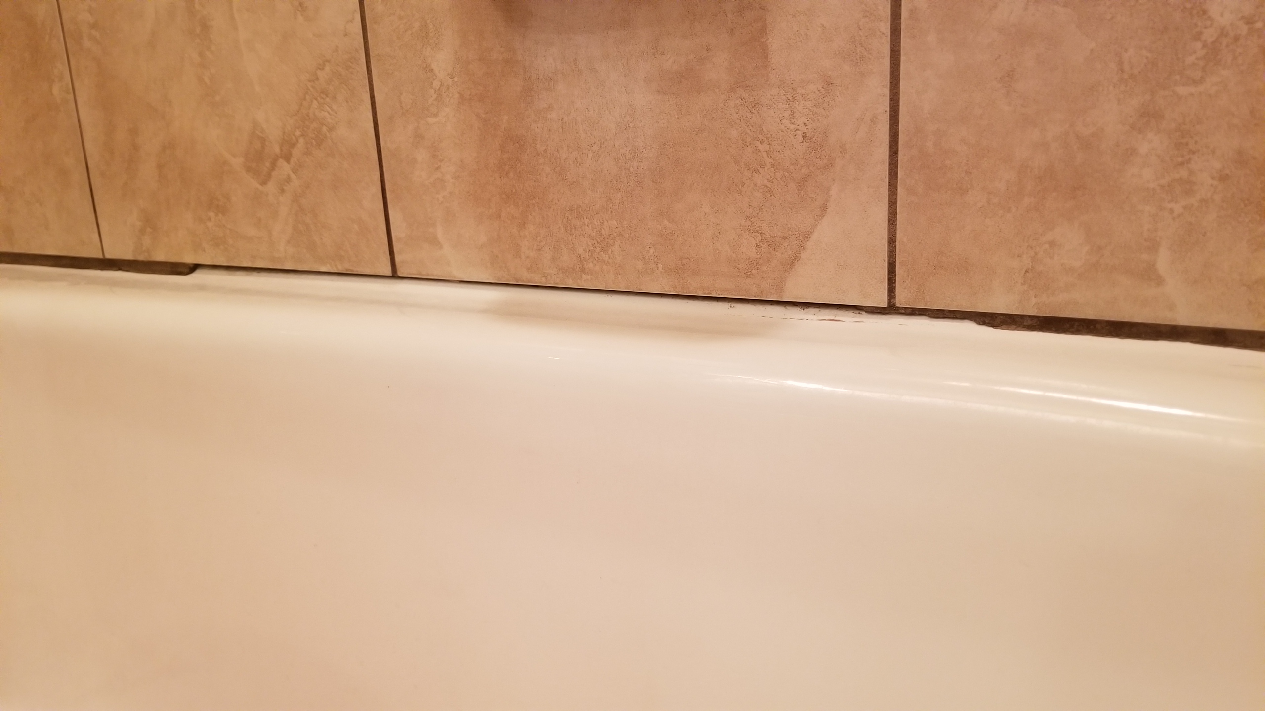

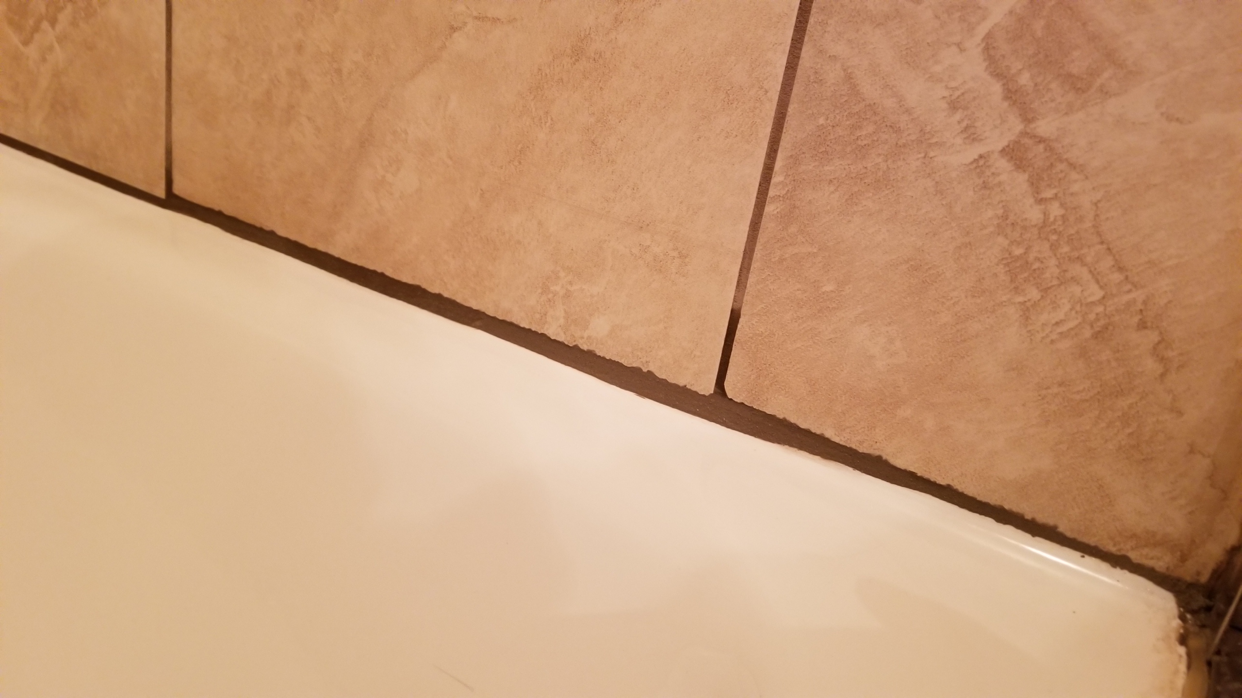

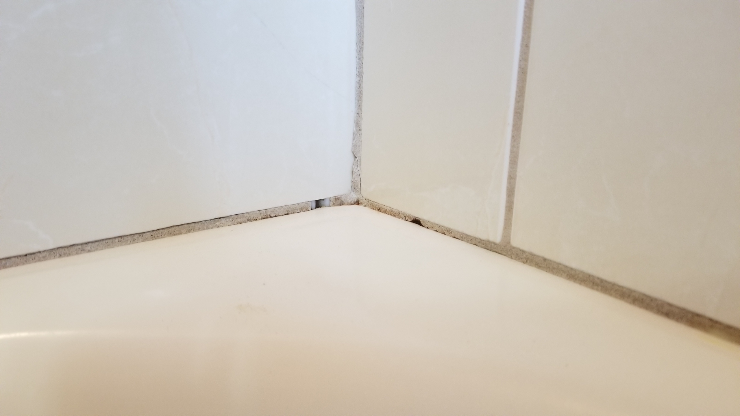

My first job with Super Grout Additive..
4 tub enclosures and a kitchen counter.
2 colors, one huge gap and all sorts of fun...
$450k home near Tahoe that looks like it was built by a 11th grade wood shop class.
112,581
Very impressed.
Super easy to work with
Over an hour of working time
Very easy to clean up
Fills/hides hairlines exceptionally
Waaaay more forgiving and formable than silicone
My floor and shower are next..
