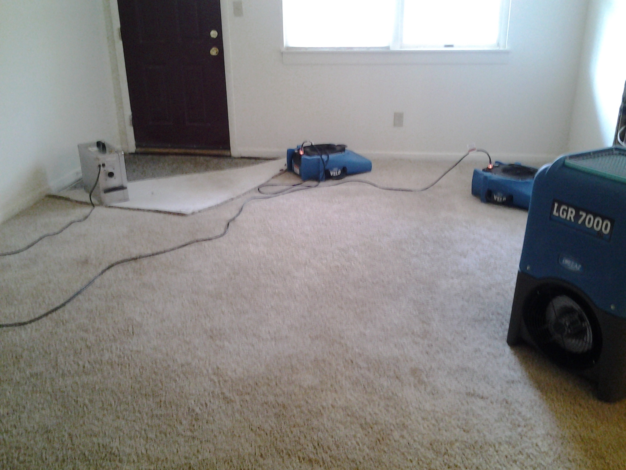

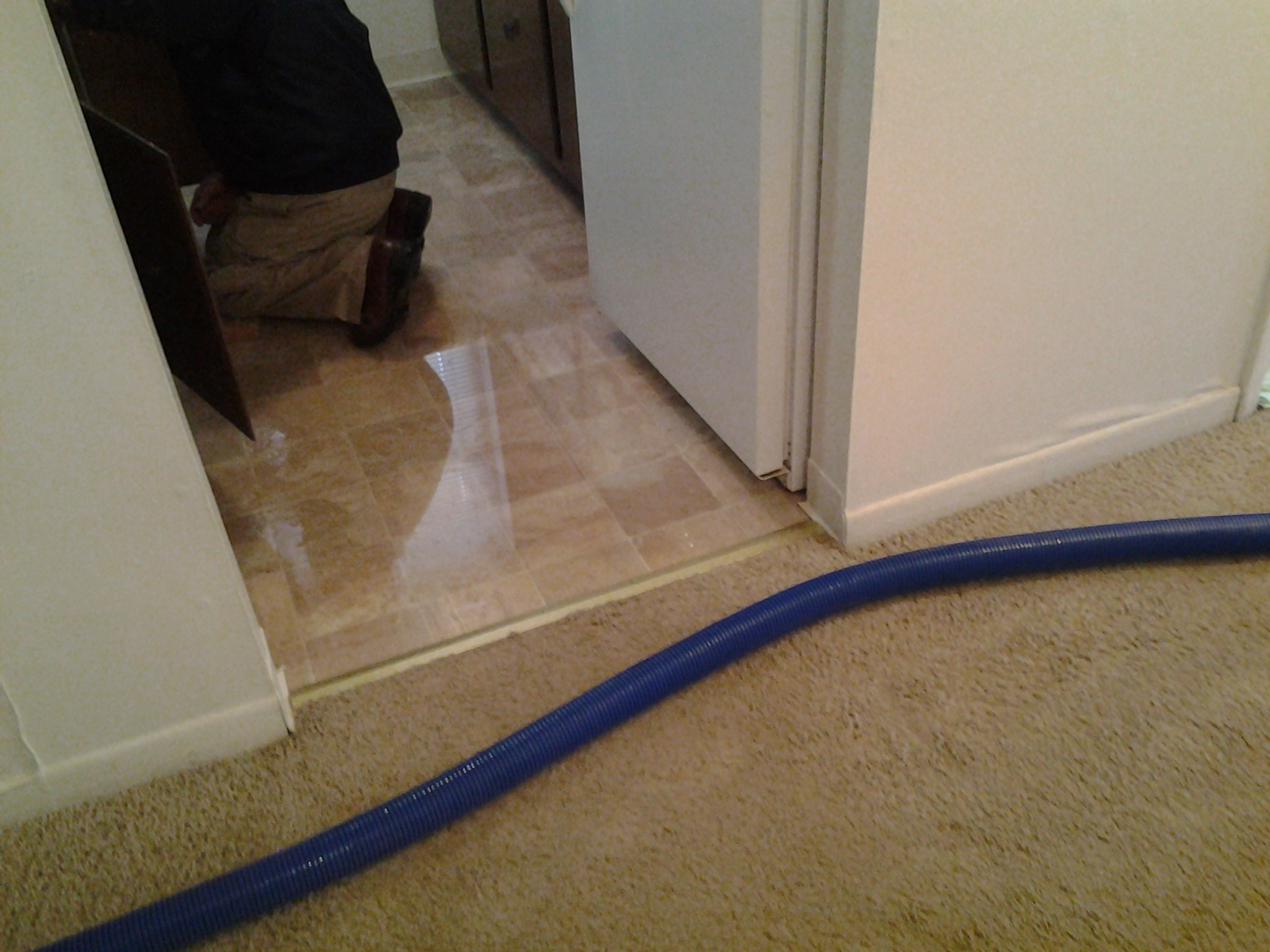

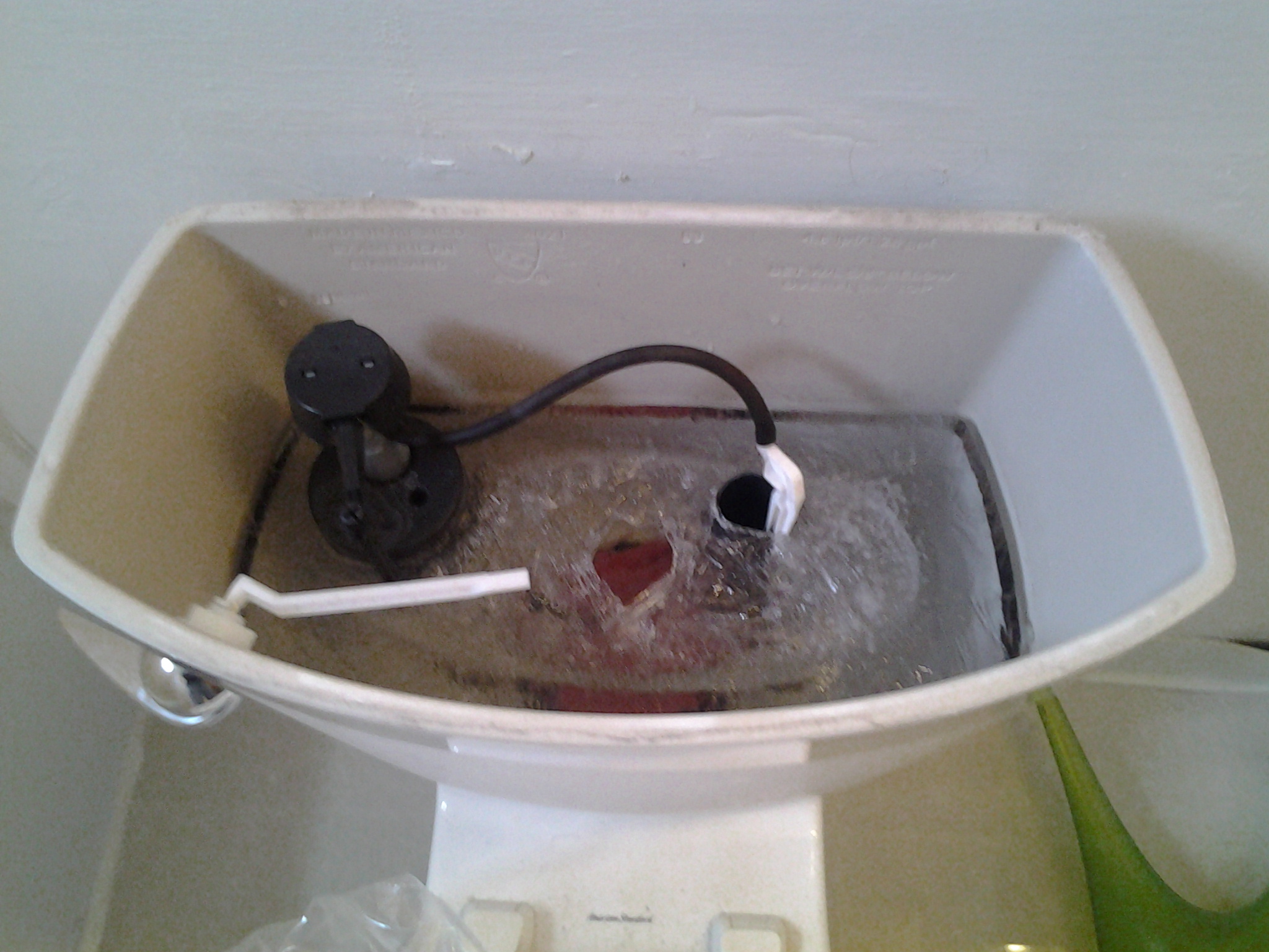

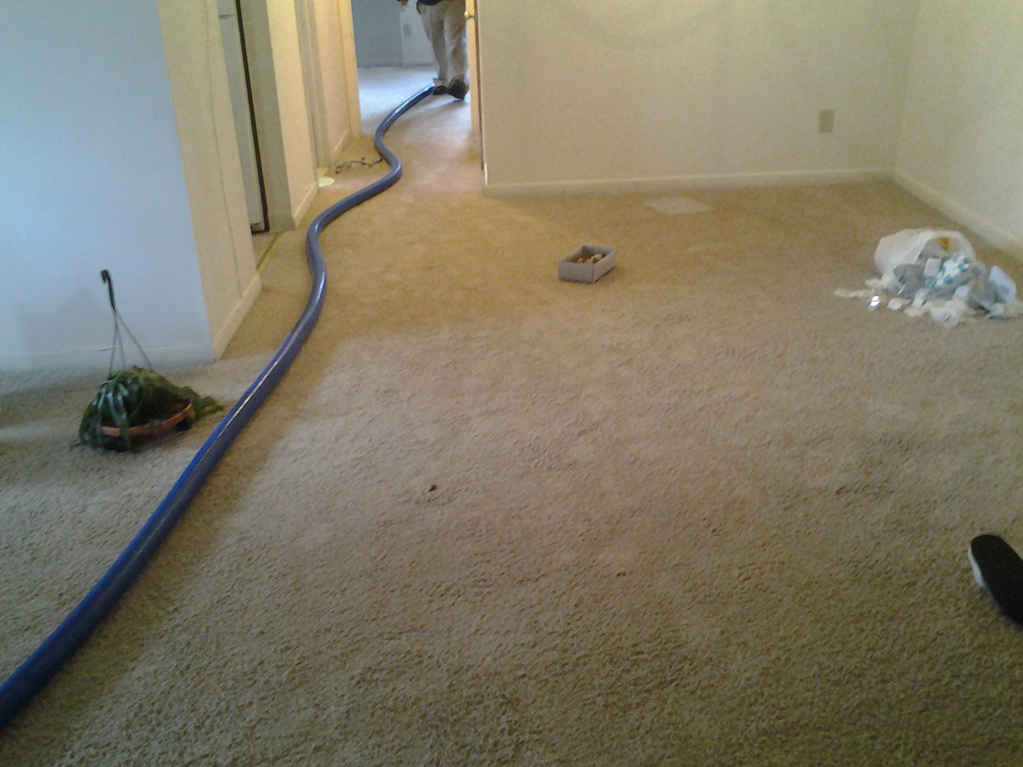

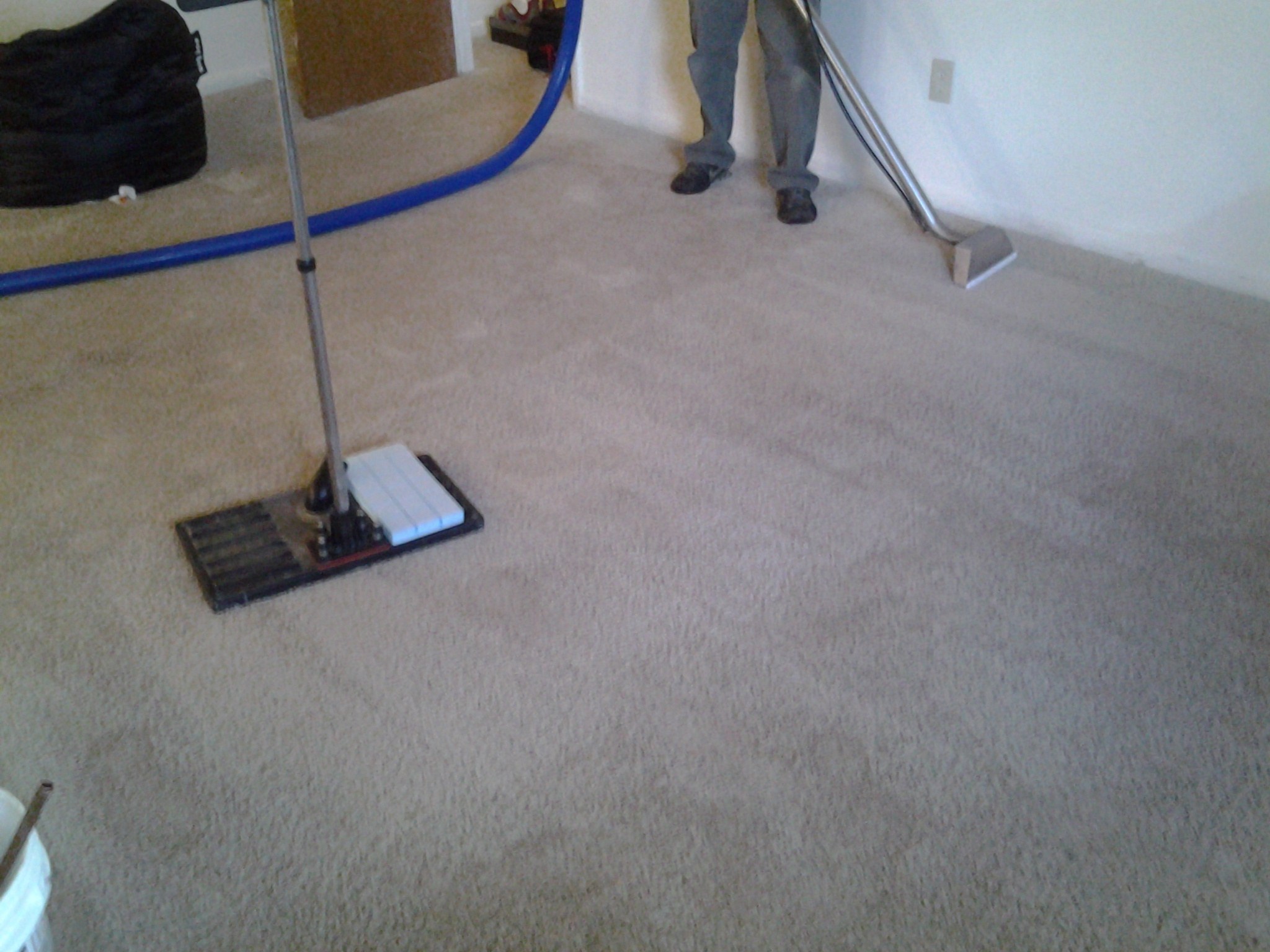

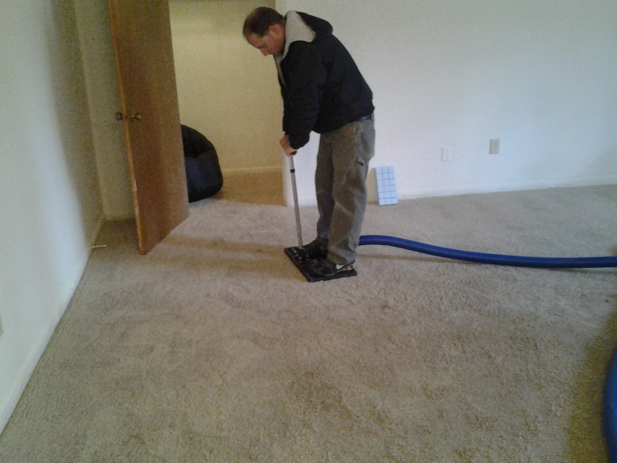

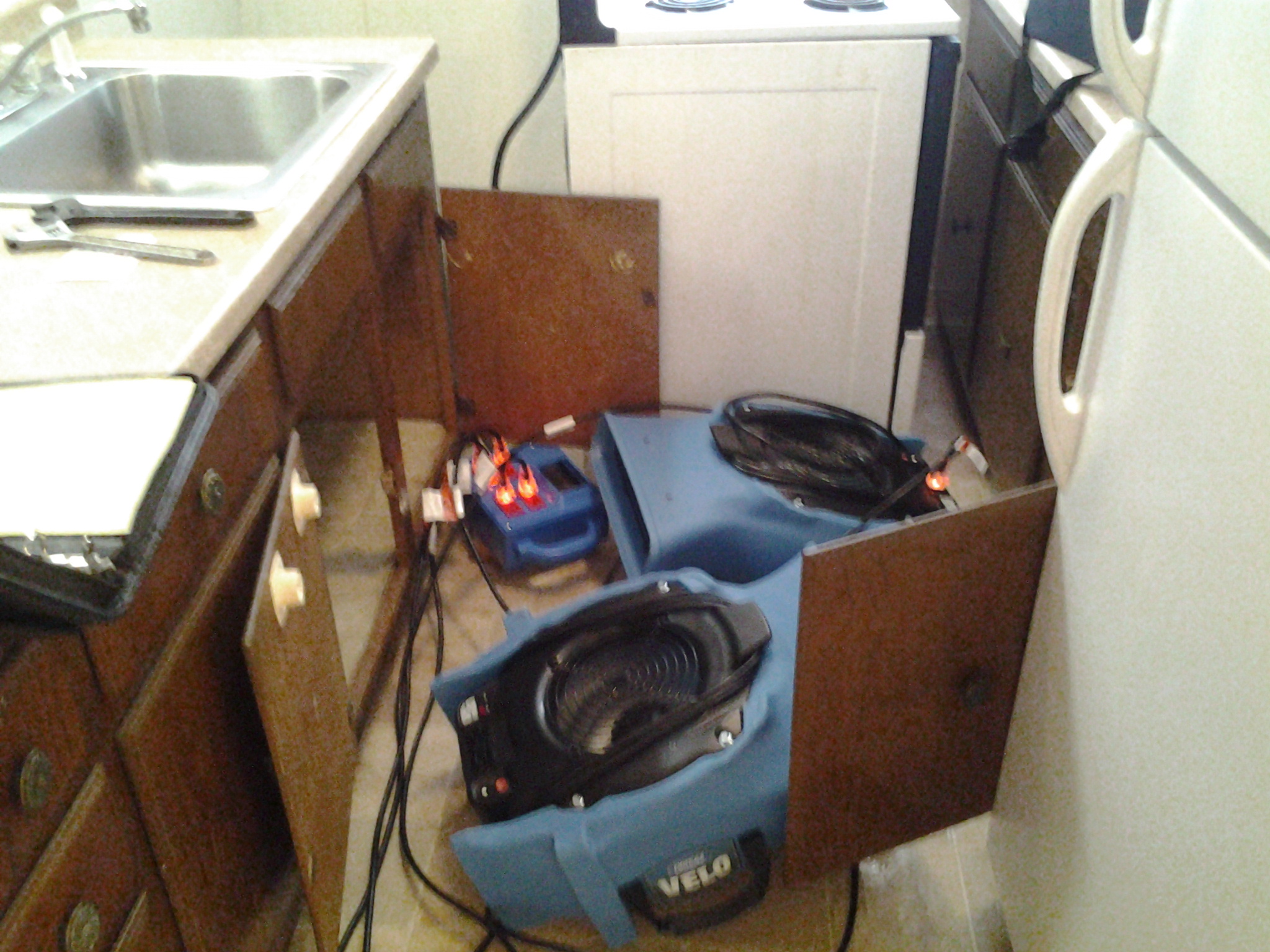

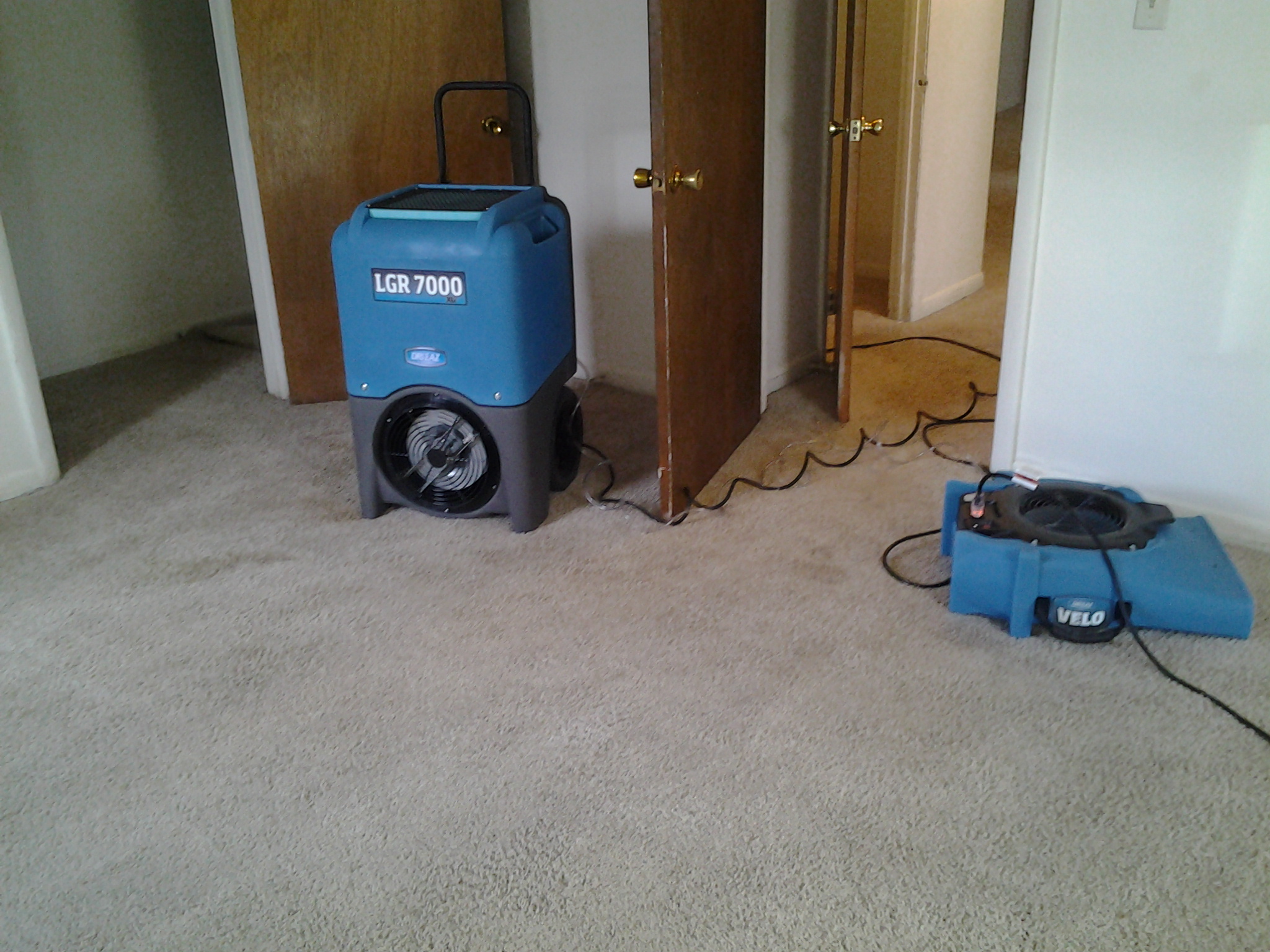

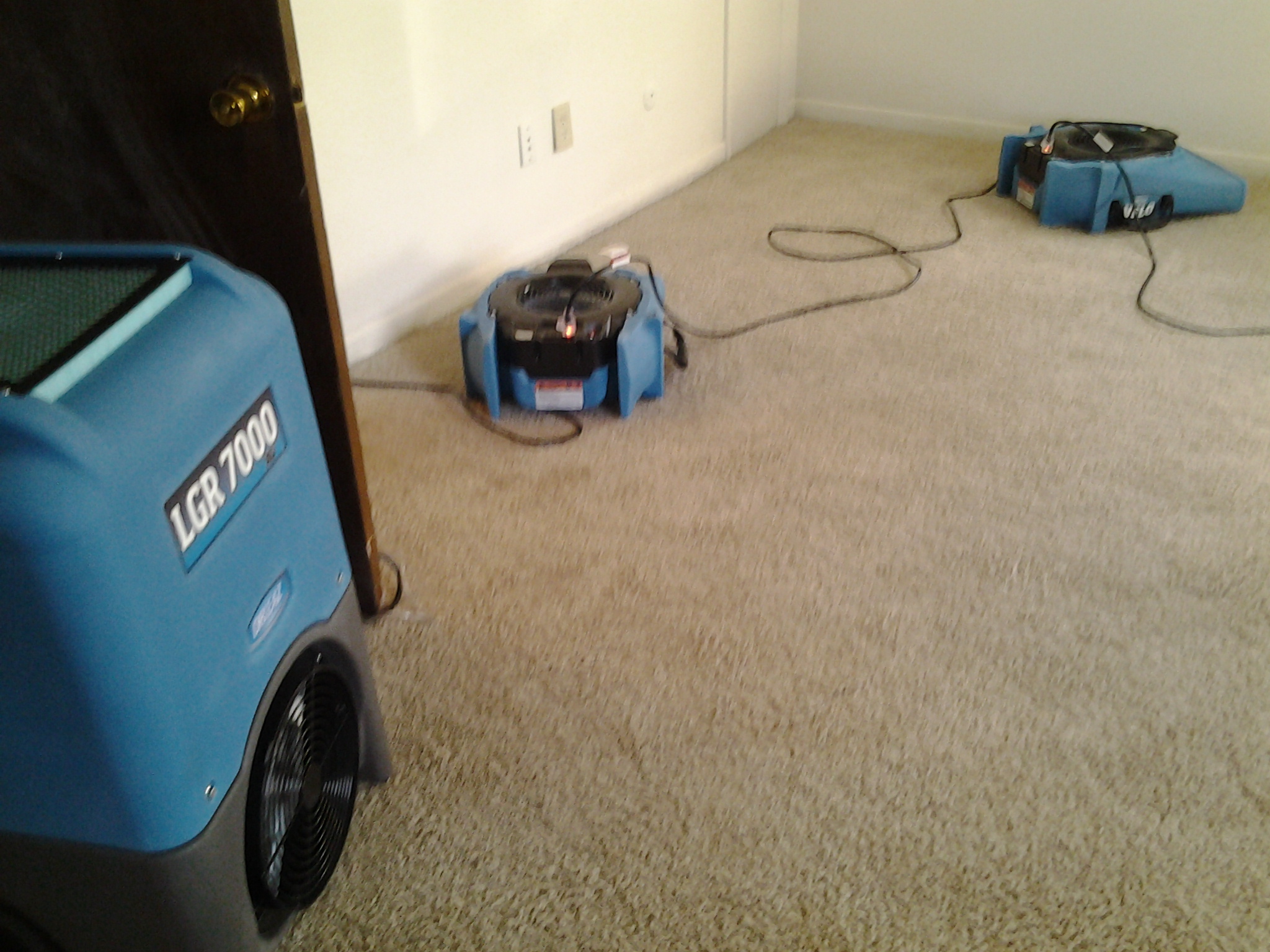

Involved a penny pincher customer who thought it would be wise to turn off the heat in 15° degree weather and go away for a few days. Wrong answer Elroy!
Here's some pics of the cleanup day one (removing Cat 1 fresh water pipe break from a 850 sf apartment). Note the ice in the toilet....
Much more work to do on this one...We be baseboard poppin.

Thanks. We have to injectidry the base cabs in the kitchen. Sorry these pics are outta order. Really we don't setup all the dehus and airmovers before we suck.

Another nice feature on the velos is you can set your amp level and daisy chain them. They have an hr meter and come with kickstands. Much nicer than the snails and lighter. Also easier access to clean.

Ok, I am impressed with all the latest and greatest equipment. I do have to ask though. Why the heck haven't you bought a rover or extreme extractor? The labor on a water claw for an area that size is insane!

No hoody that is not a crew chief, it is just a normal power distribution box called a g unit.
I like the velo pros not the regular Velos. They stack (both versions) well and they are really lite and make carrying them long distances or up stair a bit easier.

I hear you Greg they are nice and I have already spent time researching them. I'm hoping to get one down the road butI will only get it if I can pay for it in cash. Not quite there yet.

Actually the customer requested the vapor shark. We turn approximately 1000 units for them and they pay us direct for floods rather than reporting to their insurance and their premiums going up each year. We exposed them to the vapor shark several years ago, they like it for the quick odor knockdown and to reduce the psychological odor phenomenom some people have.
This job was dried in 3.5 days, no odors, customer was happy. One comment was to tear out the carpet but it was 1 year old and for this paricular case they wanted it dried and saved. Many times though we take it out if its as old as abe lincoln!
Mark, that power dist box is a g series and we really like it for its compactness.
