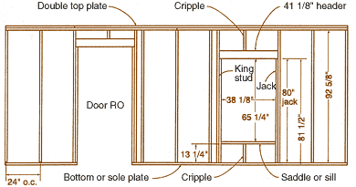

Note both terms in this image and what they apply to:

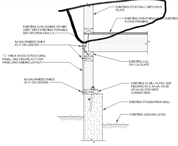

Fred that's not even wall framing...that's part of the foundation...long way to go until your ready to start framing your wall...:headbang:

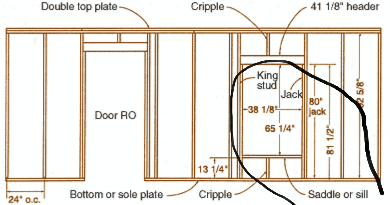

let me try this one last time:
.a sill plate is the bottom of a widow ( term. window sill)...:icon_rolleyes:
https://en.wikipedia.org/wiki/Sill_plate
a window sill and a sill plate are two entirely different things
Happy BD!
but to be honest I DO call base plates or sole plates ...sill plates......and will continue to do so whether technically correct or not

I think it's a regional thing. Around here, where most of the construction is slab-on-grade, the member that sits on the slab and supports the wall studs is simply the bottom plate or sole plate. In homes that have a foundation wall and crawl space, the wood that sits directly on the foundation wall is the sill plate. The wall studs do not connect directly to it (as shown in Fred's diagram posted above). But that's just this area - YMMV!

Even though I call them sill plates (when they are like in the pic)...............I think my point was entirely missed.....................a sill plate is NOT part of a window framing as stated earlier
