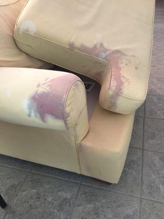

Today, 'Fine Fabric Specialists' often receive pictures via text with messages like this:
"We have this cushion with a large wine stain. We put salt on the stain. Can you clean it, and how much will it cost?"
"HAS A CUSTOMER EVER SENT YOU A PICTURE LIKE THIS?"

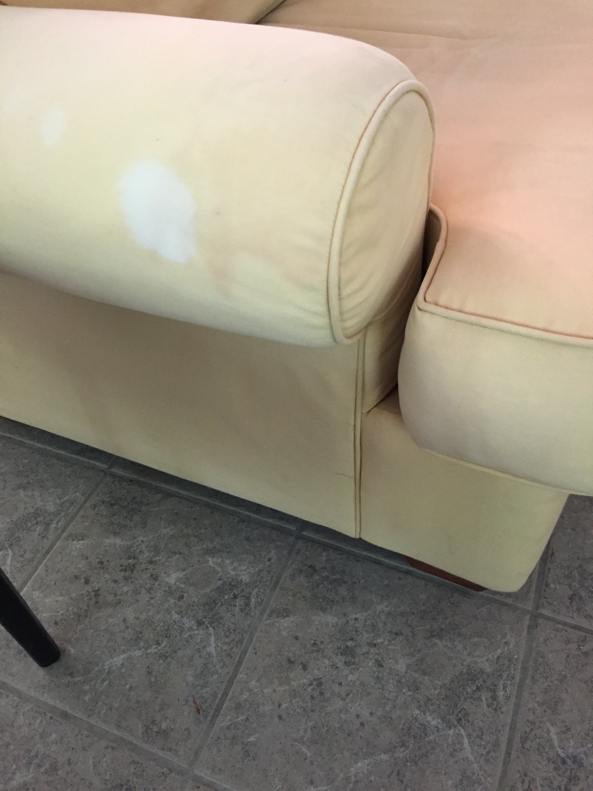

On the original picture above: The areas where there is color loss, is because of an attempt to remove a red40 dye several months prior to the red wine stain you see here.
So, instead of the dangerous way of what was attempted...how would you attack an artificial red40 on natural fiber pictured above?

Red Dye 40 releases more readily from natural fiber fabrics than it does from nylon. I have had success with a red dye remover applied without heat, but given time to work instead. Try about an hour of dwell time while you do a few other things. Then if the stain remains, use a steamer instead of an iron. However, always have a clear understanding with your customer before you use any dye removers on upholstery fabric.

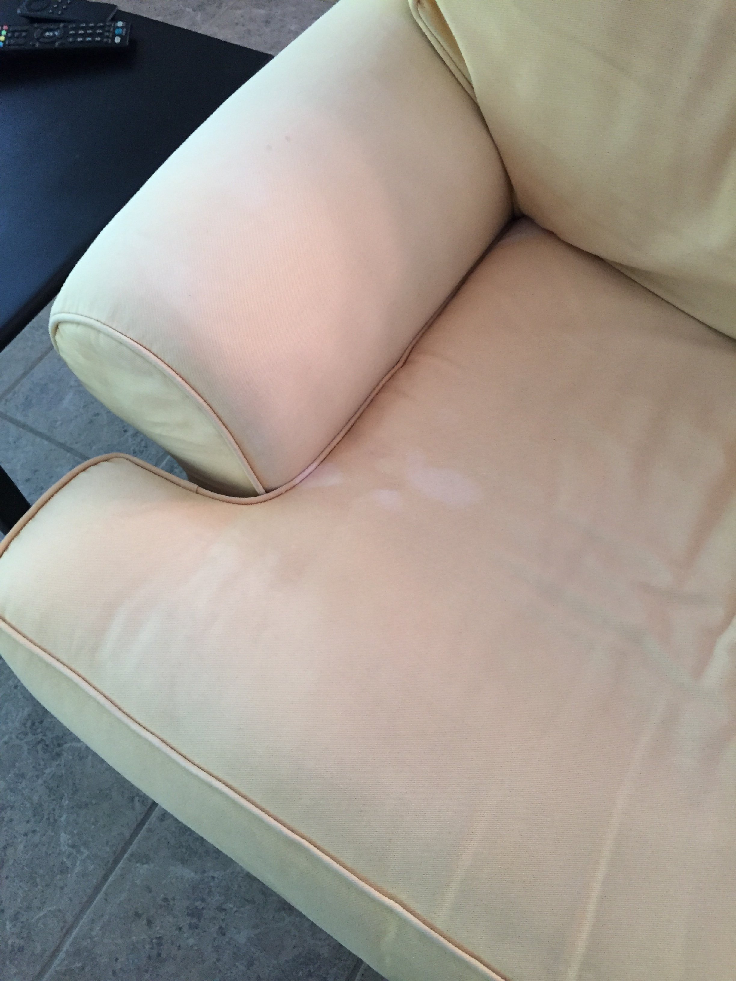

On that chair above, I had it on her porch out in the sun and she treated it one more time with 3% after it dried, and it came out nice
Reactions: Jim Pemberton
MLPW
13,160
Georgia
lets see the after pics.
“Just 1 more time inside. I'm satisfied with it. It's a big improvement and will get me by until I make a decision about what to do next. Thanks, Matt. “
That was her response to me
I give all the credit to @Jim Pemberton on this job because I spoke to him for about an hour before I went there to do it

Thank you Matt, and thanks for letting me use your pictures to educate others. In the end, you were the one who made it work. Procedures and products work "on paper", but the only way they work in real life is with someone who has skill, and that one thing no one can buy:
