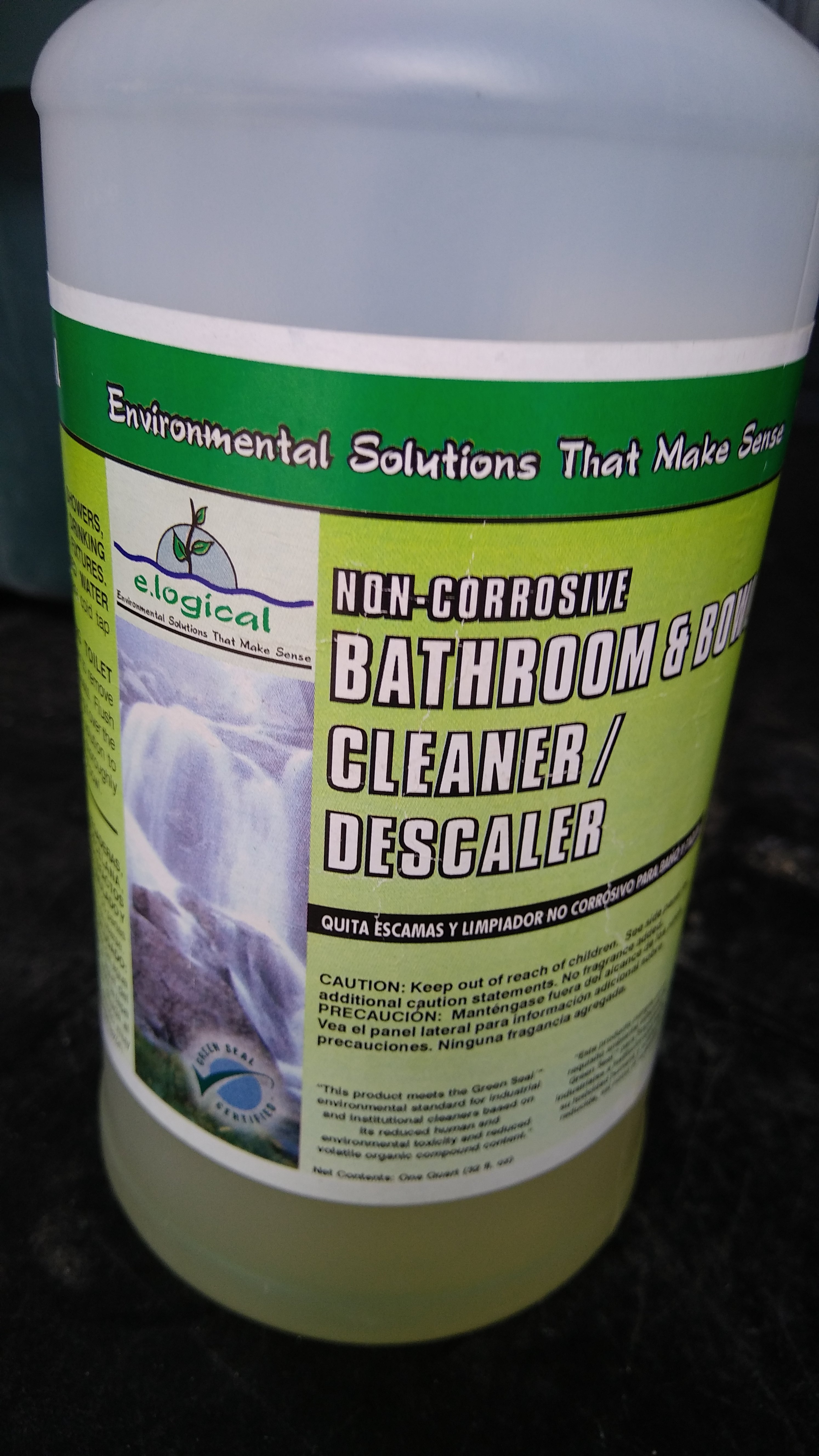

This is a new product we are trying and it looks like it will be replacing 3 other products we use. So far the stuff is very impressive.
