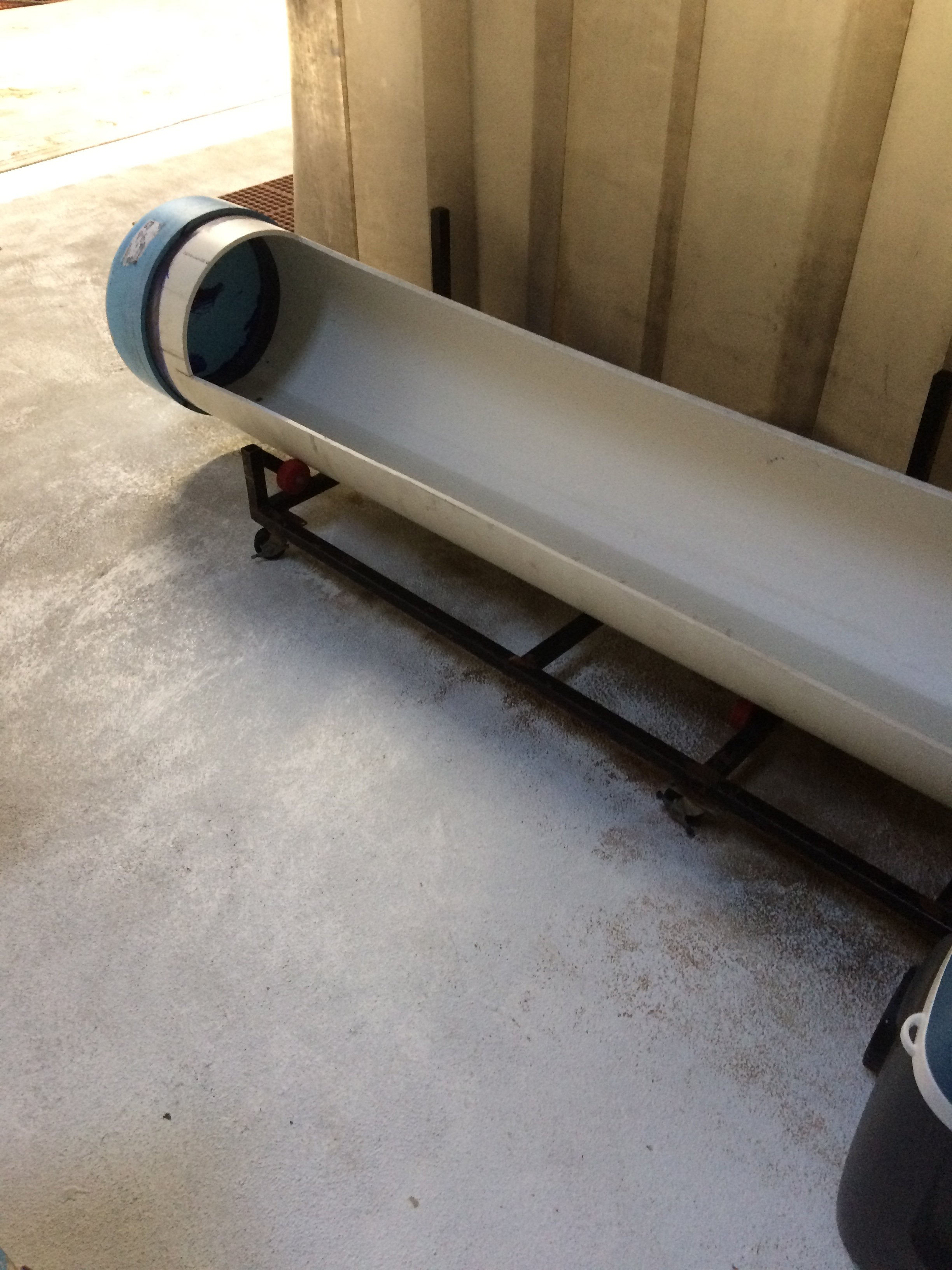

I’ve got another project in the works right now. The rug pit takes up WAY to much space in my shop. When I’ve got rugs that need to sit in solution overnight, I’m building this...and using this concrete vibrator to agitate...
Reactions: Hack Attack

For flushing out urine and saving space, you should look at Joe Robert's Marinator. I was impressed when I saw it in action last week.
