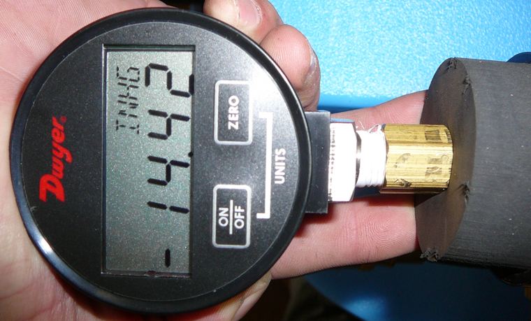

We have testing graphs from both of the large vac motor manufacturers for our industry.
We also have done testing on wet carpet with 25' 1.5" vac hose and 12" CMP wand,
with 1% digital gauge for lift at the vacuum-carpet interface for: VacGauge.jpg
1. Dual 3-stage vacs in parallel http://www.cobbcarpet.com/zen/index.php?main_page=product_info&cPath=86&products_id=4725
2. Dual 3-stage vacs in series http://www.cobbcarpet.com/zen/index.php?main_page=product_info&cPath=86&products_id=4725
3. Four 2-stage (series/parallel) 250 air watt vac motors
4. Dual 6.6" Lamb vacs in series http://www.cobbcarpet.com/zen/index.php?main_page=product_info&cPath=86&products_id=5085
The Dual 6.6" extractor has the most airflow, airwatts, & performed the best in our testing on the wet carpet.
