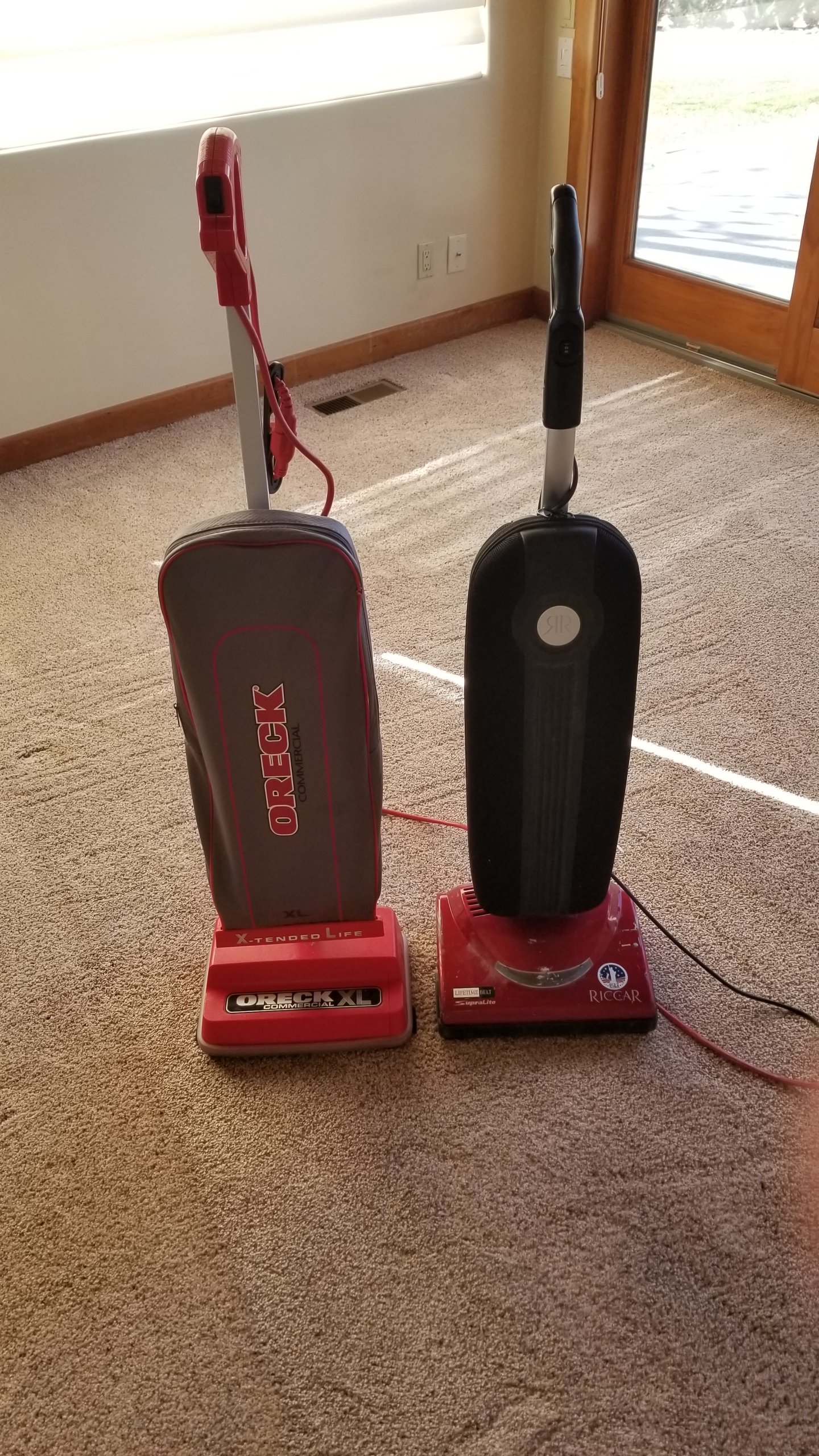

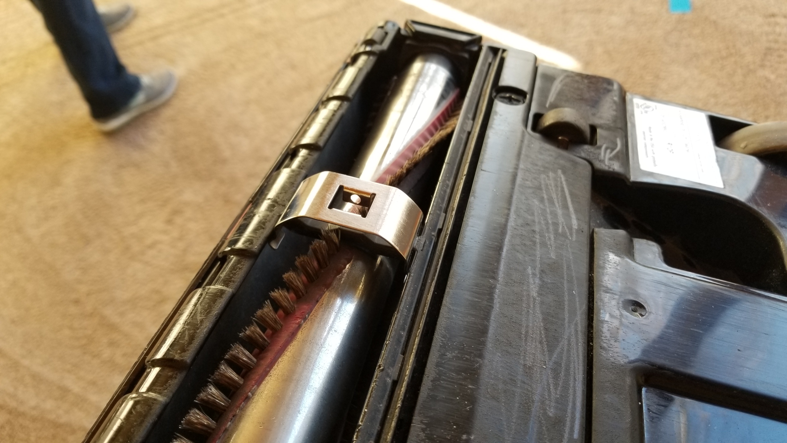

New customer today had a nice think 4 yo Smart Strand, she returned 3 WallyMart vacuums before she special ordered this Riccar Oreck knock off. IT too was un push-able until they sent her that metal bridge to lift the head out of the pile a bit. I tried it and was shocked at how hard it still was to maneuver.
I told her I'd have to go get my Kirby w/ it's adjustable pile setting, fully suspecting that my Oreck would be the same.
Low and behold it wasn't too difficult, which surprised me as many thick piles can be a bitch to push it.
Their $6.00 bag was beyond full too.
After trying the Oreck I think she's going to get one.
What are you all finding that is usable on these new ultra soft piles?

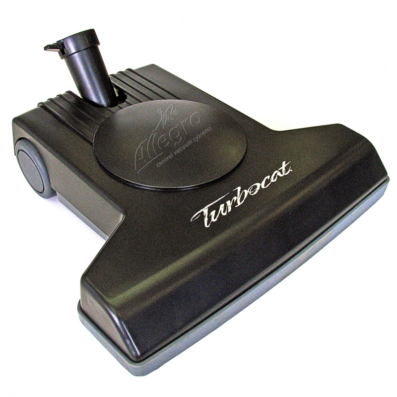

The most HEPA vacuum you can buy when used with a truckmount. Turbocat model TP210.
No problem with any kind of carpet, but a vac relief is mandatory to keep from over-spinning it and melting the bearing housings. Will last longer than most small electric vacuums, costs around $125 with tubing, takes up very little room in the truck.

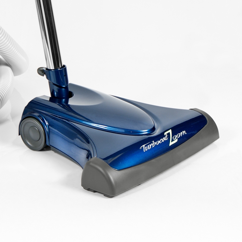

PS: Do not buy this model! It will Zoom into the garbage.
