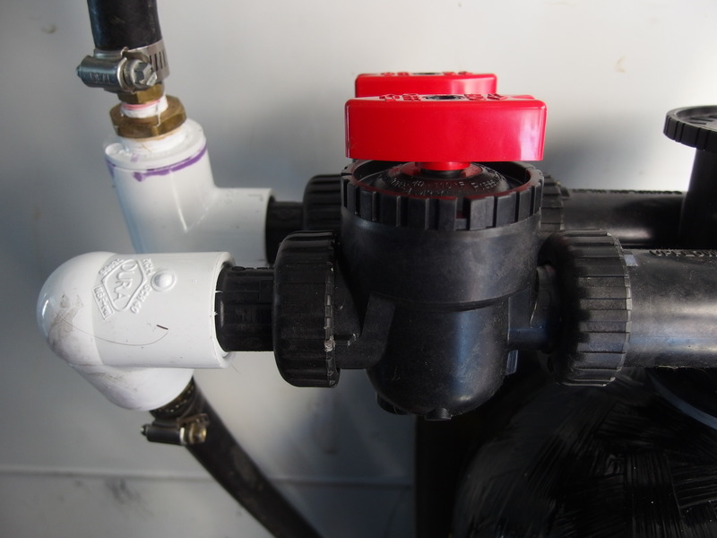

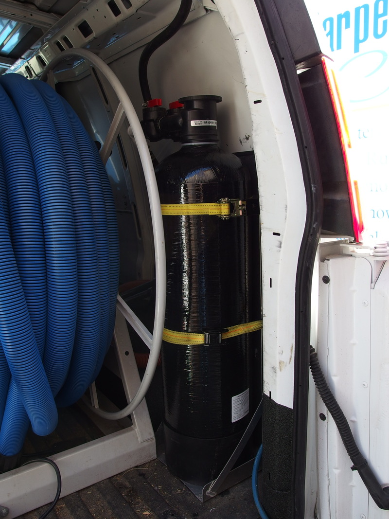

I've got a big blue one in my Cleanco. Ive never serviced it or any other water softener. Pretty sure it's doing nothing for me right now. I want to do a proper descale and recharge soon to get ready for Spring.
I thought I remembered Jim or someone saying we should reverse the water flow through the softener for @ 15 minutes, then fill with salt???
Is it just the crystals I get for our home softener?

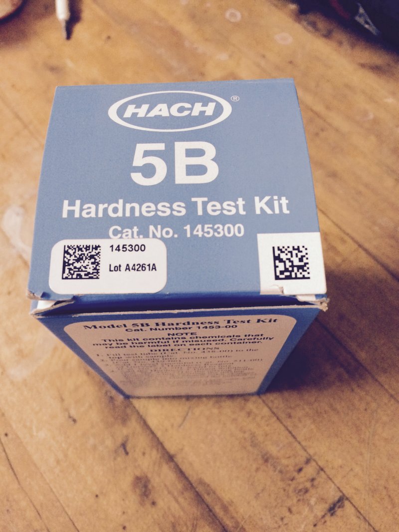

some say reverse. Some say normal. To me your getting it refined either way. Use a water hardness test kit to check.

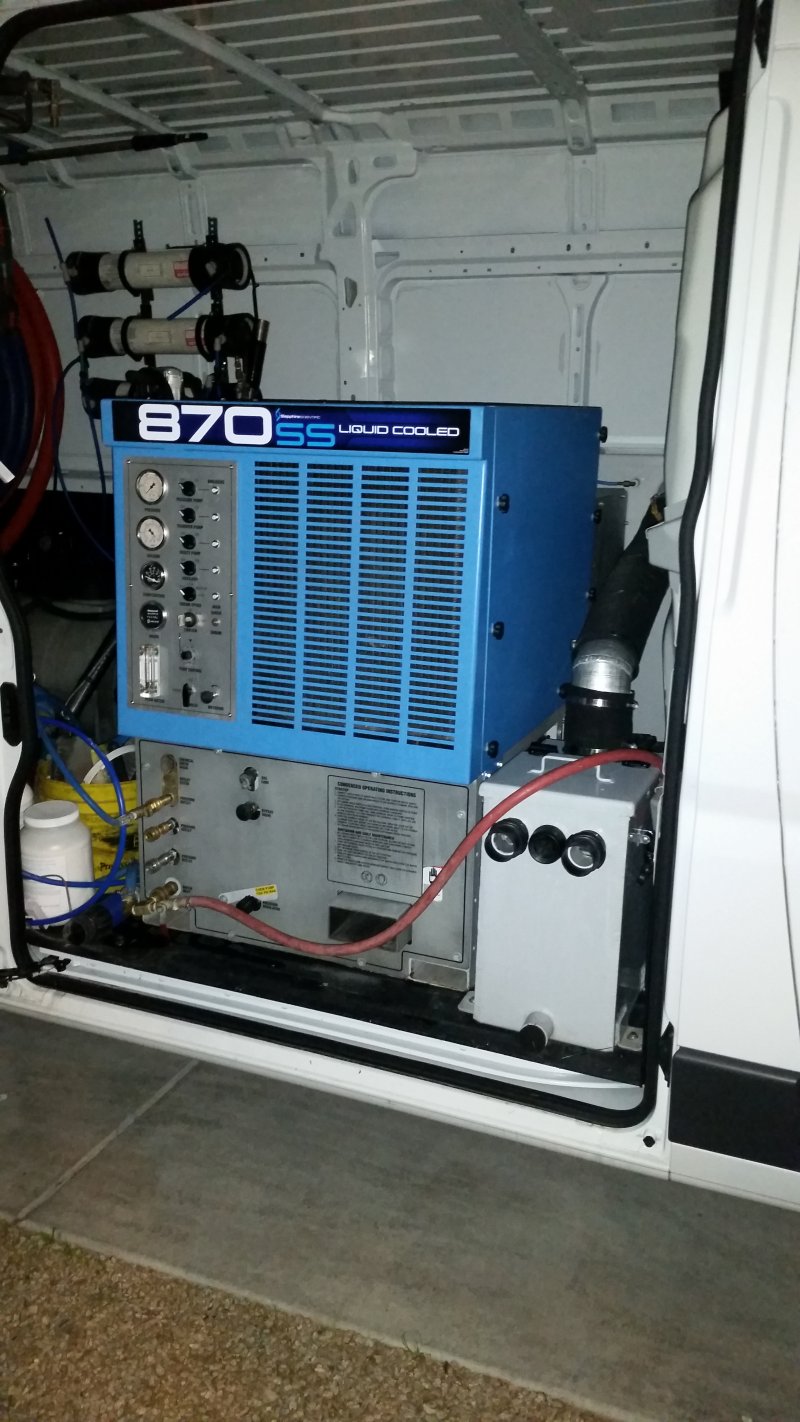

Did the 870 come originally with the separate filter box. They changed that to the filter inside the waste tank. That's similar to my thermal wave. Makes more sense. I'll be keeping my old filter box.
Gene
Jim Martin
Arizona
Jim Martin
I would like to get one of those filter boxes for my 570...
I like the one that is on my thermal wave bether then adding a in line filter.....

Hey, I was bragging about my awesome RO/DI setup...
What the...
I asked for this, specific from Thom... I love it tho... No filter in the waste tank...
...still a hack in some ways.
you should reverse it every other time i think the paper said....mixes the resin beads back up, other wise the water just creates channels and doesnt run over any thing to soften it...
anad yea just regular old softener salt

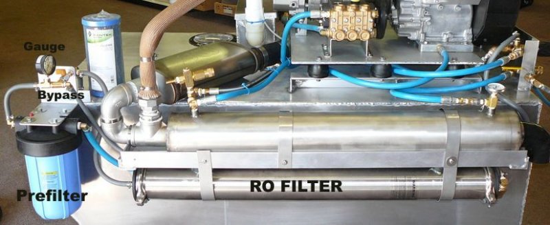

I have all the RO parts, as does Lance.
RO water is a much better system, but requires more to install.
Our RO TM customers say they rinse more completely with less wand strokes.
Also good to counter Electrolysed water advertising.
Photo of our RO system:
