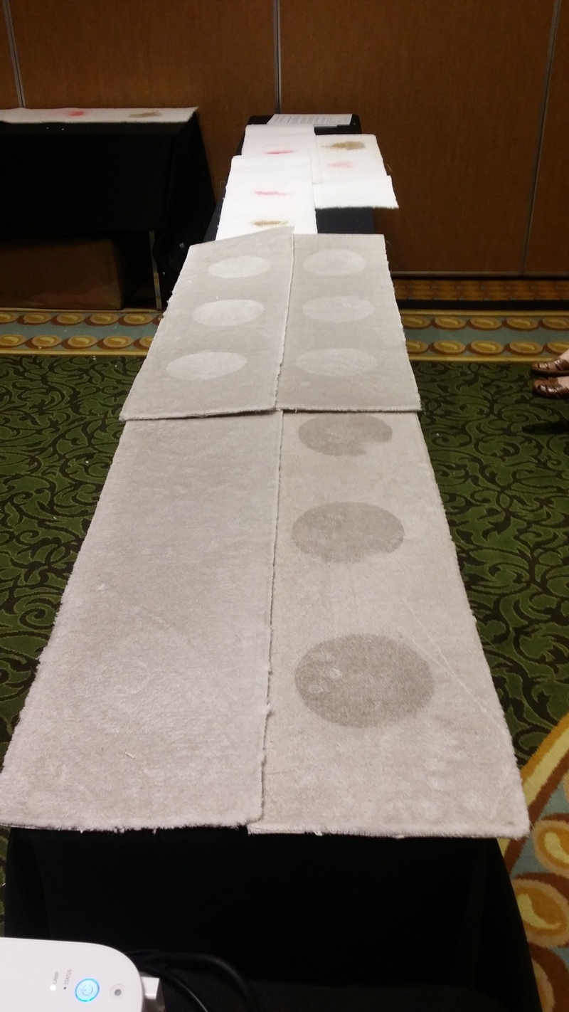

What ever happened to the results from the carpet protector challenge at The Experience?
12,059
Coming soon. I'm making sure all parties involved are fairly treated and represented in what's shared.
No clear winner indeed. But everyone has something to be proud of, in my opinion.

First, I think we'll start a new thread about this, but as a "teaser"
Just as there is no truck mount right for everyone, or prespray right for everyone, these tests show that there are trade offs depending on what you want.
Without giving anything away (yet), you can ask yourself:
How important is dry soil resistance versus spill resistance?
How important is it for the product to bead up?
How important is acid dye resistance?
How important is it to be water based versus solvent based?
There is no one product that does all of that equally. I would be comfortable applying any of them with the understanding of the strengths of each.

In the first portion of the presentation, I covered the various expectations of a good protector as well as the different types of products sold as protectors.
Compiled from various sources and surveys
What do carpet cleaners think is most important function of a carpet protector?
Dry soil resistance. they understand that dry soils abrades carpet fibers, damages the appearance and thus shortens the useful life of the carpet.
What do potential purchasers of protector think about when protectors are offered?
Children spilling colored beverages such as Kool Aid and will the protector prevent that from staining. Secondly animal urine.
What did carpet owners report as their major concerns about carpet?
#1 Traffic lanes #2 Tracked in soil #3 Stains How do protectors effect each of these issues?
What do carpet cleaners say is most helpful marketing tool when selling protector?
Demonstration of beading
All of these factors might influence what protector you choose for a given situation. Also might be considering cost, coverage, health and safety issues, the type of fiber or fabric the protector is being applied to. In one case, we saw that what worked well on upholstery was not suitable for carpet.

That wasn't tested Lisa, because the variables in soil and wear are too difficult to duplicate when you are trying to compare three types of products. I will tell you from other tests I've done that residual detergent is worse than residual soil and wear, but all three are a factor.
This is where each person has to test the product that they settle upon in more "real world" environments. I have a few rental properties with the typical people who rent such places.
These are ideal testing places for me.
Bottom line: The older and more beat the carpet (and more residue of "stuff" in it) the less effective protectors are, which of course is what Lisa just said.
These tests done for comparison sake will not be helpful for that testing criteria though.
